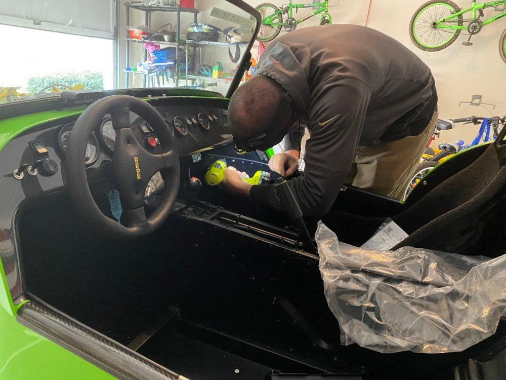

Seventh big build category: interior. This part has been fun. I ordered full carpets and have installed carpets on the tunnel, below the seats, and behind the seats. Carpet tape instead of spray adhesive was a good call (per advice of Josh Robbins with Rocky Mountain Caterham). Tunnel top fits as you would expect. Same with the gear shifter. I expected the knee plates to be hard. But they were not bad at all. I punched holes in the rubber, inserted the knee plates with a little firm pushing and bending, drilled as indicated in the manual (the holes on the knee plates don't line up at all as delivered), and screwed/riveted per the Ikea manual. I may have gotten lucky. The 12v lighter attaches to a wire in the passenger side, but there is still a stray wire that does not seem to attach to anything. I'll add it to my list of questions for Josh. There seem to be several of these orphaned wires. The one trick is for those with lowered floors and an adjustable driver's seat. You must bend the L shaped adjuster down before installation. Otherwise, the cross member will not allow you to move the seat backwards and forwards. Another question for the group: are the S3 tillets the same size as the SV tillets? I ask because mine seem very tight and the packaging label identifies them as S3.

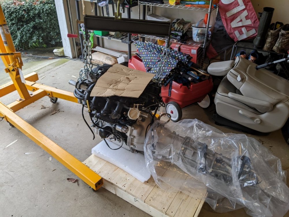

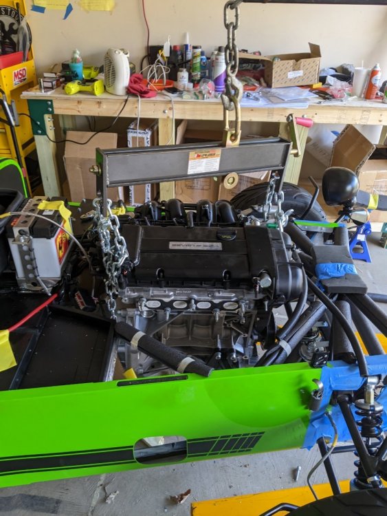

Fifth big build category: bulk of the drivetrain. In retrospect, this part of the build was the most fun and rewarding. In the moment, it seemed like a massive undertaking. My general advice to other newbies: it sounds like a broken record, but visualize and plan what you are going to do and then take your time. It will fit! The biggest issue was removal of the starter motor for the bell housing / transmission mating. There is one bolt that seems impossible to remove. You'll know which one. I finally removed it after buying several socket extensions and taking a LOT of time. Of course, reinstalling the starter motor took about 5 minutes! I sprayed waterproofing in the bottom parts of the interior body and other crevices. I read that these can trap water and cause premature rust. I intend to (essentially) daily drive the car, so I figured this would not hurt. You will see below that I had lots of "help." Really, just one friend to help manhandle the engine/transmission. More specific advice largely echoes the blogs: - buy or rent a load leveler to go along with the engine lift - keep the plastic on the transmission (thin, easy to remove, and protective of transmission tunnel walls) - keep a very steep angle until the transmission is just in the tunnel, then level it out and keep the transmission high - I thankfully did not have any issues with lining up engine mounts or rubbers, but be sure to keep them loose at first to give yourself room to mate them to the engine block - I did not remove anything from the engine block except the tensioner and belt; I did not like the idea of re-installing the starter, alternator, or anything else in the cramped engine bay - take lots of pictures before disassembling anything: it is much easier to reassemble

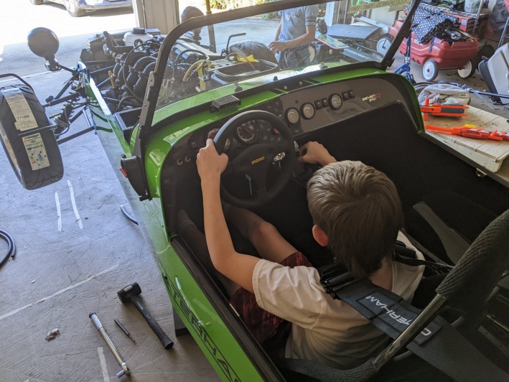

Second big build category: shoulder harnesses, rollover bar, handbrake, and heater. Shoulder harness and rollover bar came at the advice of several blogs. The suggestion is to install the shoulder harnesses before the rollover bar and the rollover bar before the rear dampers. This is where the manual puts you in the wrong order if followed page by page. The shoulder harness came with cardboard washers. I installed them and then read suggestions that the cardboard washers are not needed. Too late now, and I would not imagine it matters much either way. The rollover bar took a little persuasion by my new best friend: the BFH (big f***ing hammer). But my youngest was able to help with a few of the bolts. Handbrake was more difficult. Access is very tight, and I got frustrated. But it eventually went in and is ready for the differential installation.

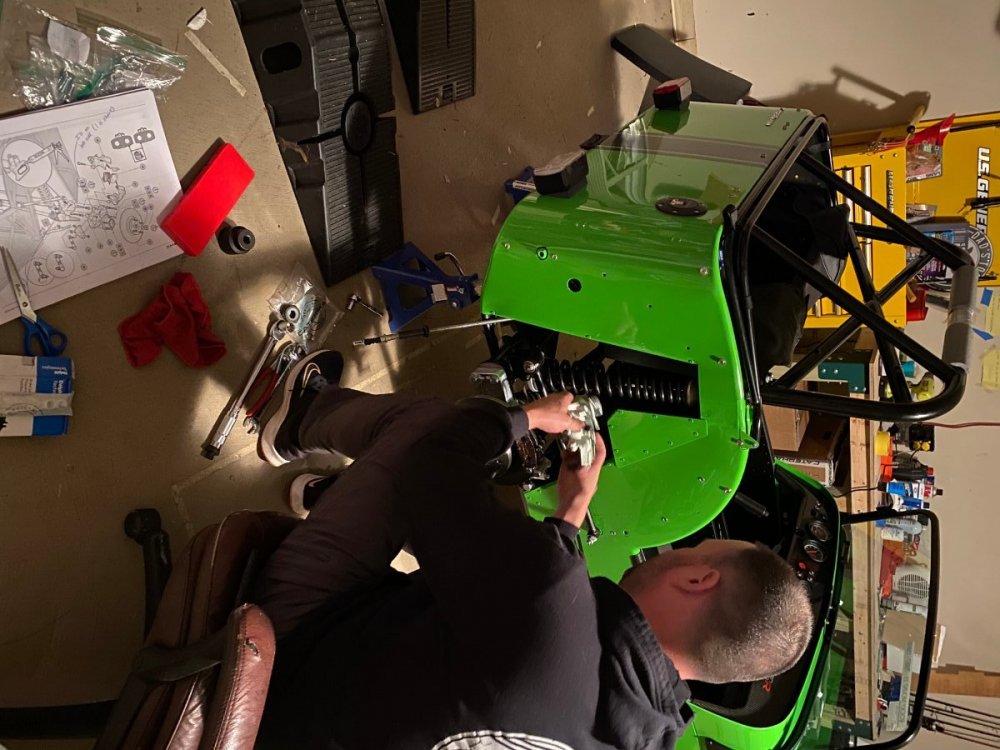

First big build category: uprights and lights. Once i figured out how to put upward pressure/load on the suspension, the uprights went in without too much trouble. But I did take my time given that I have no clue (call it 8 hours). I need to go back and swap out the brake line washers for the ones that various blogs recommend (copper ones if I recall correctly). Lights were relatively easy thanks to Daniel French's blog: http://www.caterhamr500.co.uk/2014/02/build-day-four-headlight-and-indicator.html?m=1.

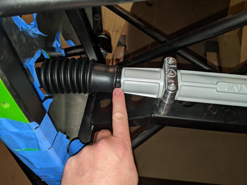

One stupid question already: the steering rack has zip ties as shown in the pic below. Do these stay or come out?

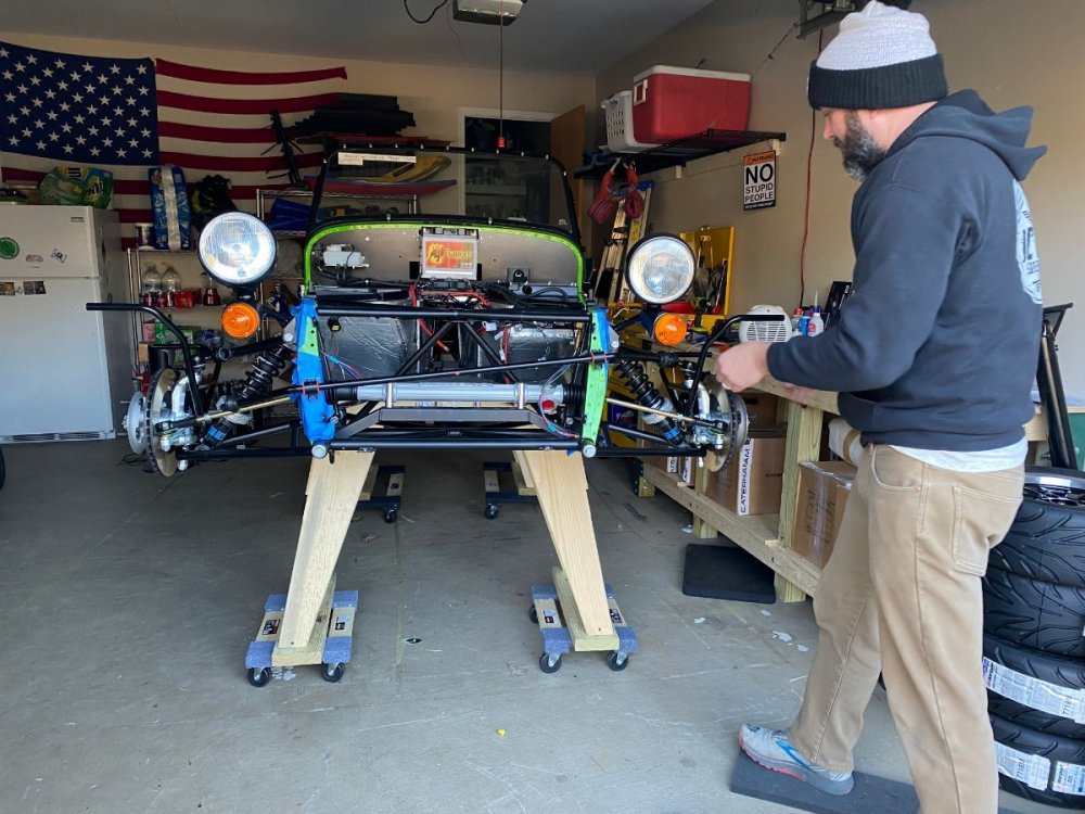

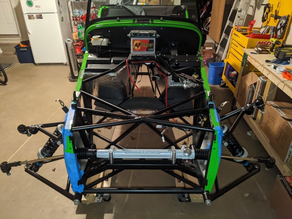

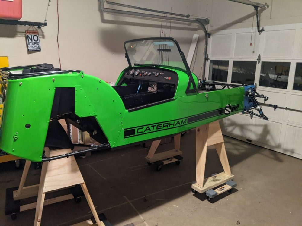

After a long wait ($&#! COVID and supply chain issues), I now have my 310R SV kit as of Thursday. Thanks to Josh with Rocky Mountain Caterham for his great help so far. I have limited mechanical skills, so this build may be a good push for those on the fence to assemble their own (assuming all goes relatively well). I have made good progress so far between kids' basketball games and piano recitals. Built a unique looking stand per the advice of Josh's father (Ross Robbins, thank you), wishbones (upper wishbone washers were as frustrating as advertised), dampers, and steering rack are in. Next up are wingstays, front brakes, and front lights. Hope to accomplish all of those this week before a 1 week break for Radford driving school in Arizona with friends/clients! I look forward to any advice, critical eyes, and help you can offer.
