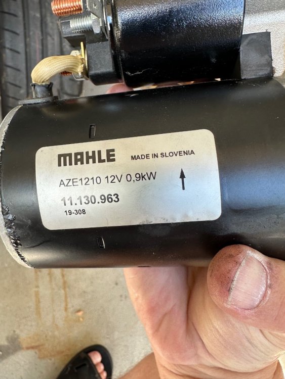

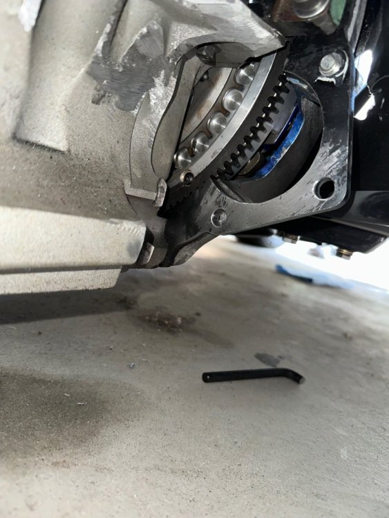

  2. Hi MV8, so here is my latest update: For the first time ever the engine is now running in the car ! I did have a crank trigger welded to the crank pulley and moved the Crank Position Sensor to the front of the engine: Bingo! I do however now have the problem of a nasty noise coming from the starter motor / flywheel area… sounds like a bag of spanners rattling around! I switched the starter motor for another one… Worse! I am open to suggestions on how to diagnose exactly what that might be? I have the three bolts tight? How do I know if it needs shims etc?

  5. Brief update: I installed the new starter motor today… and the good news that I got stat sync to come ON… but timing errors still climbing…. So I’m only HALF pregnant! so the new starter has improved things ( throwing off less emi) but I’m still throwing off enough interference to mess with the crank sensor reading ecu? Ill see what Omex suggests but am guessing I need to up my “suppression” game 🤷🏻‍♂️ IMG_3754.mov

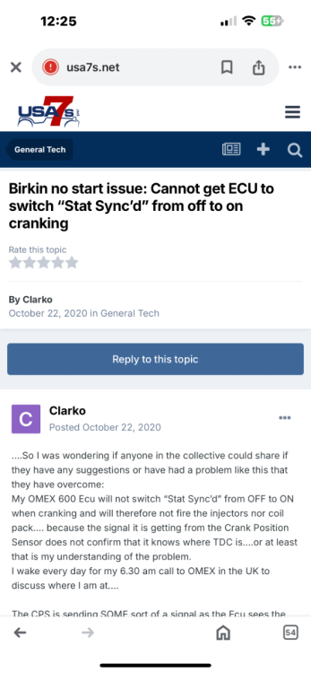

  21. Hi MV8, Here are the other 2 related threads over the last 2 years to give you the whole picture 🙏

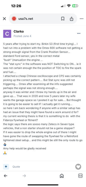

  23. Hi MV8, thanks for the response: This is a follow on question from a no-start issue I had 5 years ago… which resulted in me throwing up my hands 5 years ago and giving up on the car…. It had languished under a cover in the garage all that time, until now when I have become re-motivated to get it going…. I will link the old thread in here (if I can figure out how? I will also post the photos you have requested. To answer your basic question.. my ecu manufacturer from the UK (Omex had apparently thousands of Zetec running on Omex ecu’s… their latest conclusion is this: Since I can now get the Crank signal to “sync” properly when bumping it down a hill in second gear (I have not actually tried to start it this way as I need to change 5 year old fuel out of the tank)… but CANNOT get the engine to sync when using the starter, and the software suggests large EMI when starter is used that I therefore have a starter related EMI problem. This NOT my strong point but I can follow instructions pretty. The starter motor was new and it’s the second one that I have put in….. making me think is it possible it’s a grounding issue, or the way I am running my grounds which is why I am reaching out to the collective…. And looking to follow a “ known good” wiring method that works on someone else’s Zetec engined car… obviously a Birkin would be even better…. There is no such thing that I can find of Birkin posting WHERE to attach battery neg to chassis or engine and where to attach engine to chassis etc 🤷🏻‍♂️ Any help would be appreciated… I BELIEVE I am one step closer to get a first start on this car than I was 5 years ago 🤞
  24. Hi All, as I have now diagnosed my non-start issue to being emi interference from the starter motor!… I am trying to to double check best practises for earth wires? Where are you guys running your Battery negative wire? Engine block to chassis? Where? And then do you all have the starter motor as a 3 bolt to just the spacer plate between the Birkin 2000 sump and engine? … any special earthing required from that? Have any of you had issues with Electro Magnetic Interference thrown off by the starter…. I must have done something silly? Or have a starter with a fault? any thoughts would be much appreciated 🙏 Clark
  25. Thanks for this, AI at its best…. It’s the first reference I have seen to the shallowness of the trigger wheel that Fidanza attaches to the aluminum flywheel being a possible problem?? I am also back to playing with the air gap by trying to grind down the sensor and also the aluminum “Ford bush”.. crazy part is… the tolerance required by Omex for the air gap is 0.3-0.5 mm. I am trying to work on a plan B… My preference would be NOT to have to drop the engine out (I didn’t put it in so I am a tad intimidated by that) as I understand it EVERYTHING will have to come off that engine again first! Does anyone have a video or reference they can suggest for removing engine from a seven? If I did that then I guess Retroford in the UK for a new bush and lightened steel flywheel? Or open to suggestions? Or a new ecu sourced in North America? any suggestions for that? any other thoughts if you were wearing my shoes? Thankyou to all for your kind responses 🙏
