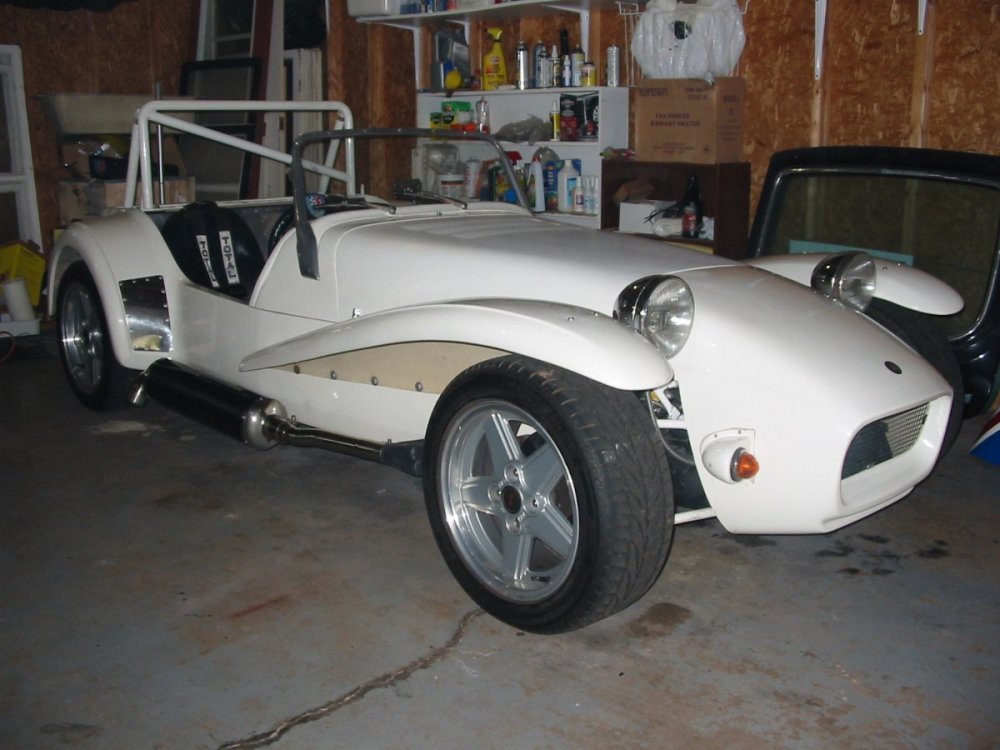

Fantastic John, thank you so much! Alignment is so key. I'm going to start with this set up. I'll not drive it on the street that much anyway, so why compromise. My street tires are what came on the car, and are old, crappy, and hard as hockey pucks, but still full tread depth. (See pic) I don't care how they wear. Incidentally, Fox body Mustang 10 hole 15x7 rims fit perfectly on our SEiW's with just a 1/4 in spacer. They're heavy and kind of ugly, but that's what I'll run on the street. I got a mint set in trade for a dozen beer from a friend, so it's hard to argue about the price. Plus, I got to drink at least half of those beers. :-) Cheers Phil -
