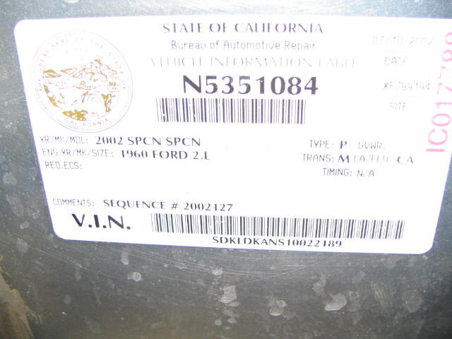

Just FYI.
The term 'SB100' is the unofficial term for SPCNS.  SB100 stands for Senate Bill 100 which was the number of the California Senate Bill that created the SPCNS in 2001 or 2002.  The term SB100 does not appear anywhere in the DMV's official registration instructions, only SPCNS.
I was one of the first to get an SPCNS number in 2002 and it doesn't say anything about SB100 on the sticker.  BAT gave me grief about the lack of 'SB100' on the sticker when I listed my car about 3 years ago.   Not really their fault as they do hundreds of cars per day and SB100 has been what everyone has called it since the beginning.
When you get to the DMV, tell them it's a Specially Constructed Vehicle, SPCNS.   They may or may not know the term SB100.
Note:  On more recent SPCNS stickers I have seen SB100 listed only in the comment line.
Mine from 2002
