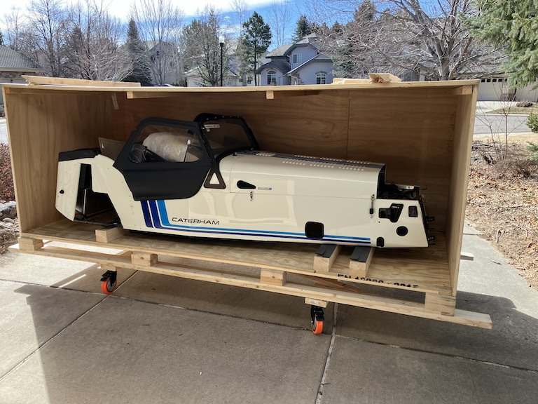

williamwashere Posted April 20 Posted April 20 Wow, nice choice on color!! I really like the graphics package that came with the Encore builds. That's going to be fun!! 3
jmaz Posted April 20 Author Posted April 20 I'd played around a lot with the Configurator and kept coming back to a white-with-blue-trim combination, with red versions coming in second place, so I was glad that white was one of the two no-extra-cost colors. Black is the other choice, which I think looks really sharp but I wanted a high visibility paint color. The other four Encore-theme choices cost an extra $1,750. If I'd wanted red or any other custom color, it would have cost $3K
Vovchandr Posted April 20 Posted April 20 I just noticed a center filler cap. Very peculiar. Not sure I've seen a lot of that.
jmaz Posted April 21 Author Posted April 21 The center filler cap is one of the standard features CC added to make the Encore a bit different. There are a few other things they pulled out of the parts bin, such as the red 4-pot calipers. 2
