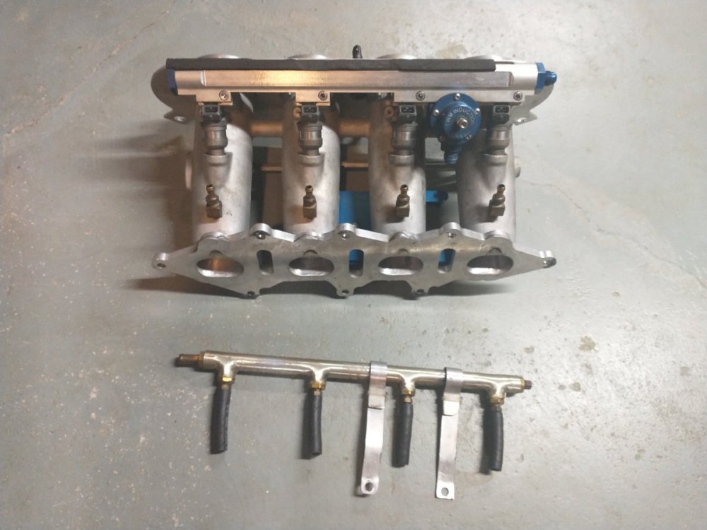

Vovchandr Posted May 3, 2021 Author Posted May 3, 2021 Here are mine So the question is, what purpose do they serve if they aren't necessary? Should I not have them machined and just run it as is? I assumed that it allows for IAC to work. So how do they ones with the capped work? Do the butterflies have a small gap and never close all the way?
ashyers Posted May 4, 2021 Posted May 4, 2021 In my experience they are used for balancing the throttles. I suspect yours were being used to try and pull a smooth vacuum signal, possibly for the FPR. I'd just cap them and map the car with no vacuum signal to the FPR. Where were they connected?
Vovchandr Posted May 4, 2021 Author Posted May 4, 2021 59 minutes ago, ashyers said: In my experience they are used for balancing the throttles. I suspect yours were being used to try and pull a smooth vacuum signal, possibly for the FPR. I'd just cap them and map the car with no vacuum signal to the FPR. Where were they connected? Straight to the IAC. Looks like IAC fed the air to the runners past the butterflies when those closed. Which poses question as to how the cars above run with these capped if they don't use the IAC like the green one from BaT
