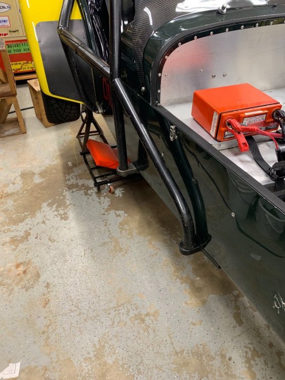

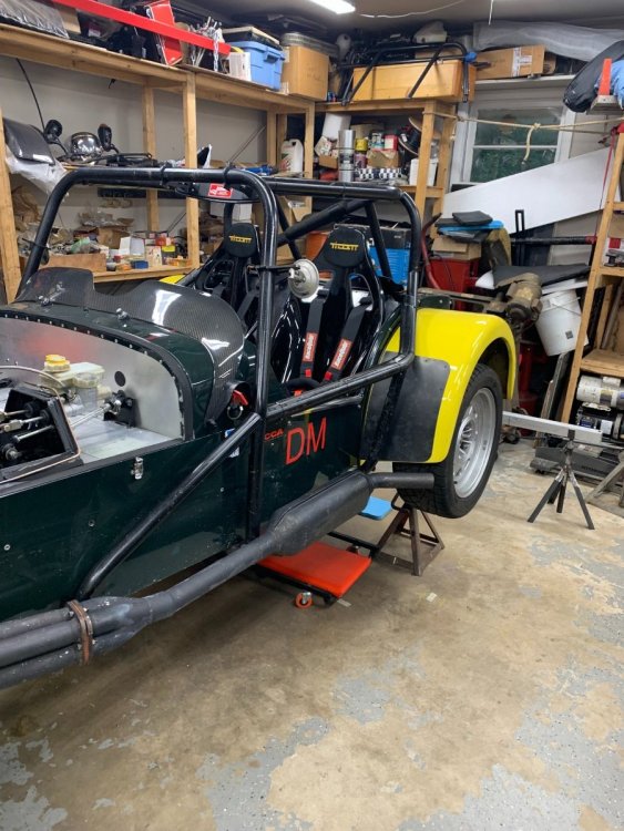

CarlB Posted July 14, 2021 Posted July 14, 2021 Attached are two pictures of my cage. I think it can give you some ideas to consider. It is a little wider for more side protection. It is also removable. The second picture shows how it attaches to the car. Two of them are connected to crossmembers. It was build locally by a guy who builds lots of cages for SCCA cars, but I can't remember his name. I bought the car with the cage.

Bartman Posted July 15, 2021 Author Posted July 15, 2021 Thanks for the photos CarlB, I had not seen that mounting arrangement before, all the ones I've seen before are bolted through the side. The more I see of full cages the more I think I do want it to be removable so all ideas and details of what has worked in the past are very welcome. I am really close to getting the car on the road, I plan to use it during the summer with the current engine and gearbox and then do the rebuild over the winter. The last thing to sort before getting the inspection is that I have a warning light on charging circuit, the previous owner said it had been on for the duration of his ownership with no battery issues so I am hoping its just the wrong wattage bulb in there on the exciter circuit, when I get to the car this weekend I have a couple of bulbs 2&3 watt I think that I will try.
