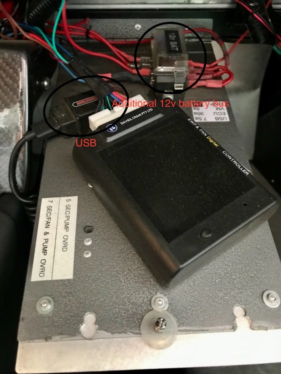

Picture #1 shows the hinged underdash panel. In order to simplify the wiring a bit, I added a small 12v accessory fuse panel. This panel hinges at the front of the scuttle support. The USB port is a generic motorcycle part

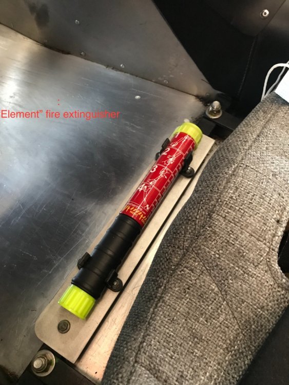

Picture #3 shows an Element fire extinguisher. Double the range and duration of a 2.5 lb powder or Halon. weighs less than 1lb.

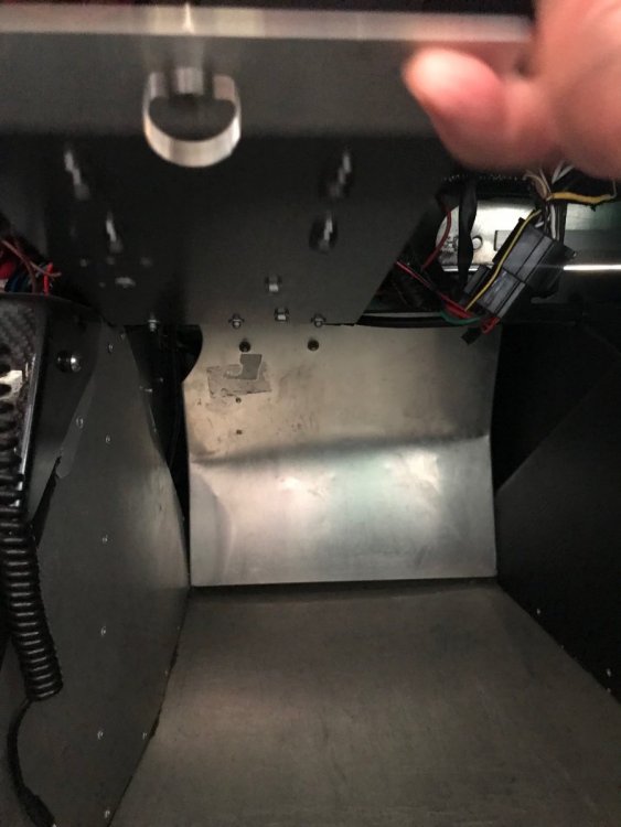

Picture #5 shows the panel at the front of the passenger footwell. Passengers will regularly use this as a foot rest. Unfortunately, this forms the rear wall of the electrical compartment and that is small enough without compressing it further. I plan on riveting a thicker aluminum doubler to this in the next week or so. Maybe 5/32" if I can find some scrap at the local metal supply.
