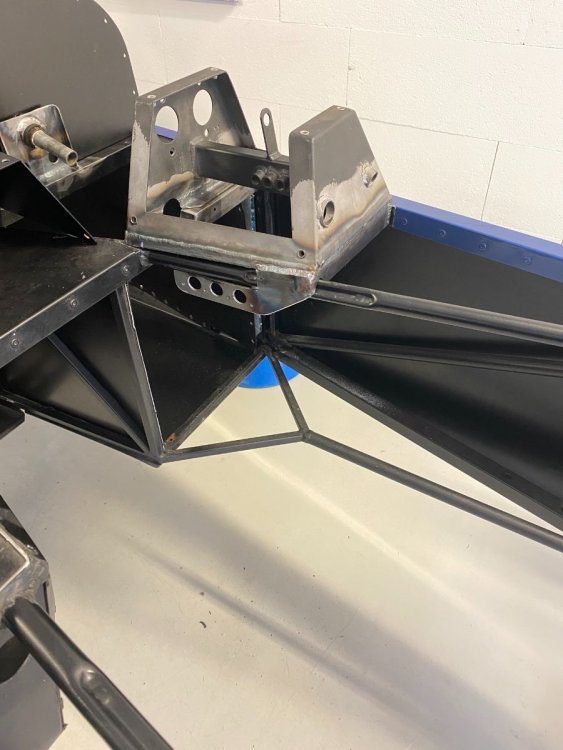

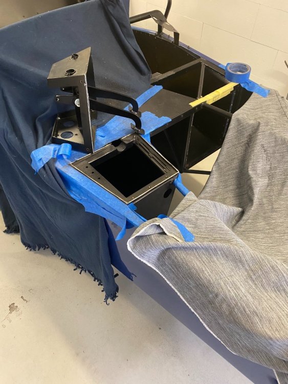

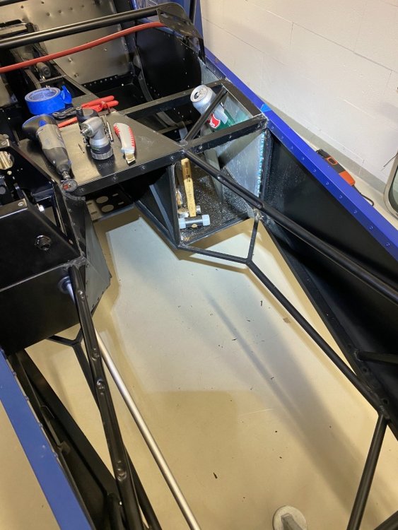

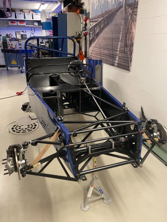

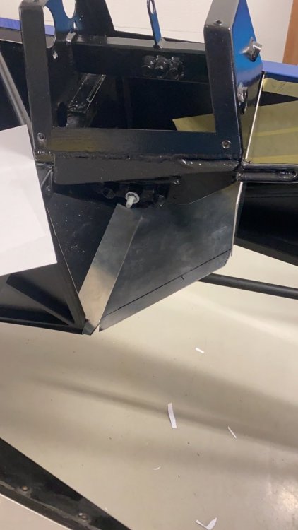

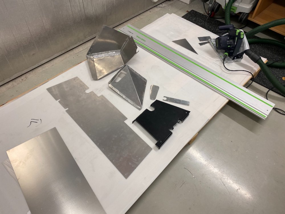

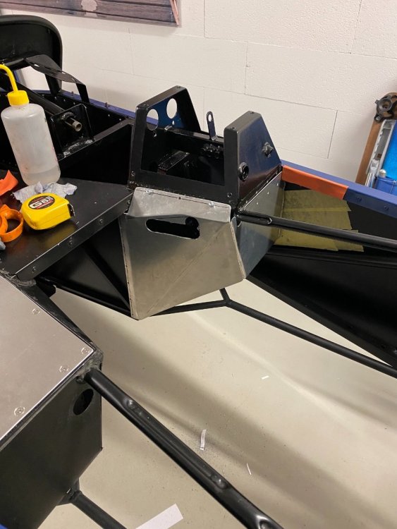

Hi, I have just completed a RHD to LHD swap and as there is very little information to be found, I thought I'd share my findings and a few pictures.
Chassis: Imperial S3
  • The steering column lower and upper are usable on both sides
  • The steering rack pinion can be rotated, but it needs machining a hole to the blanking plate. Remove C-lock ring, drill a small hole to the center of the blanking plate, use a punch to push the pinion out, take blanking plate out and machine larger hole to match steering rack connection and assemble -> done.
  • I didn't have mounts for steering on both sides, so I had to do some welding.
    • I cut the lower dash tube with the steering column symmetrically and flipped it over. The angles match.
    • I cut of the pedal box as close as possible to the footwell
    • The footwell on the driver and passenger side was of different shape. I used cardboard templates to replicate the original driver side, removed the original passenger side completely and built a new one out of scratch (1.5 mm 6061T6).
    • Reshaped and fitted the pedal box and welded it in place
  • Cut off the lower mount for the steering rack (just outside scuttle) and welded it to other side

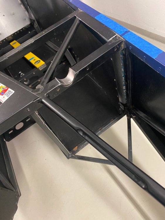

  • Made a half moon cutout into the rectangular chassis tube to clear the steering rack
Whether the steering column clears the engine components (exhaust, drysump, alternator...) or not is fairly hard to predict, but it can be checked with a string before starting. I had only a chassis to start with and could design everything around the new steering column location.
So it is perfectly feasible to switch sides, but it will require serious fabrication and welding skills. I hope this helps someone in the future!

What a great first post!  Welcome to USA7s!
On the chassis tube where you had to half moon a segment to create clearance, is this occurring because the chassis tube on the other side is a different shape/location/position?  They look similar in the photos but only one side needed a segment removed for clearance?
Link to comment
Share on other sites
The tubes are similar on both sides, I left the original half moon cutout in place - after all who knows, perhaps someone wants the car in RHD format in another 54 years from now...
