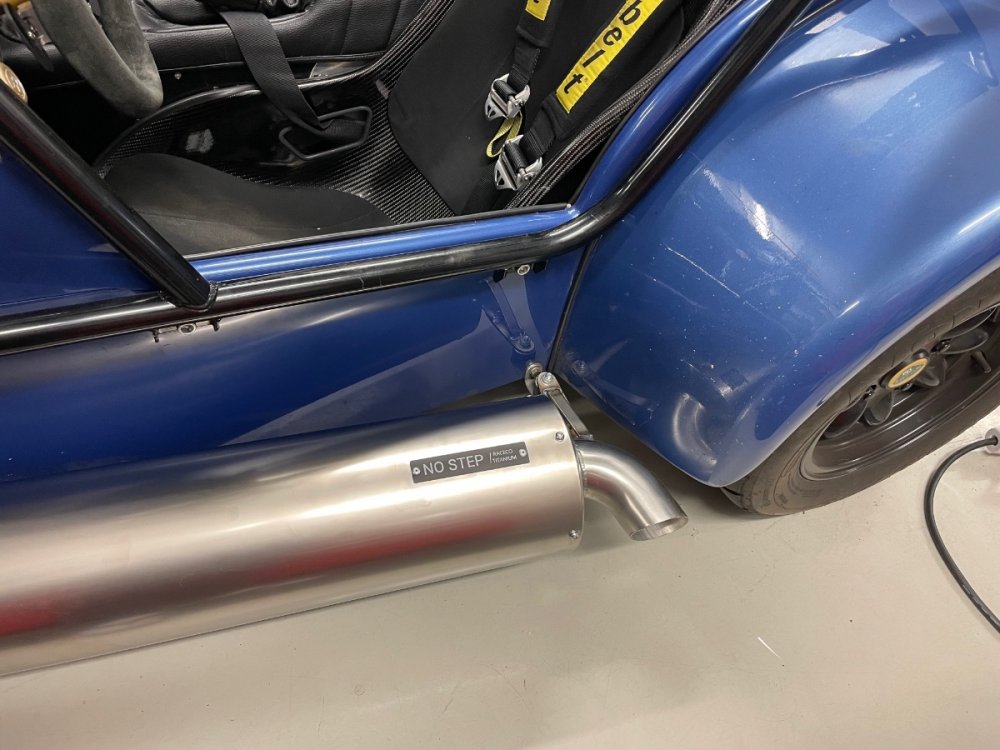

Ok, we made the “no step” signs in all 3 colors and I picked the black one. It is attached with gas proof rivets and a dab of ultra grey silicone:

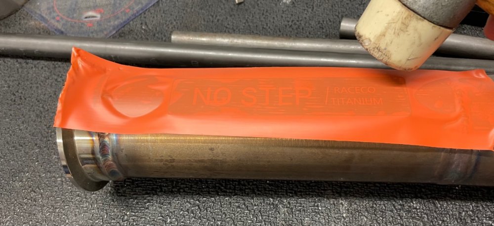

The sign was formed to match the radius of the silencer with this simple setup: Loosely taped to a round shape and then tapped with a nylon mallet along the long edges, while pressing the opposite edge downwards with fingers.
