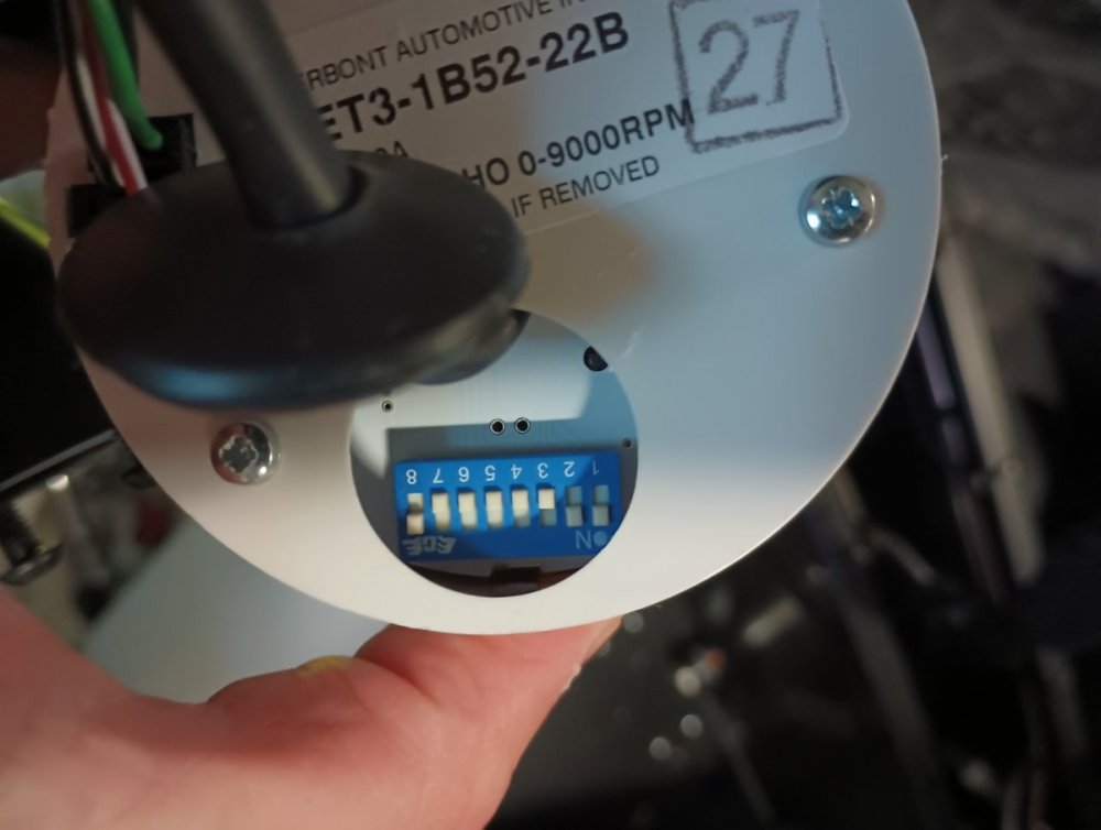

KnifeySpoony Posted March 15, 2022 Posted March 15, 2022 Check the dipswitches inside your tach - mine were set wrong. Went back and forth with Caterham, trying different ECU tunes, wasting time. Took 2 min to fix (against Caterham's advice lol).
Austin David Posted March 15, 2022 Author Posted March 15, 2022 The white-backed tach? I pulled the tach off the dash enough to see that it's mostly / appears to mostly be a sealed unit. Not too hard to pop the cover?
Austin David Posted March 15, 2022 Author Posted March 15, 2022 referring to your previous post: https://usa7s.net/ips/topic/13527-tach-misreading-on-420r/#comment-124677 For future reference: the table for switch settings. 1+2+8 on (rest off) are the factory settings. Per the table, 1+2 is 2 pulses per revolution, which is "correct" for a 4-cyl / 4 cycle motor. Switch 8 is always "on". So I need to get it reflashed to make the tach work. Womp womp. To pull the tach: had to nip 2 zip ties under the dash to free up the cable a little. Gently pry the grommet loose, the switch is right under there.
Austin David Posted March 15, 2022 Author Posted March 15, 2022 OK, some working through lunch... I set the switches to 0.5 PPR, on the logic that if my ECU is truly sending 1/4 pulses, I can just tell the tach that. Confirmed with ODBII, the tach now reads correctly with some caveats: - it's probably slightly less responsive, since it's getting 1/4 the data as before. Nothing I notice by blipping the throttle in the garage. - it bottoms out at 1100 RPM indicated. 800 actual (ECU) RPM -> 1100. 1200 actual RPM -> 1200. I assume this is a feature of the pulse-measuring algorithm, but doesn't otherwise seem to affect my usage. Per the book, 0.5PPR is 1-7 off (0 0 0 0 0 0 0 1). 8 stays on all the time.
