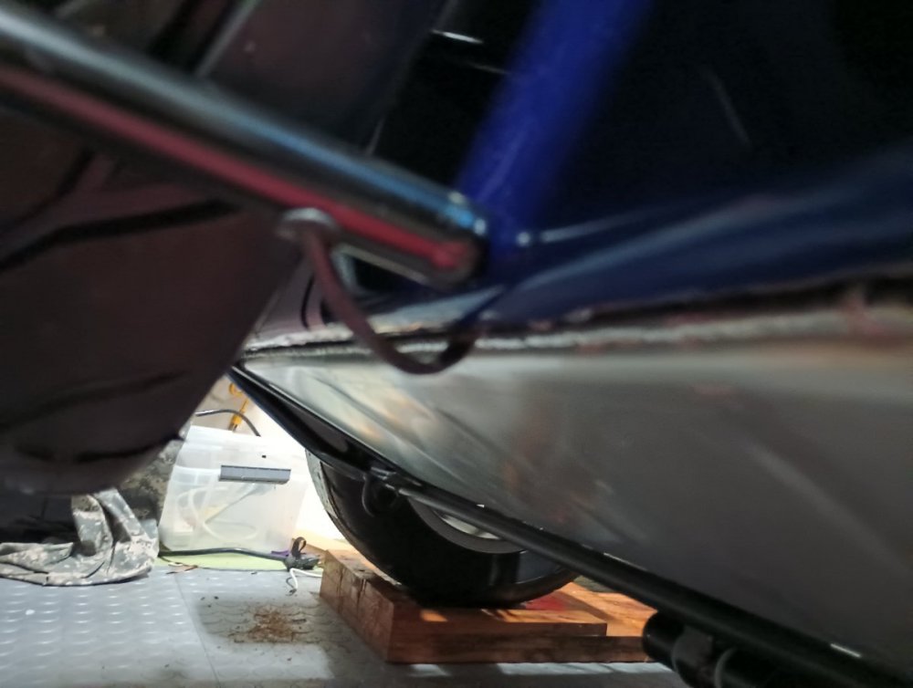

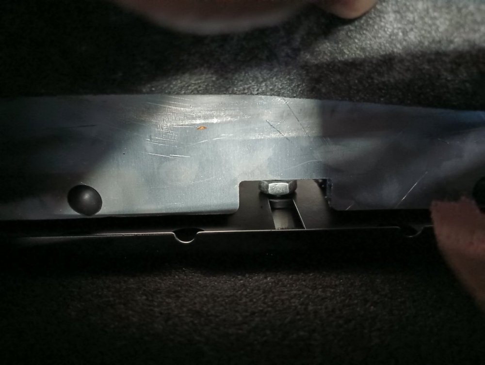

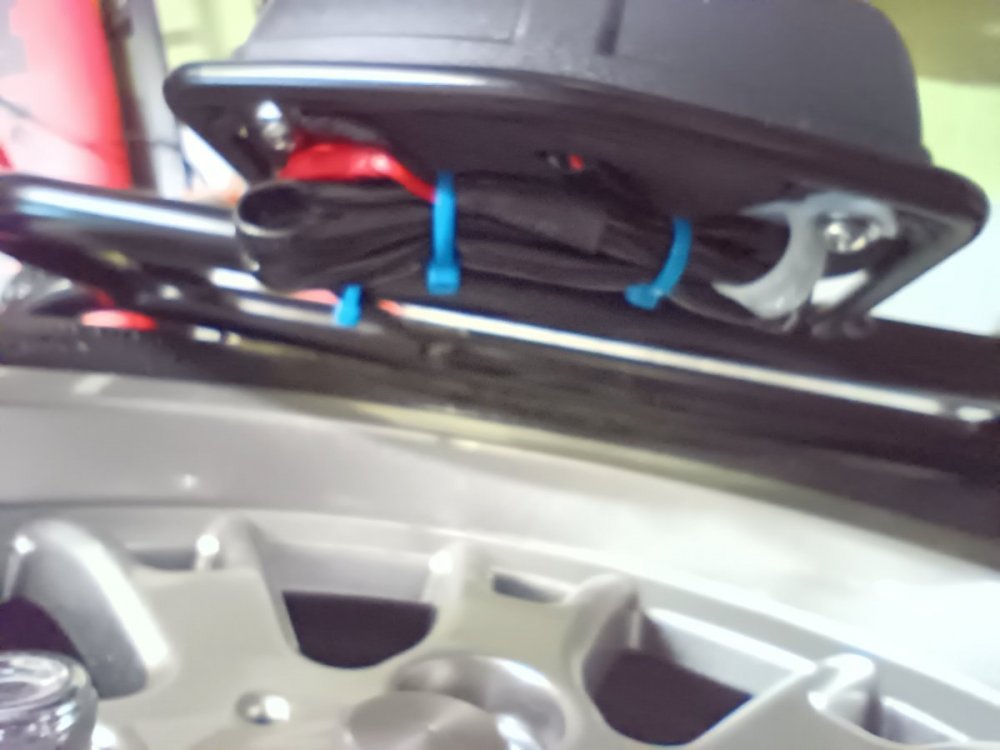

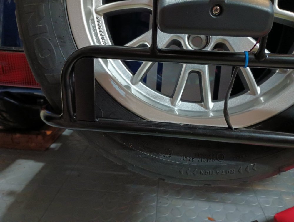

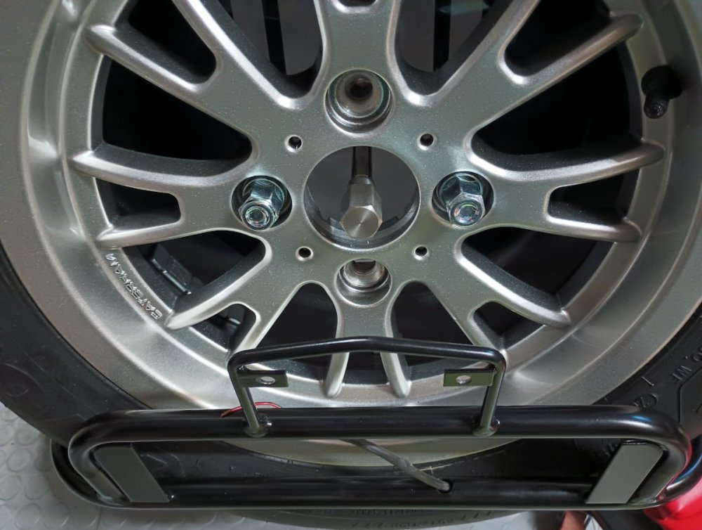

Austin David Posted April 8, 2022 Author Posted April 8, 2022 (edited) Spare tire carrier -- I haven't found any builds with this, had to puzzle through it but I got there. There's the carrier, a wishbone, two extra lugnuts, a fancy long bolt + LONG spacer, and a separate pack with two unused bolts, a shorter spacer (about 3"), and a fibre washer. Plus the license plate light, which I assume is common across all kits. 1) the carrier itself mounts directly to the frame. The license plate wire (black/red) was zip-tied to one of the mounting holes. Cut that loose, then bolt up the carrier. Two 13mm nuts can be tightened from underneath, open-end wrench only. 2) there's a nut behind the fuel tank, inside the skin. You can access it from the boot / under the carpet, but I didn't have a large enough open-end wrench to secure it; it's bigger than 21mm. Adjustable didn't fit. I used pliers to hold it still, and ran the long securing bolt + oversize spacer to spin the bolt-side from outside. This bolt secures the tire hold-down to the frame, through the aluminium skin, so I assume it's pretty important. 3) the 5th tyre: mount the wishbone w/ 2 extra lugs, run the fancy bolt + shorter spacer into the wishbone, then CAREFULLY set the wheel in the carrier. Add the fibre washer, then the bolt can pass into the mount on the body. Snug up the bolt, then use a lug wrench to snug the two lugnuts (securing the wheel to the wishbone), then tighten up the longer bolt to secure the wishbone to the body. I didn't crush this down, just don't want anything rattling loose. Most of the weight is borne by the carrier, but this wishbone assembly keeps the tire from rolling loose or rubbing on the body. When it's all done I have about 1" clearance to the paint, tire resting on the carrier. Still plenty of room to install the plate and light. 4) the light has a single red/black wire tucked under the frame, and plenty of slack. It's got a plastic sleeve already there. There's a grommet on the RHS of the carrier. Feed the wire into that grommet, and it will easily snake its way through the frame to the back. There's a roomy hole in the top of the frame, behind where the plate will eventually go. I was able to fish the wire out with tweezers, there's room for needle nose. 5) the light came with a ton of wire, I just tied all that up. A ring terminal on the black wire / light side, and a spade between the red and the red/black from chassis. I added heat shrink and tape, this is all exposed to the elements. Sand off the RHS mounting hole a little, that's our ground. Remove the cover for the light (single screw). Terminal goes there, bolt through the terminal from the back, then the nut on. Connect the reds, test. 6) for cleanup, I added a nylon wire clip on the LHS mounting bolt to hold that bundle of wire. Zip ties to keep it tidy. The worst of all this is that the hot wire comes up from the bottom of the frame, but it will be pretty well obscured behind the license plate, eventually. Edited September 14, 2022 by Austin David fixing inverted photoes

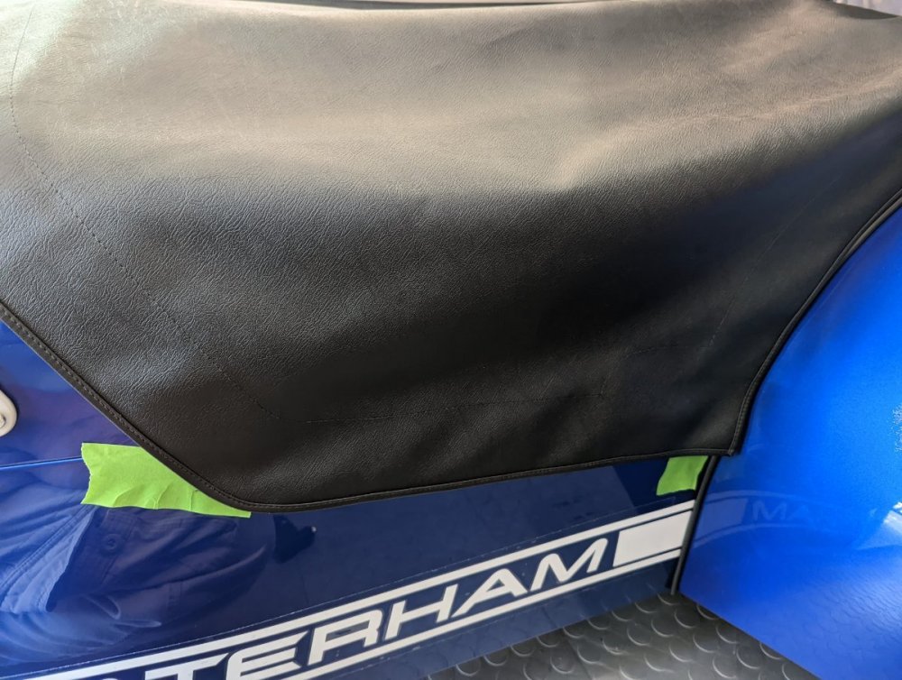

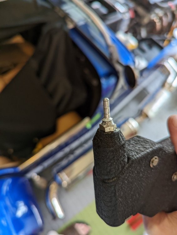

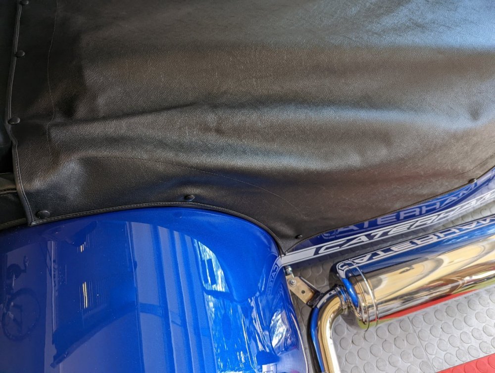

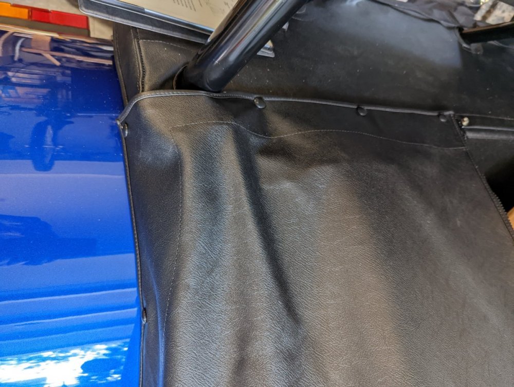

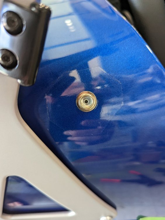

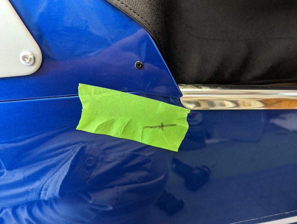

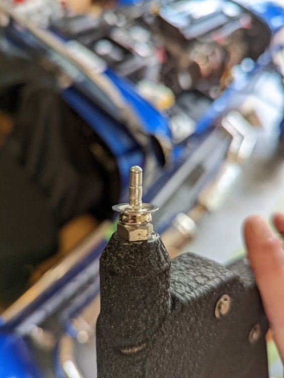

Austin David Posted May 14, 2022 Author Posted May 14, 2022 (edited) Tonneau Cover is fitted per instructions. I had to figure out some stuff, so I've added photos to augment what little info seems to be out there. It hasn't gotten any wind yet, so if I add more snaps I'll post back in here. 1) this was pretty nerve-wracking for me, I don't like drilling into paint. The recommended locations appear to dodge interior frame bits tho, so I do recommend sticking to them 2) the riveted-on snaps need a pretty thin rivet gun head; I hear the Stanley gun works, I used a bench grinder to fix mine. Pix below 3) tape is your friend here. Also sharp drill bits. 4) at least one of my snaps was defective, eyeball 'em before making anything permanent. 5) the pliers-style punches and rivet setters aren't great. Invest $10 in a punch and die. Also 3# hammer and an anvil will make your life slightly better. 6) One at a time. It's a lot of on/off, but things shift around or don't come out precisely where marked, so you get to re-measure every hole, every time. Still better than the diff install. The back side: my boot cover came installed, but the outer snaps were finished with a button cover. You need to drill this out and replace with a gypsy snap (male) and standard female inside. The tonneau cover fastens over this, onto that new male snap. My kit came with precisely two of these gypsy snaps in the tonneau pack, so either get it right on the first try, or hit sailrite.com for a few more. Also note that removing those riveted snaps is annoying, they want to catch the drill bit and spin. Vise or vise-grips. Per other instructions, I lined up the front + back on the centerline and marked the front snaps, installed both LHS + RHS, then marked the centers on the back & installed the snaps. Same across the rest of the back. For the outer corners I gave a little slack to stretch over the seatbelt cover (I use retracting 3-point), and mostly lined up with the cover flush against the piping on the wheel well. It's still pretty snug. There's another snap already installed at about the center of the wheel arch between the rollover bar and sill. I again measured with the cover snug and aligned to the piping on the arch, double-checking by holding it snug against the scuttle. The remaining 3 snaps per side involve rivets and drilling. The book recommends good locations, but I did move the 2 scuttle points about 5mm toward the front wheel, putting the snaps closer to the edge of the cover to match the others on the top side. I measured per the book, marked over tape, knocked around a lot to be sure there wasn't anything hiding under, and drilled it out. I did not attempt to use backing washers -- the two under the scuttle are covered with the wiper motor (RHS) or some controls support on LHS, and the lower ones are under interior panels. I did use helicopter tape under the body snaps. Rivet through the snap and the hole (if taped, you have to cut that helicopter tape -- can't just punch through). I also put a fair bit of painter tape over the assembly in case the riven gun hops out when the rivet pops. All 6 rivets went in very clean. So: measure the scuttle rivet per the 2015 manual, double-check with a cover test-fit, drill+install the rivet & male snap, unzip the cover, stretch to mark your female snap, install it. Then mark and measure the lower-front rivet, install it, stretch the cover to fit, and do the snap. Repeat for 3 on LHS, then 3 on RHS. The rear sill didn't include any photos in the book. There is a frame member in there, so they are pretty serious about 45mm forward of the arch. The book claims the zipper will take up some slack, I'm less convinced. The vinyl will loosen a bit in the direct sun, I'm sure even more than my 80-degree garage. But it looks like it will fend off rain, and the RHS / passenger side looks pretty secure. I'll get some wind on it this weekend. Edited May 14, 2022 by Austin David lining up photos

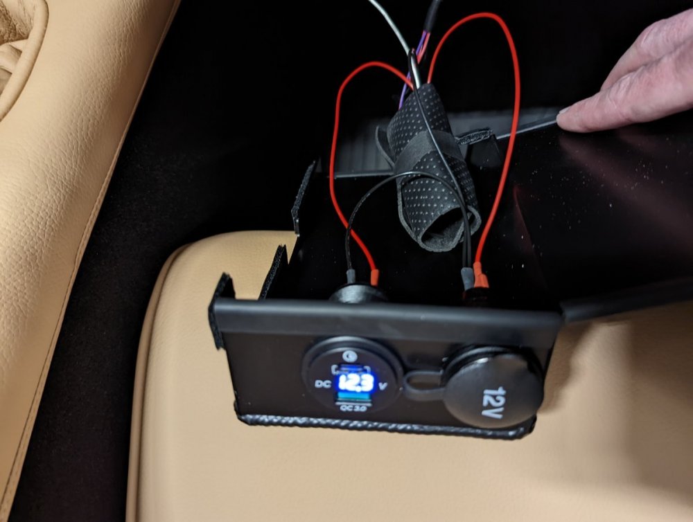

Austin David Posted May 17, 2022 Author Posted May 17, 2022 (edited) I added a relay to switch on/off the 12v socket, using a fuse tap on the ignition fuse to drive a standard bosch-style 40A relay. I also added a dedicated USB socket off the same relay, so I can charge my phone and run any sort of microwave-detecting devices for purely scientific purposes. One item of note, the fuse panel actually eats up a bit of space inside the cover, so if you do run a second port, give it a little room. I'm OK but cut it kinda close. The outcome looks really nice tho. Plenty of space on the right for that extra relay. Edited May 17, 2022 by Austin David adding a linky 1

sainthoo Posted May 21, 2022 Posted May 21, 2022 On 5/14/2022 at 12:38 PM, Austin David said: Tonneau Cover is fitted per instructions. I had to figure out some stuff, so I've added photos to augment what little info seems to be out there. It hasn't gotten any wind yet, so if I add more snaps I'll post back in here. 1) this was pretty nerve-wracking for me, I don't like drilling into paint. The recommended locations appear to dodge interior frame bits tho, so I do recommend sticking to them 2) the riveted-on snaps need a pretty thin rivet gun head; I hear the Stanley gun works, I used a bench grinder to fix mine. Pix below 3) tape is your friend here. Also sharp drill bits. 4) at least one of my snaps was defective, eyeball 'em before making anything permanent. 5) the pliers-style punches and rivet setters aren't great. Invest $10 in a punch and die. Also 3# hammer and an anvil will make your life slightly better. 6) One at a time. It's a lot of on/off, but things shift around or don't come out precisely where marked, so you get to re-measure every hole, every time. Still better than the diff install. The back side: my boot cover came installed, but the outer snaps were finished with a button cover. You need to drill this out and replace with a gypsy snap (male) and standard female inside. The tonneau cover fastens over this, onto that new male snap. My kit came with precisely two of these gypsy snaps in the tonneau pack, so either get it right on the first try, or hit sailrite.com for a few more. Also note that removing those riveted snaps is annoying, they want to catch the drill bit and spin. Vise or vise-grips. Per other instructions, I lined up the front + back on the centerline and marked the front snaps, installed both LHS + RHS, then marked the centers on the back & installed the snaps. Same across the rest of the back. For the outer corners I gave a little slack to stretch over the seatbelt cover (I use retracting 3-point), and mostly lined up with the cover flush against the piping on the wheel well. It's still pretty snug. There's another snap already installed at about the center of the wheel arch between the rollover bar and sill. I again measured with the cover snug and aligned to the piping on the arch, double-checking by holding it snug against the scuttle. The remaining 3 snaps per side involve rivets and drilling. The book recommends good locations, but I did move the 2 scuttle points about 5mm toward the front wheel, putting the snaps closer to the edge of the cover to match the others on the top side. I measured per the book, marked over tape, knocked around a lot to be sure there wasn't anything hiding under, and drilled it out. I did not attempt to use backing washers -- the two under the scuttle are covered with the wiper motor (RHS) or some controls support on LHS, and the lower ones are under interior panels. I did use helicopter tape under the body snaps. Rivet through the snap and the hole (if taped, you have to cut that helicopter tape -- can't just punch through). I also put a fair bit of painter tape over the assembly in case the riven gun hops out when the rivet pops. All 6 rivets went in very clean. So: measure the scuttle rivet per the 2015 manual, double-check with a cover test-fit, drill+install the rivet & male snap, unzip the cover, stretch to mark your female snap, install it. Then mark and measure the lower-front rivet, install it, stretch the cover to fit, and do the snap. Repeat for 3 on LHS, then 3 on RHS. The rear sill didn't include any photos in the book. There is a frame member in there, so they are pretty serious about 45mm forward of the arch. The book claims the zipper will take up some slack, I'm less convinced. The vinyl will loosen a bit in the direct sun, I'm sure even more than my 80-degree garage. But it looks like it will fend off rain, and the RHS / passenger side looks pretty secure. I'll get some wind on it this weekend. In the “detailed 420R build blog,” the guy used some tiny washers inside the female snap so that his rivet gun could apply pressure (makes it possible to use any rivet gun for those things- handy tip for anyone reading). More discussion can be found on the section about fitting mats. Here is a pic taken from that blog: Congrats on being done!
Austin David Posted May 21, 2022 Author Posted May 21, 2022 I saw that. I have a grinder at home but woulda had to go out to hunt for tiny washers...

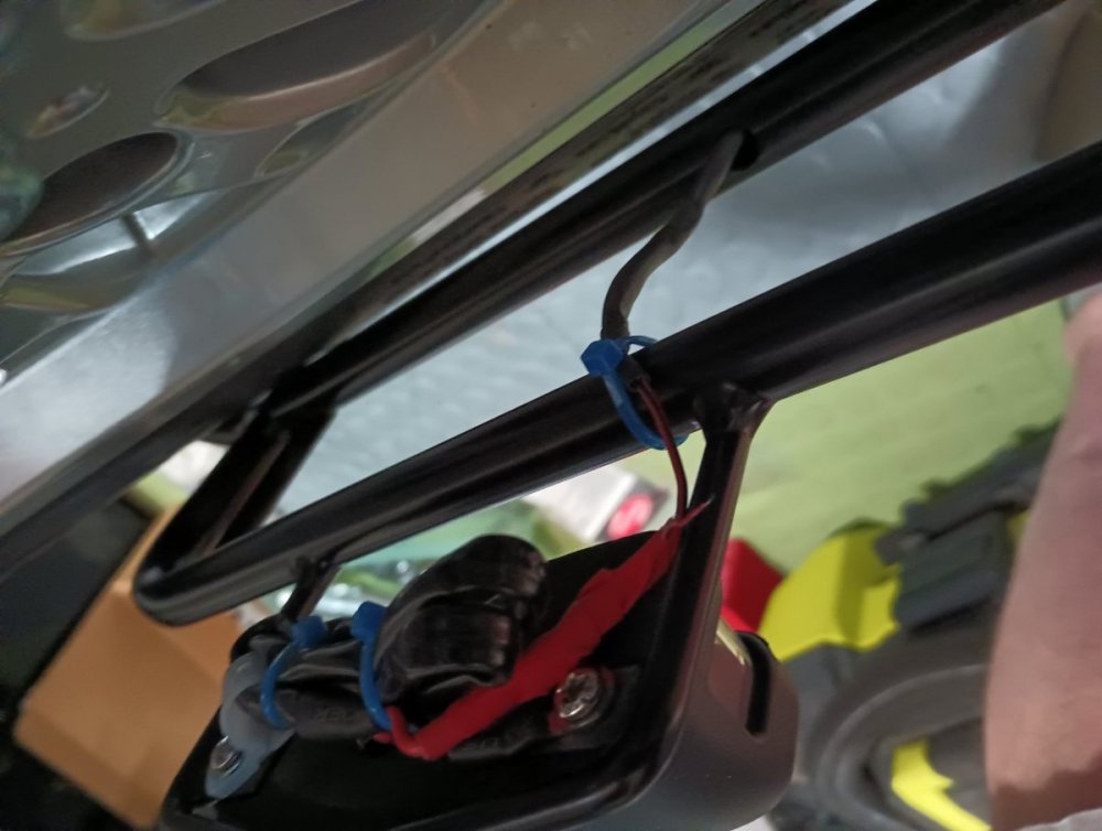

Austin David Posted May 24, 2022 Author Posted May 24, 2022 Aeroscreen: fitting this is pretty well written up elsewhere, I'll add the things I had to figure out. - removing the windscreen is easy for 2 people, but not hard solo. I loosened both sides, removed one side completely. The screen will stay upright, no problem. Cut the wires (if you ever want to reconnect, cut as close as possible to the spade), then re-attach that side. Repeat on the other side, but leave it loose. Go back to the first side, hold the screen + remove the last 2 bolts, and carefully lift the screen off. I put rags under the loose side "just in case". - mirror placement is sort of a dark art. Having drilled holes I think I got lucky (plus there's some room to adjust). I eyeballed the RHS and made the LHS match. Aesthetically, it may be interesting to have the 3 mirrors all at the same height. To make them symmetric, I measured from the rearview to the center of the sideview mount, and matched on both sides (16" exactly, from opposite edge of rearview -> center of sideview mount). It seems to work, but I'm short half the hardware so only the RHS is mounted until stores opened the next day. - the screen is curved, the mirror mounts are flat. I used VHB tape + thin foam pad (drawer liner) for a sort of makeshift washer, trimmed to fit. This MAY help spread the load a little better, and not deform or crack the screen - there are two open holes on the scuttle, I've used SS washers + two windscreen bolts to fill cover it.

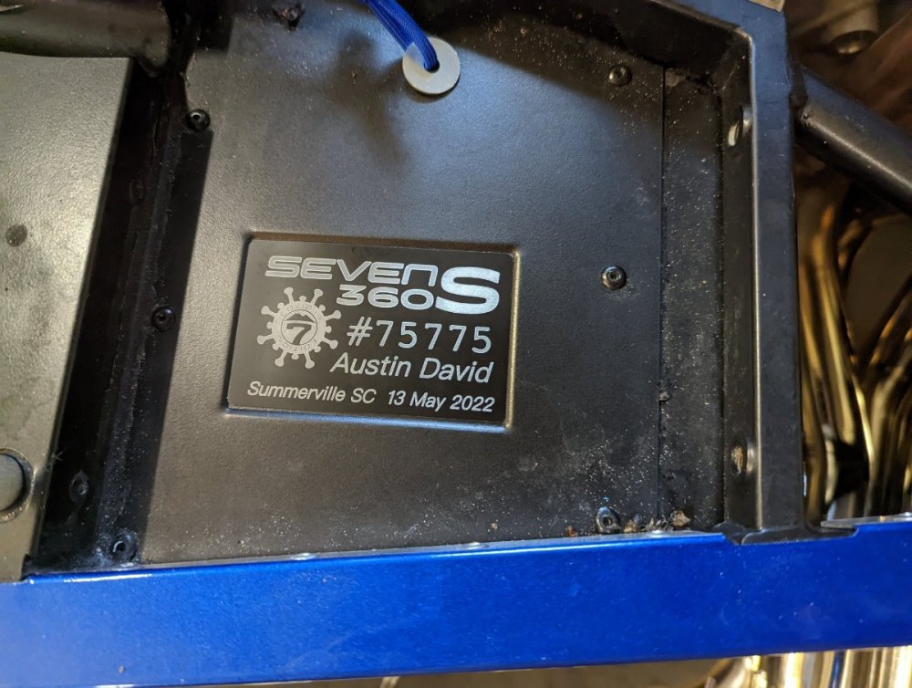

Austin David Posted May 29, 2022 Author Posted May 29, 2022 found an indent on the RHS footwell in the engine bay, perfectly-sized for a business card / build plate. 1
UglyFast Posted June 2, 2022 Posted June 2, 2022 On 5/28/2022 at 10:46 PM, Austin David said: found an indent on the RHS footwell in the engine bay, perfectly-sized for a business card / build plate. VVV cool
Austin David Posted June 3, 2022 Author Posted June 3, 2022 21 hours ago, UglyFast said: VVV cool Thanks! LMK when you get closer and I can burn you one
