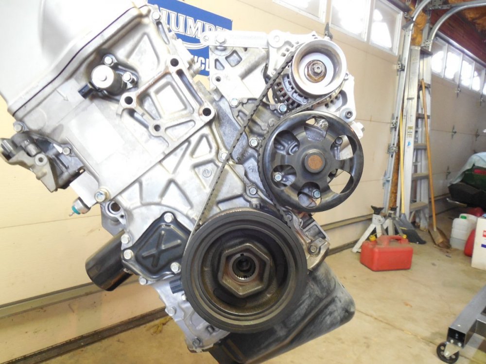

RedbeardRacing Posted February 10, 2022 Author Posted February 10, 2022 My issue is definitely space. I'm going to see what I can fit. Which Honda engine did you go with. Will a k series fit?

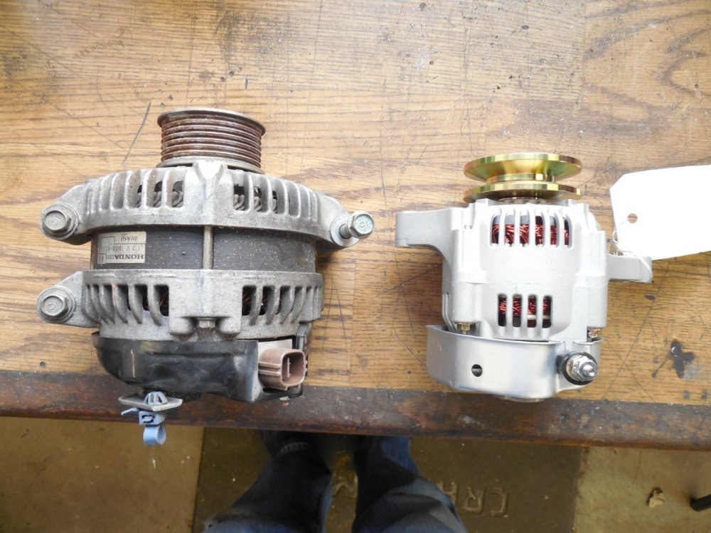

fastg Posted February 10, 2022 Posted February 10, 2022 K24A2, great motor, but very tall, tough to package. You can see the difference to the stock Honda Alternator. Graham
RedbeardRacing Posted February 14, 2022 Author Posted February 14, 2022 I bet it's peppy with k series in there, and even more cramped than mine. Found a broken top alternator bracket. That could have been side loading it, at bare minimum vibrating and sorts. Gonna throw a new one on it with a fixed bracket and see what happens. Does your amp meter show 0 when running? Shouldn't it be +12/14 if the alternator is working?
fastg Posted February 14, 2022 Posted February 14, 2022 It's peppy for a $700 junk yard motor. My guage shows a little under 12 volts at idle, but goes up to 14 as soon as the throttle picks up. With a 7.5k red line I don't want to over spin the alternator so I have to running a little slow. Graham
