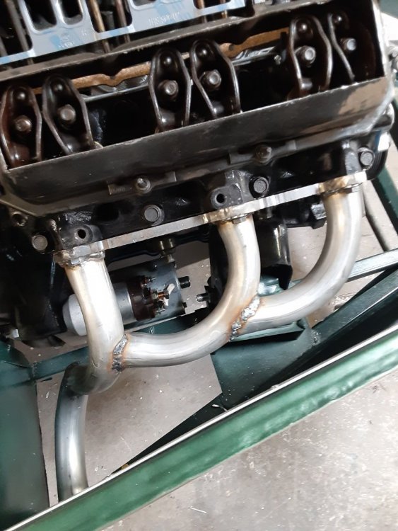

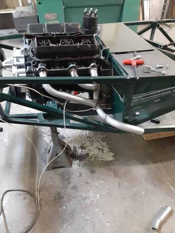

I had to make my own headers. no one has then for a 60 deg GM engine V6. I had little engine bay room; it wasn't that big a deal.  I made the head plate out of 3/8 steel plate, used an exhaust gasket as a template. there is a muffler shop where I live so he bent a bunch of tubbing that I cut and welded. no chrome no wraps. no mufflers, just loud as hell Just what I wanted
