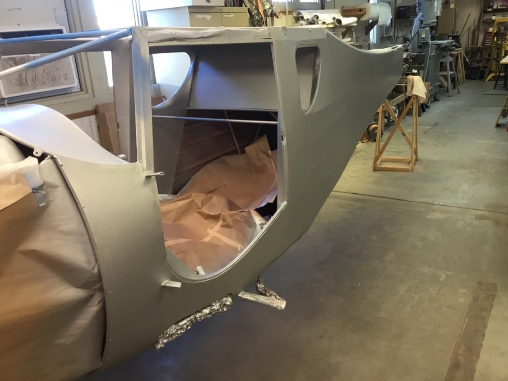

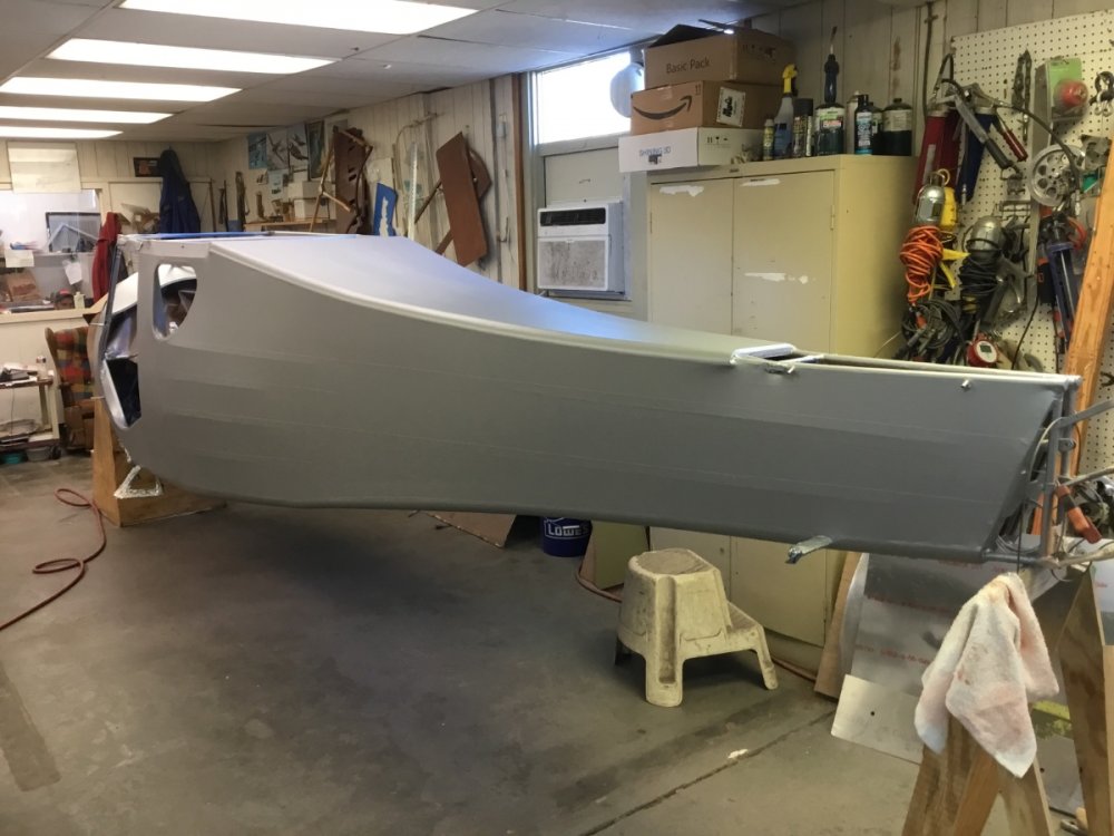

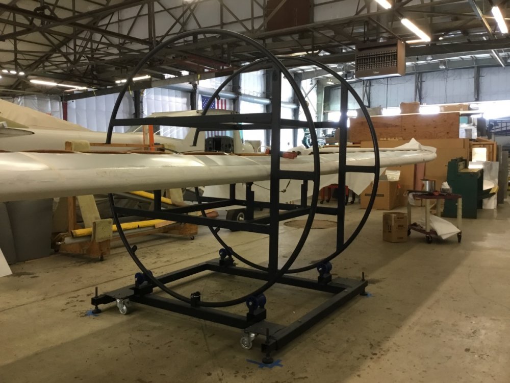

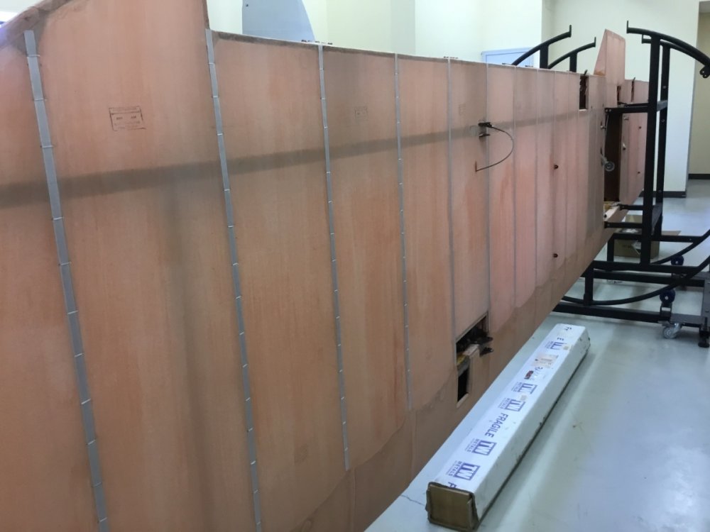

Stevensonjr Posted August 13, 2022 Author Posted August 13, 2022 When I’m solo the Cub gets off the water in 6 seconds. The 0-200 and the flat pitch float plane prop really make it jump. Cruise is about 70 max. I put a C-90 in the L4, replacing the C-65. It’s on wheels with good performance with 2 on board on a no wind hot day. 1400’ strip at the ranch with obstructions. Today I finished rib stitching the 32 ft one piece Monocoupe wing. I’ve got it on a rotisserie fixture which makes it a fairly easy one man job. I built the fuselage up last year, covered it and Poly brushed thru silver, waiting on the wing.

Stevensonjr Posted August 14, 2022 Author Posted August 14, 2022 6 hours ago, MV8 said: Understood. I assumed it was a 90. I've been wanting to build a kiln to cast my own parts using the lost foam method. Bent, scrap alloy wheels are a great source of material. We will start on the engine after we cleanup all the parts. Here is where we are now. 2
