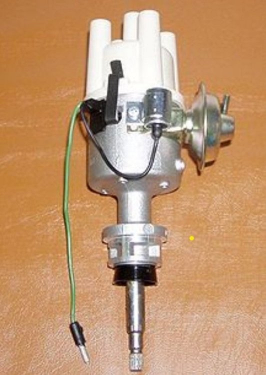

IamScotticus Posted November 16, 2022 Share Posted November 16, 2022 No PATS required Yes, im trolling ☠️ Link to comment Share on other sites More sharing options...
HUTCH Posted November 17, 2022 Author Share Posted November 17, 2022 can you please be more explicit on what this picture is showing Link to comment Share on other sites More sharing options...
IamScotticus Posted November 17, 2022 Share Posted November 17, 2022 It's a distributor; a component of non-computer controlled engines. Im just being cute. Ignore me. But if you wanted to put in an all mechanically timed engine, the Kent crossflow is still a viable engine with lots of parts support and 55 years of tuning knowledge available. Link to comment Share on other sites More sharing options...
