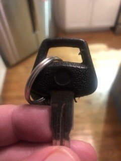

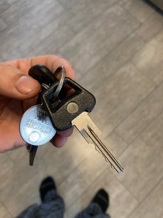

What exactly is a "stock"ecu.  I am told that if hass the pats system built in which I gues must be the typical case, that it will not work if the vehicle does not have pats

"Stock" means original equipment from the manufacturer (OEM). The computer is not standalone.
That is a stock computer that requires a PATS module and a chip usually located in the ignition key. The chip is matched to the computer. You must have the correct chip/key and module to operate the computer. There is no practical way around that to use the stock computer. Bypass kits typically just relocate the module with a box to put the correct key in proximity.
 I expect the chip/key is buried with the module in the cowl somewhere and is always together so you can use a standard chipless ignition key for controlling the ignition.

no gas and no spark.  consensus is that anything with pats will no work.  what if any work around can you suggest.  my mechanic and service mgr from a caterham dealer seem to be in agreement . sent unit ouy and they sent it back noting this issue/  the key is the non electronic version as well.  they seem to think putting in ignition with pats is not possible.

the hidden key theory sounds unlikely to me.  That would not answer the question of why it all of a sudden stopped working when it was still in my garage
Sure it does.
Also, PATs involves more than key recognition but I understand if you want to go with what sounds likely based on your experience.

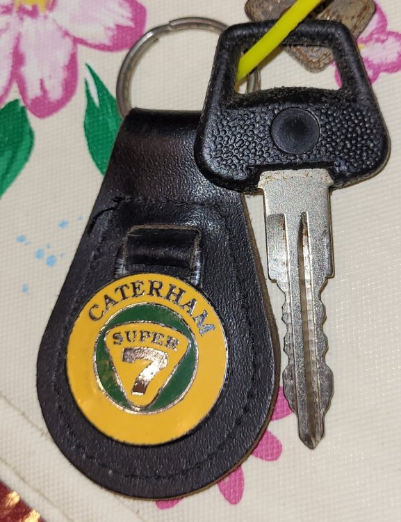

we have cat s3 built in 06 with focus svt engine oem ecu.  it use std cat key w/o chip . under scuttle zip tied is ford pats module with chip taped to it. module is black plastic rectangle with ring on it for install on steering column . cat harness was "married" to ford harness by RMSCI .. salvage engine came with ecu and matching keys

It covers a LOT of wiring and may be hiding the Ford PATS module.  I previously owned a Caterham of the same year as yours and my car was identical to how @glenntwincam describes it above in an earlier post.
