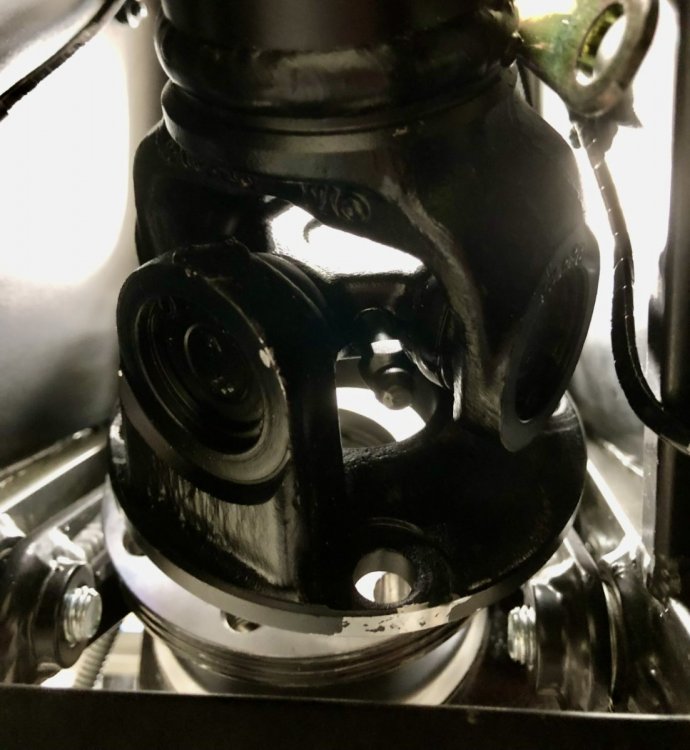

sf4018 Posted November 19, 2022 Posted November 19, 2022 I’m in the process of taking the engine out and noticed a label on the prop shaft that says to “ensure the unit is fully lubricated with a lithium based grease before use”. I didn’t do that on the original install, did I screw up or is this just a cya? Does anyone know how to fill it up? All I see are some spring clips on each joint.
MV8 Posted November 19, 2022 Posted November 19, 2022 Lithium is the most common grease used for both prop joints and wheel bearings but not good for cv joints (extreme pressure with moly-disulphide added such as flat tappet cam break in lube) . Historically, calcium base was for the chassis for waterproofing and sodium base was for higher temps. I use common, synthetic name brand lithium for chassis lube, ujoints, and wheel bearing packing. There are many kinds of lithium grease so make sure it is labelled for wheel bearings to use for the ujoints. If there is a grease fitting, it should be on the center cross body or have a fitting in the center of one of the caps. Sometimes, there is no fitting. Ujoints are standardized and cheap. Replacements usually come with a fitting.
IamScotticus Posted November 19, 2022 Posted November 19, 2022 (edited) can you rotate the shaft to look for zerks? they can be very hidden in a u joint. Is there grease slung in the tunnel around the joints? Your joint looks clean, like sealed bearing, but I don't know if sealed would have circlips. I have a loose shaft (not really) and it looks a lot like yours (I hope not) Flip it over and there is a grease zerk Edited November 19, 2022 by IamScotticus
sf4018 Posted November 20, 2022 Author Posted November 20, 2022 Thanks @MV8 and @IamScotticus. I,ve rotated it around and don’t see a grease zerk anywhere, but I’ll take another look when it comes out.

sf4018 Posted November 20, 2022 Author Posted November 20, 2022 Thanks @JohnCh. Engine is out, one of the axis on the knuckle on the driveshaft is seized up so now I know where the vibration was coming from. I guess it wasn’t greased from the factory. Is it possible to replace the u joints with the driveshaft in the tunnel? I really don’t want to have to take the whole rear apart to get the shaft out 😭.
IamScotticus Posted November 21, 2022 Posted November 21, 2022 (edited) 1. make score marks on the flanges so you put the shaft back on in the same orientation. 2. The differential flange bolts are not usually high torque items, so removing and assembly isn't difficult. Drive shafts are usually simple items. Now is a good opportunity to take it to a drive shft shop and have the balance checked, any repairs done and grease toped off. Edited November 21, 2022 by IamScotticus
MV8 Posted November 21, 2022 Posted November 21, 2022 From your pic, assuming the driveshaft is still coupled to the diff, it looks like your slip yoke is bottomed into the trans. I can't say for cats, but standard practice for IRS and live axle is the installed driveshaft length puts the slip yoke about 3/4 inch from bottoming in the trans. This allows the driveshaft to be uncoupled from the pinion flange and slide forward to clear the pinion nut and with a live axle, prevent damage from bottoming with axle suspension travel. Most cats I've seen have the tunnel fully boxed so if the clearance exists, it may still be impossible to remove the driveshaft with the diff mounted. You might try just unbolting the diff and sliding it rearward and lifting it up. Hard to tell from you pic. After replacing the joints, if the joints feel notchy when rotating the ends, one or more needle bearing were left out during assembly.

sf4018 Posted November 24, 2022 Author Posted November 24, 2022 (edited) We managed to take apart the u bolts in the tunnel. There was no grease in the universal joint, completely dry. There’s also no zerk or any way to grease it. We IDed the universal joint as a moog 340. We’re going to get a moog 341 with the zerk. I can only assume the shaft was assembled incorrectly by the supplier to Caterham. Edited November 24, 2022 by sf4018 1
