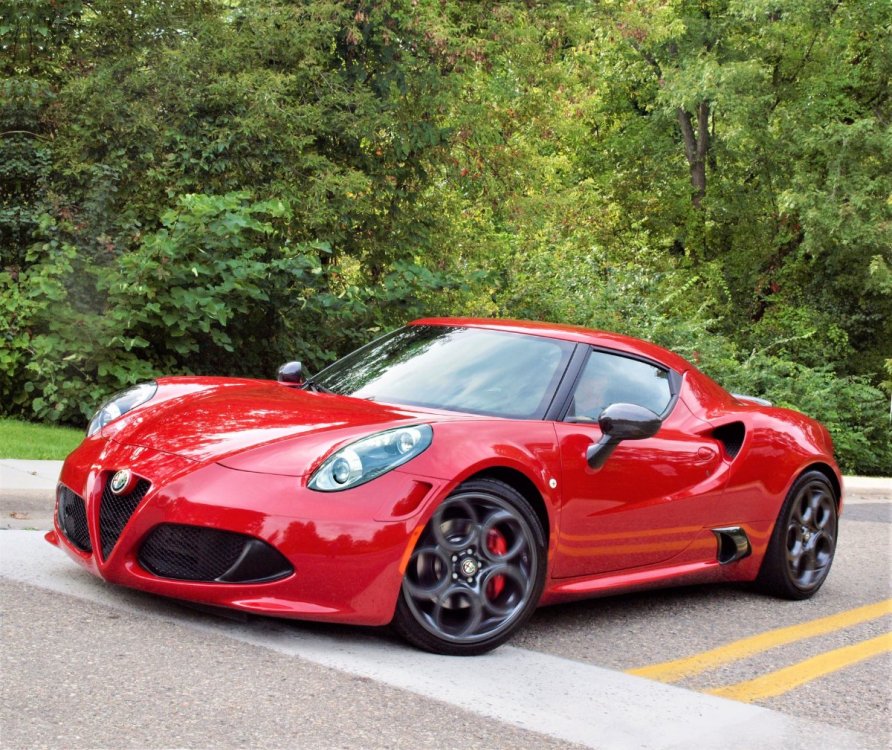

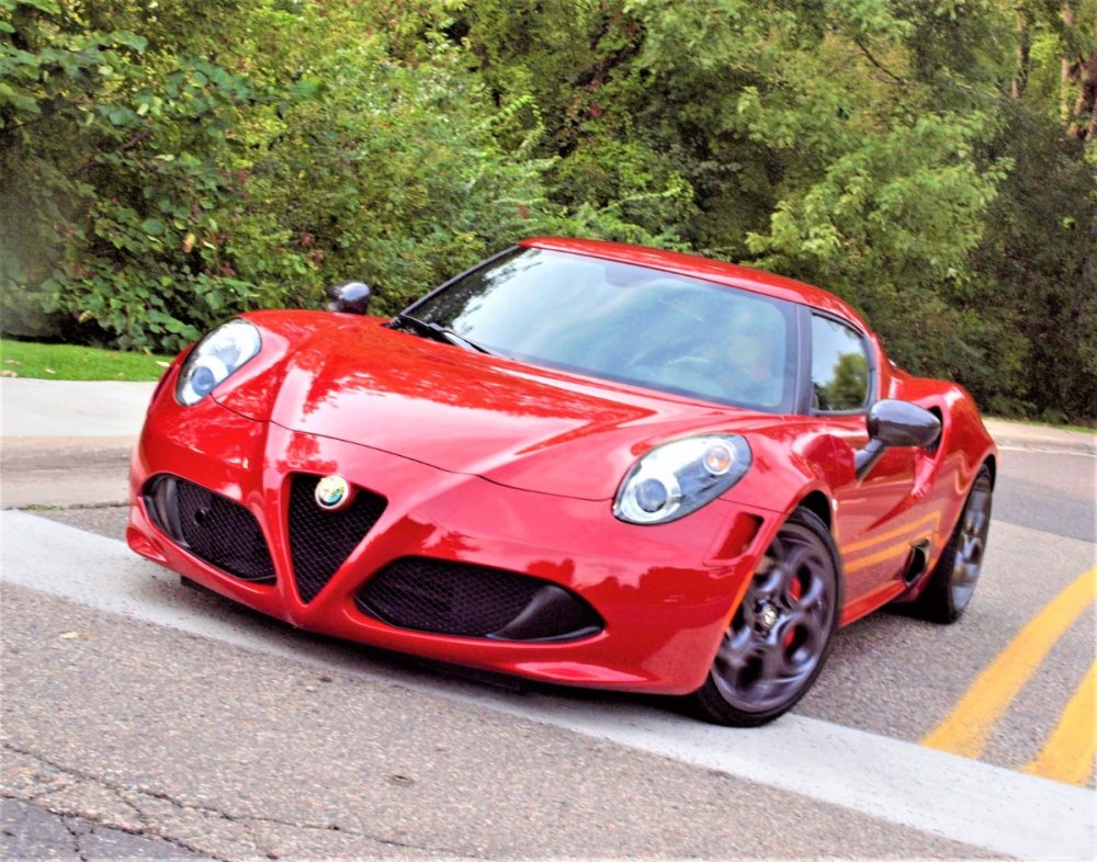

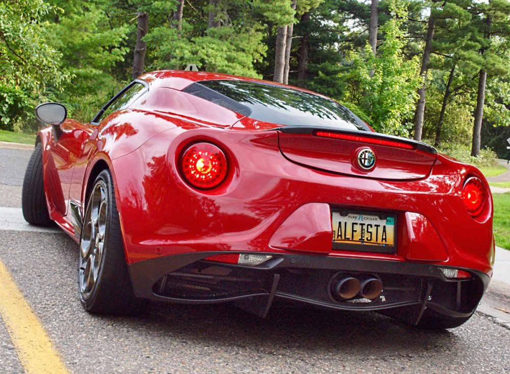

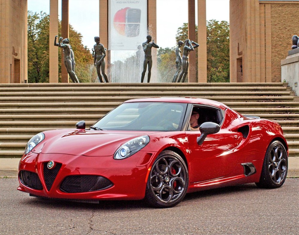

Thanks for the insights, @mrmustang.  I haven't received any notices regarding this thread in about a month.  That is a shame, because this thread has been so interesting and so much fun.  Therefore, I will introduce for consideration another vehicle:  My 2015 Alfa Romeo 4C Launch Edition.
This car has received a full Stage III power and handling upgrades.  Stage III ECU plus a larger Garrett air-to-air intercooler and larger, smoother, non-collapsible silicone intake tubes and airbox.  Larger air filter and Brisk racing plugs.  Exhaust is 1/4" wider with one muffler deleted and thus a shorter run, and the new Scara73 cat is substantially wider with only 200 larger cells.  Stouter anti-sway bars were fitted, and a semi-solid motor mount.  4C Suspension Blocks were added to the front suspension, which permits more camber and finer adjustments.  The rubber rear suspension bushings were exchanged for stouter nylon versions.  Tires were upgraded to larger Bridgestone Potenza RE-71 R's, 215 x 40 front and 245 x 35 rears.  For appearance and greater stability in crosswinds, I added wheel and hub-centric billet aluminum wheel spacers, 1/2" front and 1" rear (no rubbing).  The final step was replacement of the stock coilovers with an excellent Nitron 2-way package which significantly improved handling,  in part by reducing weight by 8 pounds per corner.  The car also sits about 1/2" lower now.  The results?  I wrote the following description for an article in "Alfa Owner" magazine:
The Results
Everything affects everything else in complex projects like this, so it is not possible to fully define improvements provided by any single 4C upgrade.  But if you think of an IC engine as an air pump, my Stage III motor now pumps a lot more air a whole lot faster.  The engine spools much quicker now, as if I’d removed the flywheel.  When pushed hard in race mode, the car accelerates through gears with manic intensity, and I have difficulty pulling paddles fast enough to prevent rev limiter intervention (after so many years of saying “Put it away”, I’m the one who needs more video game experience).  Instead of leaning and squealing, the car remains flat, oversteering at the limit and correcting with a stab of the superpower switch (AKA the throttle).  Gator teeth at some tracks, including my native Waterford, have unsettled several cars I’ve driven, but not this 4C:  Tires follow pavement as though quantum entangled.  When challengers finally catch up, the uninitiated want to know the size of my V8:  When apprised of the 1.7 liter capacity of the car’s I4, various states of wordless catatonia ensue.
My 4C is earthy, close to the ground, full of pregnant scoops and breast-like fenders.  She got her sultry supercar silhouette from the sheet metal sex hustlers at Centrostile.  Since Imperial Rome, Italians have been deficient at war-winning, but weaknesses often induce compensatory strengths, and Italians create cars that seduce like Sophia Loren in her prime.  The beating heart of this 4C is everywhere:  In the air, in the wheel, in your seat, in the pedals, just like it was in your chest the first time you fell in love.  And, yes, Roberto, when you lay on her throttle, the earth does move.  I am thrilled and privileged to own and drive this timeless exotic.  I said it earlier, and it bears reiteration:  My name is Bruce, and I’m an Alfaholic.
Images:

at first I just thought you were waxing elegant--But then I saw the pictures. You sir are leading The Life. Now I envy you for 2 of your cars. It is good to see one spending his money wisely.
I apologize for inspiring envy of any sort.  An outlaw Miata which has dirtied the owner's hands for years can provide just as much fun, and instill the same justifiable pride of ownership.  By sharing the development details of my cars, I hope only to inspire fruitful conversation, and perhaps help others navigate their upgrade path.  Not every change is an upgrade.  I had to perform months of research to separate the good from the bad, with all three of my cars.  As I explained to Bill S (@mrmustang), I performed little of the actual work (except during Covid), but I am responsible for all of the research.  I wish I could have laid hands on more often, as it bonds an owner to his car in special ways.  Every time I see that seat-mounted extinguisher in my Porsche 935, I am reminded that I modified it to fit, and installed it.  Every time I adjust the driver's seat, I am reminded that I rebuilt the Brey-Krause slider system.  Those unique connections provide a special satisfaction every time the key is turned.  I would like to hear more from other owners regarding their ownership journeys.
In the words of Gretta Thunberg with a 'Jersey accent, "HoouudaaaUUU"! Oh, the humanity! All I see is high maintenance, like a abnormally pretty girl. Gimmie a fatty. They are grateful and can protect me from antifa. Plus, I can do whatever I want as long as it's ok with them.
