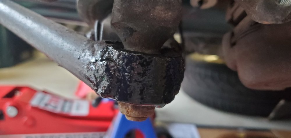

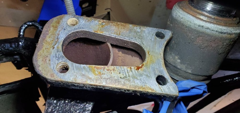

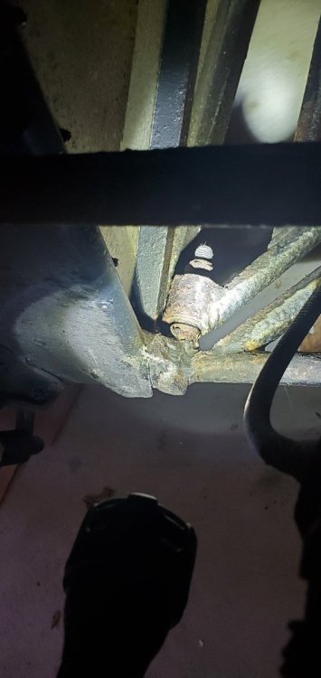

slowdude Posted January 8, 2023 Author Posted January 8, 2023 (edited) Topic one: Frame mounts and rust. After the drive from the port of NJ, I threw it up on jack stands in my garage and noted some gunk on the rear frame mounts. Being ever cautious, I grabbed a wire wheel and some POR15.. thankfully a lot of the crud in the first picture was just that, crud. In the second photo, I was able to find good metal underneath.. which is a huge sigh of relief. My plans to track this car would result in a bigger amount of work to be done. So far I am cautiously optimistic! Goal is to get the rear suspension pieces and brakes and then start replacing bits. Edited January 8, 2023 by slowdude
MV8 Posted January 8, 2023 Posted January 8, 2023 I can't tell how bad a shape it is in assembled. For now, I suggest pulling the bolts to check the condition of the bolt shank and hardware between the frame and arm, remove the rust you can access with an abrasive wheel made for removing rust, replace the hardware if corroded, and brush on rustoleum heavily rusted metal primer instead of por15. You can save por for when the parts have been fully restored. Use wheel bearing grease on the bolt shank to protect and prevent seizing to the bush liner. Good hardware can be found from mcmaster, ebay, or even a home improvement store depending on what is needed. Generally grade 5 for SAE or 10.9 for metric. 1
slowdude Posted January 8, 2023 Author Posted January 8, 2023 27 minutes ago, MV8 said: I can't tell how bad a shape it is in assembled. For now, I suggest pulling the bolts to check the condition of the bolt shank and hardware between the frame and arm, remove the rust you can access with an abrasive wheel made for removing rust, replace the hardware if corroded, and brush on rustoleum heavily rusted metal primer instead of por15. You can save por for when the parts have been fully restored. Use wheel bearing grease on the bolt shank to protect and prevent seizing to the bush liner. Good hardware can be found from mcmaster, ebay, or even a home improvement store depending on what is needed. Generally grade 5 for SAE or 10.9 for metric. Absolutely agreed. I'm waiting for confirmation on my suspension order and will pull everything then clean and POR. Thank you for the heads up on the grease. Just a light coating you think?

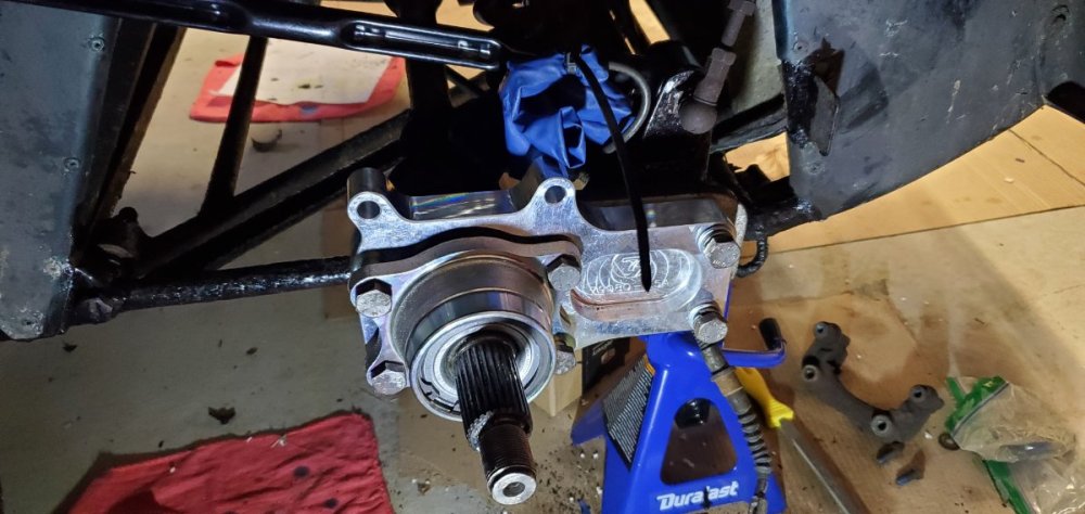

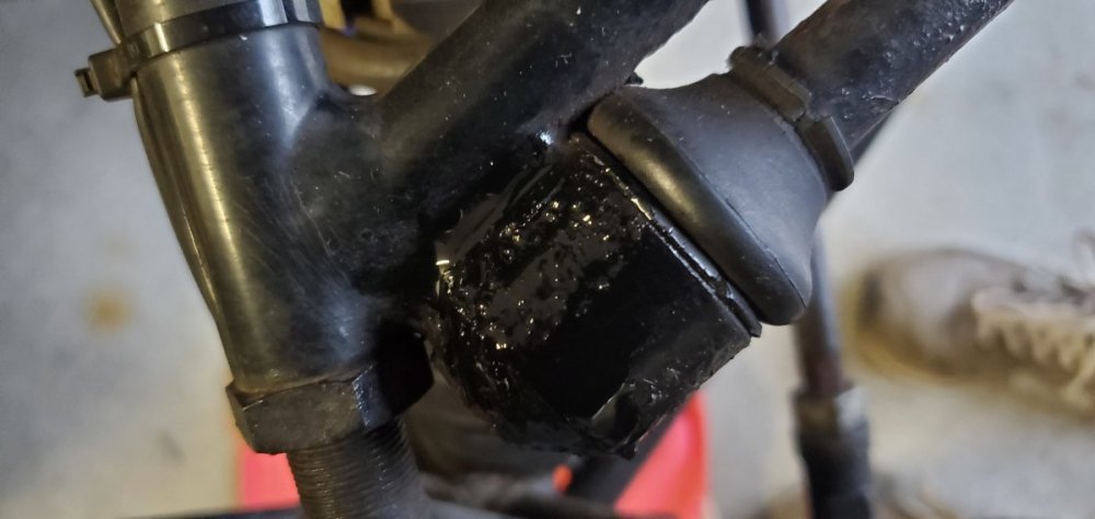

slowdude Posted March 27, 2023 Author Posted March 27, 2023 And another update. Needed to setup the garage with some integral items. HF bench grinder with brass wheel has helped take a lot of surface rust off old bolts. Today I was able to get the old ear off + bearing and fit brakes / hub / bearings/ de dion ear. Thankfully the inside of the de dion tube was nice and clean... no evidence of water. Some sealant for around the de dion ears should keep it that way. A-arm needs total replacement. Gunked the bolt over for now and will use encapsulator when ready to replace A arm. Currently waiting on machine shop to put helicoil in the one bad hub, and on a thin 15mm wrench to put pads in. Getting much closer!

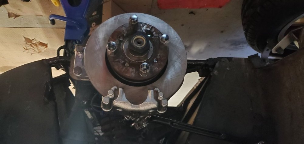

slowdude Posted April 28, 2023 Author Posted April 28, 2023 And big update. Rear calipers/pads/radius arms /dedion ears all replaced and torqued. New axle nuts done as well. Rust proofed as much of the chassis rails as I could, then coated with por-15 or encapsulator. Front hubs were salvaged with new threads, plus new bearings packed in the hubs. Front calipers froze immediately after getting off the car, so will be rebuilt for the winter. Put a replacement pair of spitfire calipers on from moss. Did a big bleed session and have put about 100 miles on it since finishing this work on Tuesday. I put new bolts / washers / nuts to replace the old seat bolts which were 4 different types of bolts/ washers, plus a new SFI Schroth harness. Thank you to everyone who offered advice and guidance. I truly appreciate the community and hope I can give back in the future. The only outstanding items now are: A-arm replacement Radiator replacement (original from 1994) Valve tappets (super noisy and a bit of a concern it could lead to oil loss. Better to be preventative on this, but this is outside of my capabilities. I drove it to work- you can barely see the rollbar above the hood of an X3 or X4. Very similar to driving a motorcycle, no one sees you or understands what you're able to do.

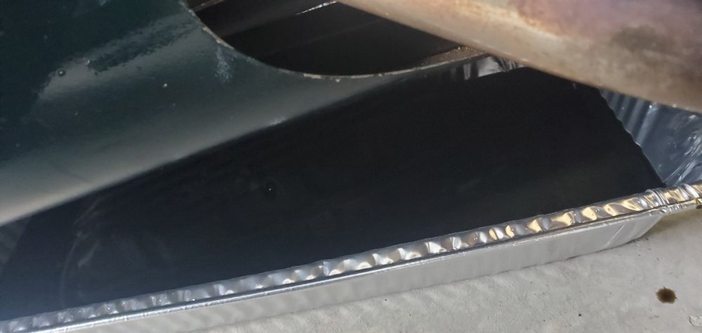

slowdude Posted April 30, 2023 Author Posted April 30, 2023 And oil in. 4.5 or so liters. 2.6L came out (filled out my OJ jug) hmmm.
slowdude Posted April 30, 2023 Author Posted April 30, 2023 (edited) It sounds slightly better as it warmed up. Oil pump? Is quieter too. I find the fact I took half out as much as I put in interesting as the dipstick had been showing it was sufficient. Either way, I'll run it for a bit and do another flush and new filter. Edited April 30, 2023 by slowdude 1
MV8 Posted April 30, 2023 Posted April 30, 2023 Sounds like a good plan. I couldn't see the first vid on utube, but the last one sounds fine. Monitor oil pressure with the current oil and after changing to the appropriate oil. If it starts falling off for what is normal for the rpm, change the filter again as soon as possible as it may be clogging and bypassing. I've gone through several filters when flushing an engine within a hundred miles before changing to regular oil, then two or three by the next oil change. That is odd about the oil level check. I check oil after an engine has been off for 5 minutes or more, wipe the stick, reinsert, then pull and use the lowest mark indicated no matter which side of the stick it's on. 1
