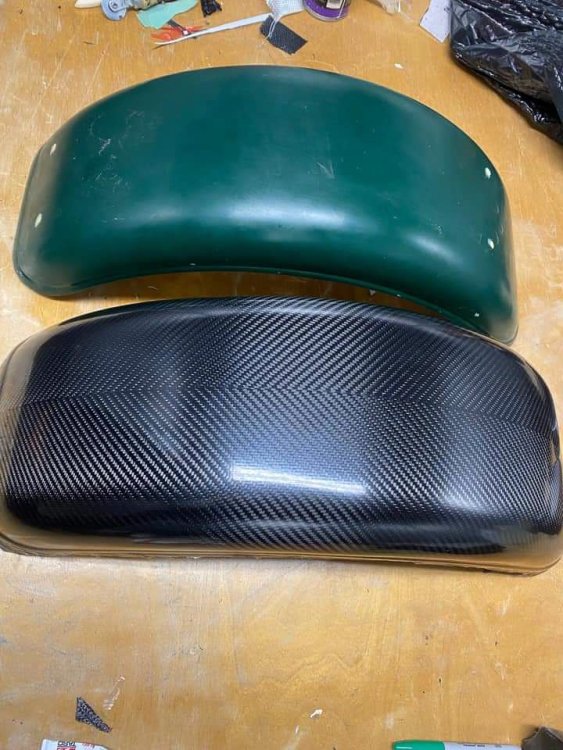

Ted7 Posted February 18, 2023 Share Posted February 18, 2023 (edited) Since cycle wings at Caterham Cars is back ordered and Westermann was a big disappointment, I had one of my client having them done for me from scratch. Edited February 18, 2023 by Ted7 Link to comment Share on other sites More sharing options...
Vovchandr Posted February 18, 2023 Share Posted February 18, 2023 (edited) Was it as pictured? I had mixed feelings with my westermann experiences Edited February 18, 2023 by Vovchandr Link to comment Share on other sites More sharing options...
Ted7 Posted February 18, 2023 Author Share Posted February 18, 2023 6 minutes ago, Vovchandr said: Was it as pictured? I had mixed feelings with my westermann experiences The one on top is my stock one, they needed to make the mold for the carbon fiber. Westermann was terrible imho Link to comment Share on other sites More sharing options...
Nick OTeen Posted February 19, 2023 Share Posted February 19, 2023 That new C/F fender looks fantastic. I particularly like the book match of the fabric. I've always wanted a set for my Caterham that are several inches longer (along the arc) such that they would cover more of the tread overall (something similar to the cycle wings in the photo below). I'd like to talk with your client about working up a pair such as those. Link to comment Share on other sites More sharing options...

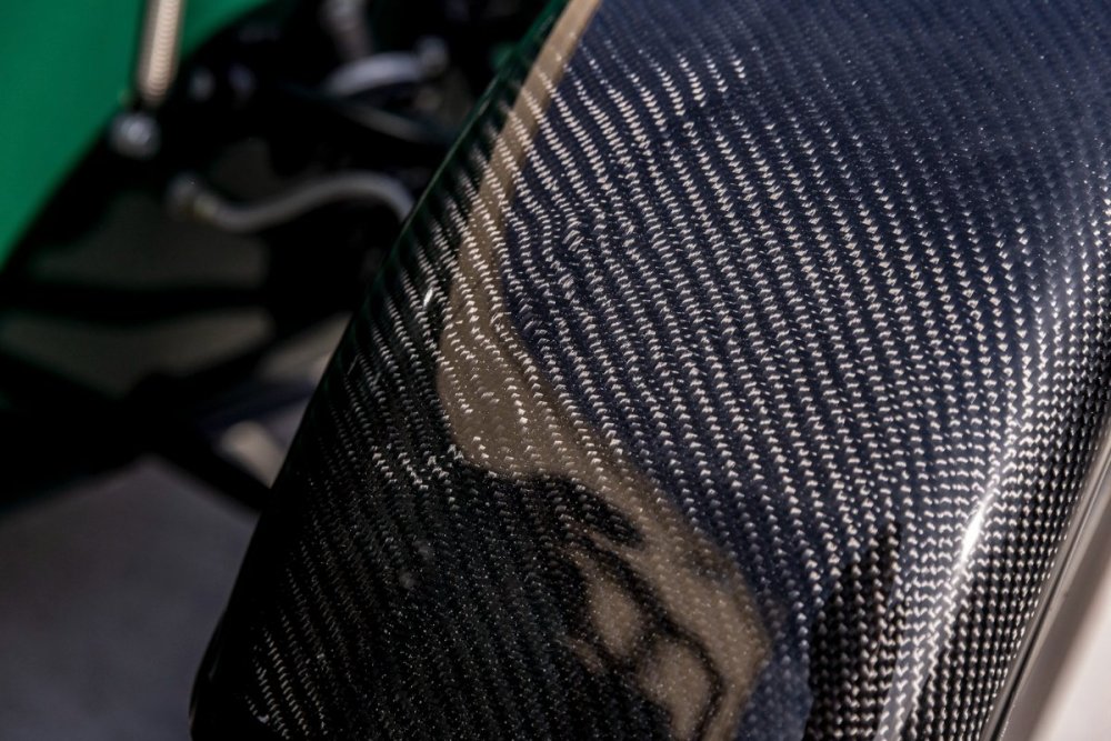

Ferrino Posted February 19, 2023 Share Posted February 19, 2023 Interested to hear the bad experiences with Westermann, since they charge a real premium for their products. Myself, I had a terrible experience with them about 18 years ago - not concerning the quality of the product, but rather some aggressive behavior from them when a shipping delivery went wrong. Link to comment Share on other sites More sharing options...
Ted7 Posted February 19, 2023 Author Share Posted February 19, 2023 6 minutes ago, Ferrino said: Interested to hear the bad experiences with Westermann, since they charge a real premium for their products. Myself, I had a terrible experience with them about 18 years ago - not concerning the quality of the product, but rather some aggressive behavior from them when a shipping delivery went wrong. Not really crazy about that carbon fiber work from Westermann... I just wish I saw them before I had them installed. Link to comment Share on other sites More sharing options...
MV8 Posted February 19, 2023 Share Posted February 19, 2023 (edited) 9 hours ago, Nick OTeen said: That new C/F fender looks fantastic. I particularly like the book match of the fabric. I've always wanted a set for my Caterham that are several inches longer (along the arc) such that they would cover more of the tread overall (something similar to the cycle wings in the photo below). I'd like to talk with your client about working up a pair such as those. Those look like the perfect cycle fender (if you don't care about an aero hump off the back -I don't). You'd need fenders to copy in carbon. They could copy two sets of your original fenders, then trim and glass those to make one for each side in the length you want, then cast the prototypes in carbon. Keep the molds. Edited February 19, 2023 by MV8 Link to comment Share on other sites More sharing options...
ianashdown Posted February 21, 2023 Share Posted February 21, 2023 Being in the Carbon Fiber business, and in the same area as the OP, I have to wonder who made these. I expect I know them. They are very nice indeed. The Westerman parts are fairly typical of either wet laid-up or infused parts. The dry cloth is very slippery and difficult to keep the twill lines straight. Ian Link to comment Share on other sites More sharing options...
Ted7 Posted February 22, 2023 Author Share Posted February 22, 2023 On 2/20/2023 at 6:55 PM, ianashdown said: Being in the Carbon Fiber business, and in the same area as the OP, I have to wonder who made these. I expect I know them. His name is Josh, from Lange Customz Link to comment Share on other sites More sharing options...
