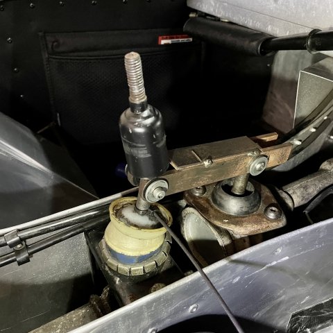

My tunnel and links will look exactly like this, even ghd OPs car is same year as mine.
Only difference is he has ths T9 installed with a bespoke connector link.  Abd he's RHD.238C3578-5206-4233-B1F4-D64004641245.jpeg.98c4dd34efce05cda95b69fbde354f2f.jpeg
