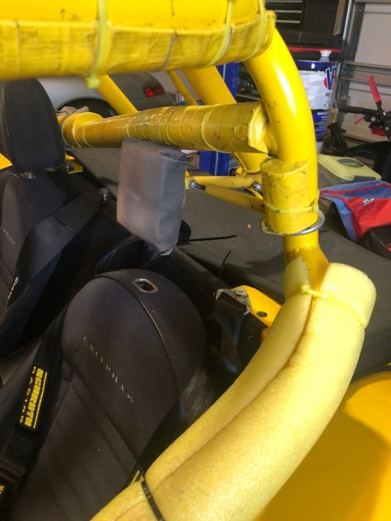

My car has the adjustable seats and 4 point belts.  As I've gotten the car back on the road I've been thinking that 4 point belts are already not optimal but without headrests are probably dangerous.  Does anyone make a reasonable read rest that mounts to the roll bar?  I guess I could get some new seats but the prices are a bit intimidating.  Any one else deal with this?

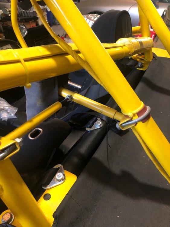

It's got the 80's adjustable seats with no head rests.  Street roll bar.
If you want to see anything specific let me know.
I'd actually be willing to consider newer seats if there are any reasonable options.

Head rests can be made that attach to the seat backs or the firewall or a vertically adjustable bolt-in cross bar that can be padded or have a mount for a head rest. Your upholsterer can cover the final design. A side view of where the cushion needs to be at the same height and pics of the seat back and firewall could provide some ideas.
Another option is to use seats using trimmed to width, existing seats with head rests. Remove the tracks if too high, section the steel frame as needed (welding), cut the seat foam to fit the narrowed frames, then have your upholsterer recover. The seat frame could be narrowed to clear an seat back adjuster on the side but would your rear still fit in the middle? I doubt mine would. Look at basic seats for fiero, miata, dodge neon, chevy cobalt, etc.
If you want seats and no arts and craft work, look at the Cobra offerings. Measure the width of the space for an overall seat max width.
