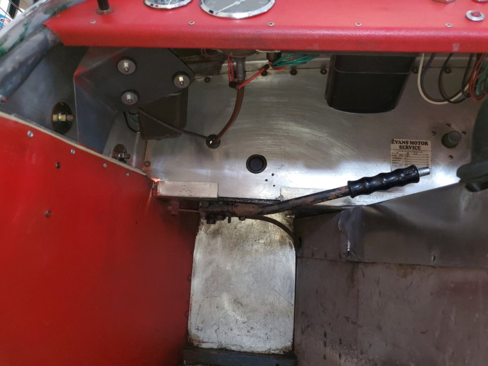

SENC Posted June 12, 2023 Posted June 12, 2023 (edited) Grabbed a couple pictures while st the shop... Handbrake from below - no obvious markings but may help you establish if yours might work. As you'll see (and someone noted previously), in the Seven the inner cable is anchored to the chassis and the outer sheath is what is moved back and forth. And my tachometer - correct for 1965 and positive earth, not sure whether it was different in earlier S2s. Edited June 12, 2023 by SENC 1

ianashdown Posted June 12, 2023 Author Posted June 12, 2023 (edited) On 6/12/2023 at 5:52 PM, SENC said: Grabbed a couple pictures while st the shop... Handbrake from below - no obvious markings but may help you establish if yours might work. As you'll see (and someone noted previously), in the Seven the inner cable is anchored to the chassis and the outer sheath is what is moved back and forth. Expand I don't think mine is going to work, even with modifications. I have the correct lugs etc on the underside of the frame so I'll just have to go on the hunt for the right part. Fortunately I have a year or so to find one! Also, I appreciate the pic of the correct Tach! I think that may not be too difficult a find. Ian On 6/12/2023 at 5:52 PM, SENC said: Expand Edited June 12, 2023 by ianashdown
