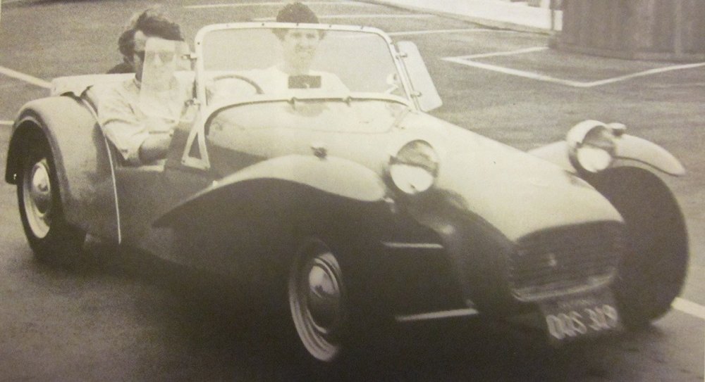

jbcollier Posted September 11, 2023 Posted September 11, 2023 Here’s the original bracket for a 69 S3: 1
MV8 Posted September 11, 2023 Posted September 11, 2023 (edited) The original type tag mount can also lay the tag back at about 45 degrees like a scoop that doesn't block the nose opening, but it may have just been bent back to that angle in the 1970 article showing the mount. Maybe JB will show the attachment underneath? Edited September 11, 2023 by MV8

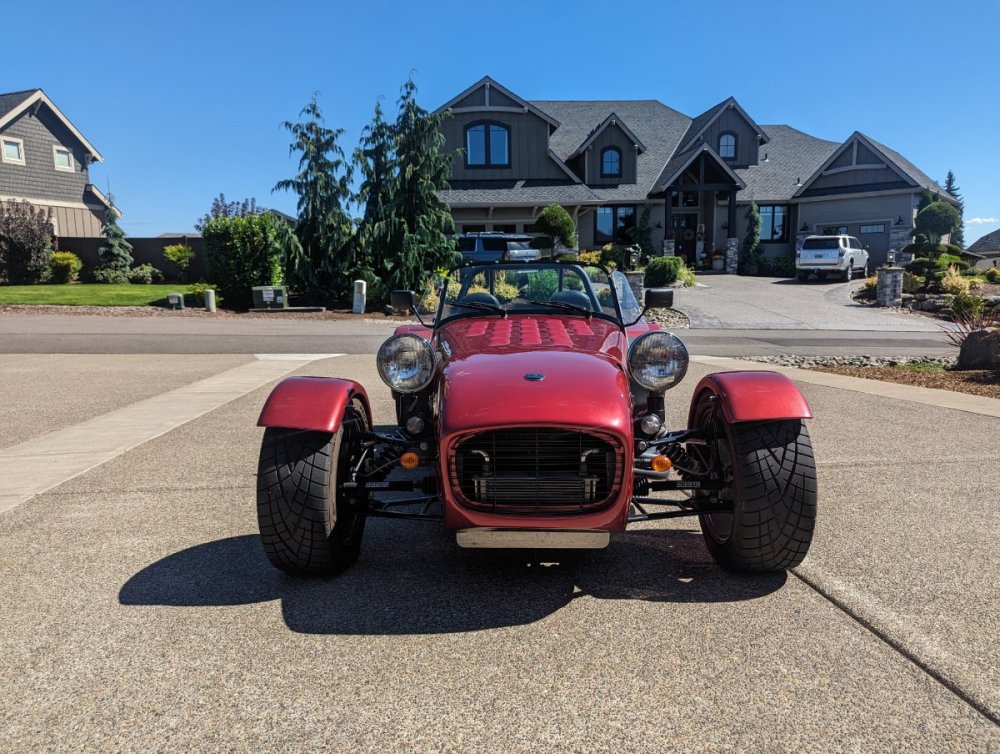

Cueball1 Posted September 13, 2023 Author Posted September 13, 2023 @Jesse DUnfortunately to the side will block the turn signal on that side. On my birkin it's mounted low. You can also see in this pic an aluminum plate across the bottom side of the nosecone. Looks like my solution will be something like the last couple old school pics with the plate laid back some, mounted to that. Good news is they did title it through replica rules as a 1964 vehicle. No deq test needed! 1
