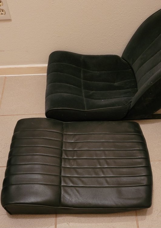

IamScotticus Posted October 25, 2023 Posted October 25, 2023 (edited) Those BDR seats are much taller than the old bench squabs. I can do a side x side picture in a little while. Those BDR seats should be on sliding rails, adding another inch. It may be possible to fasten without the rails? It could be argued that the height is close in the very rear. But I suspect the BDRs bucket form, not made for adults, will push a person up higher than a flat squab. This velour BDR seat with rails is 22 Lbs. Edited October 25, 2023 by IamScotticus
Wayne Stambaugh Posted October 25, 2023 Author Posted October 25, 2023 Someone asked for pictures with the nose removed and I have attach a few. Tonight I jacked the car up and put it on stands. When I saw how the floor pans were installed by pull rivets I quickly understood how the floor area could be lowered. I took the seat out of the car and jumped in with no seat. I needed about two and a half inches behind my back which is probably about the thickness of the seat’s backrest. Obviously I sat about 3” lower due to no seat cushion and no adjusting rails. This position totally relieved the interference between my left knee an the steering wheel. I jumped back out and took my boots off and got back in the car. It was much easier to feel the pedals and to be sure I wasn’t pushing the brake while I was trying to push the clutch. With only my socks on I pushed the clutch pedal to the floor. It takes a lot of pressure to push the clutch down. Matter of fact it hurt my left foot so bad I could only push it down 3 times. This is a cable clutch and not hydraulic. Is this standard on all Caterhams? If this clutch is as good as it gets I’m going to have to install a steel plate in my left shoe in order to drive it. 1
