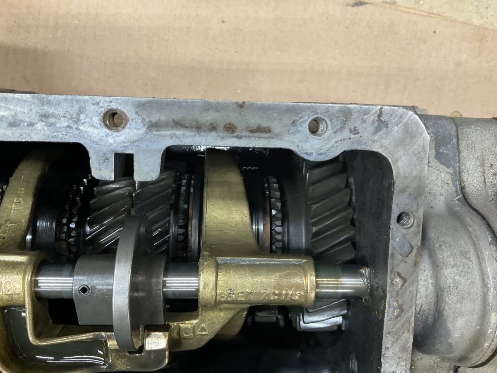

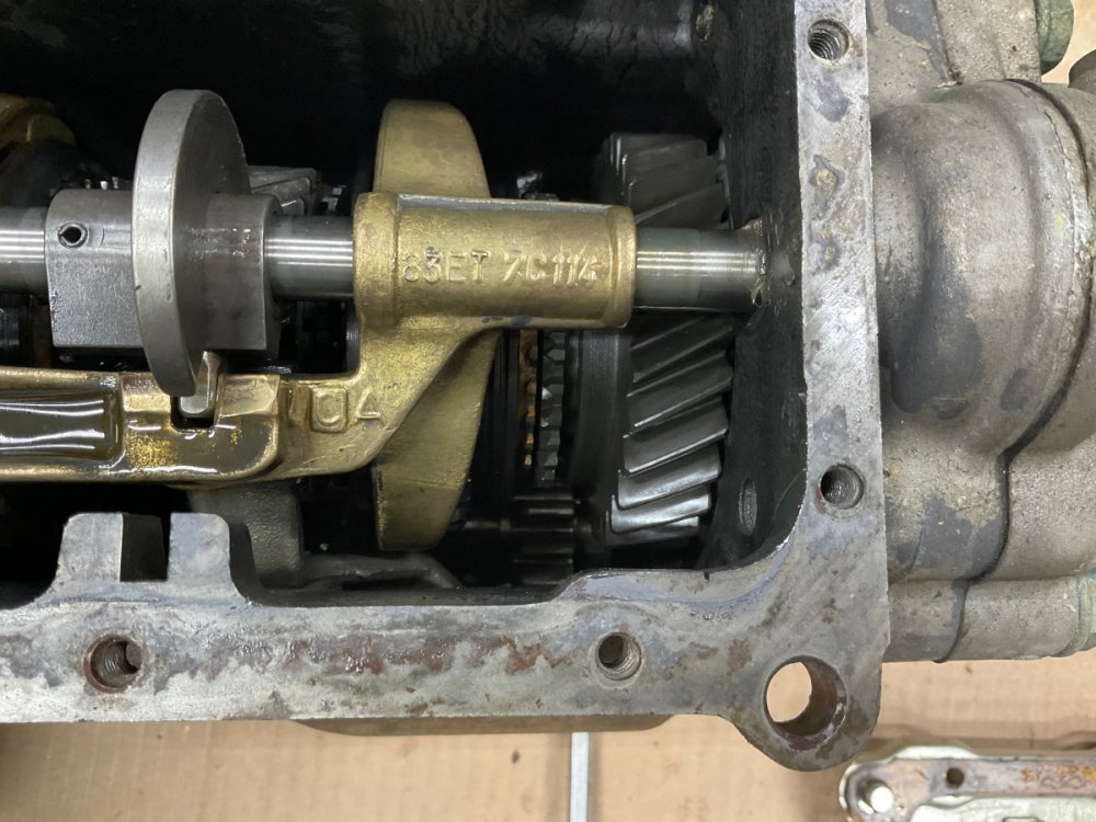

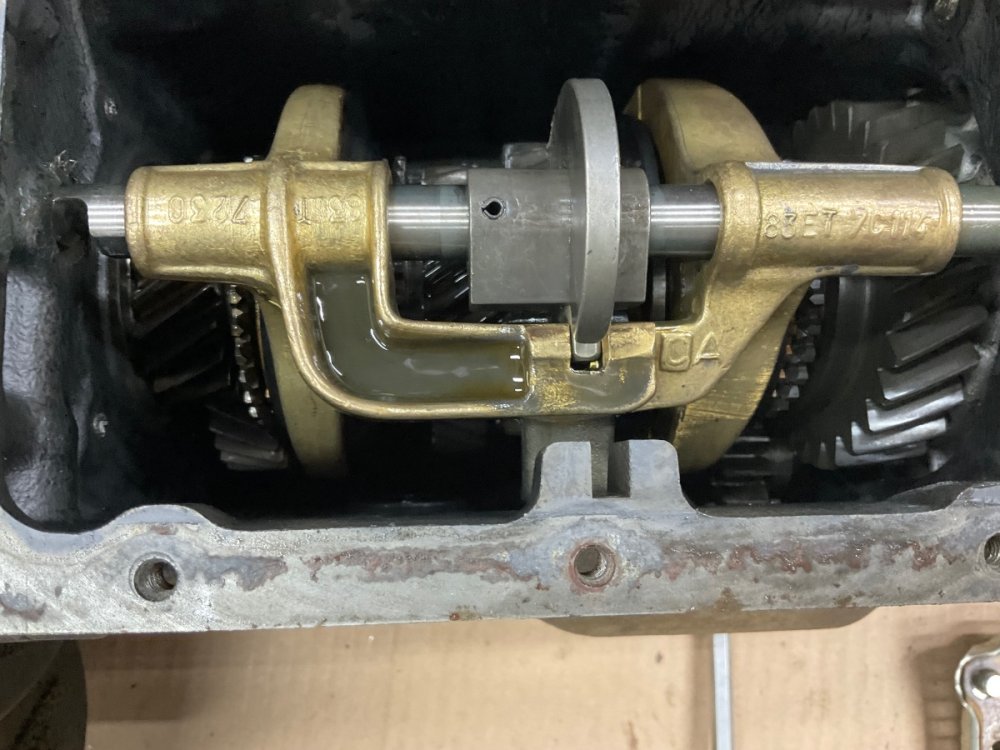

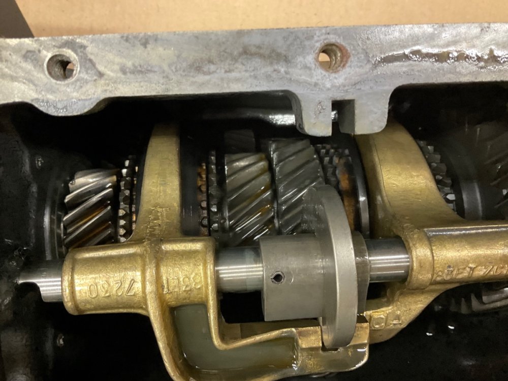

Wayne Stambaugh Posted November 6, 2023 Author Posted November 6, 2023 Forgive my ignorance while navagating this forum. I really don’t understand everything I need to know yet. Minutes ago I separated my engine and transmission. I reinstalled the shifter and the transmission is still stuck. I removed the top cover and the transmission even looks like its only got 31 miles on it. I am not familiar with this T9 Ford 5 speed. I have never been inside one before. I have attached a couple pictures so you can see how clean it is. I think this my be the reason the project was halted. If John jambed the transmission and couldn’t get it to move he may not have had the courage to tell anyone and he put the car in the corner and covered it up. He may have just not had the horse power to pull the engine and transmission, fix it and reinstall it. I’ll see what kind of manuals I can find on the T9 and try to work throught it. I have done MGA, MGB, Ford Model and and Ford Flathead V8 transmissions but never a 5 speed. Ford’s transmissions were almost all about the same from 1928 to 1952, then everything changed.

MV8 Posted November 6, 2023 Posted November 6, 2023 I suspect you are in 5th or reverse since 1-2 and 3-4 are in neutral. Rotate the input shaft and watch the output to determine what gear it is in. There is a plunge action at the shifter to defeat the reverse lockout to engage (lump inside hole aligns with notch in side of shifter shaft). Some more info: https://usa7s.net/ips/topic/14314-gear-shifter-biased-to-5th-gear/page/2/

Wayne Stambaugh Posted November 6, 2023 Author Posted November 6, 2023 59 minutes ago, MV8 said: I suspect you are in 5th or reverse since 1-2 and 3-4 are in neutral. Rotate the input shaft and watch the output to determine what gear it is in. There is a plunge action at the shifter to defeat the reverse lockout to engage (lump inside hole aligns with notch in side of shifter shaft). Some more info: https://usa7s.net/ips/topic/14314-gear-shifter-biased-to-5th-gear/page/2/ It’s doubtful that I’ll be able to get it on the bench tonight to do a closer investigation but I will see if I can determine what gear it’s in and with the help of the information here try to figure out what is wrong. I have never experienced this with a manual transmission before. I sure hope it’s not characteristic of the T9 Sierra and I seriously doubt that it is. Thanks MV8 for the link above, I’ll check it out. For the sake of saving time, if this turns into a complete tear down I would be interested in finding a reliable shop to get it done quickly. MV8 for the link.
