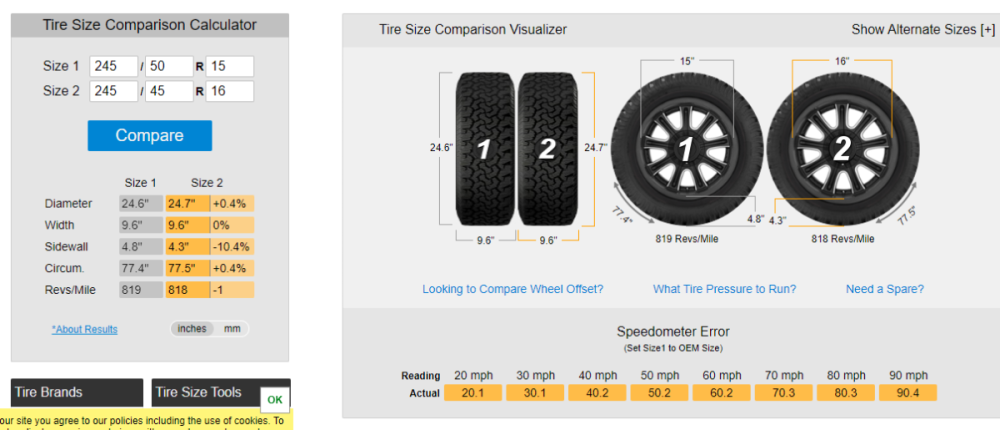

Smithengineered Posted November 7, 2023 Author Posted November 7, 2023 Wouldn’t a 45 series tire on a 16” rim be equivalent to a 50 on a 15” rim?
Vovchandr Posted November 7, 2023 Posted November 7, 2023 40 minutes ago, Smithengineered said: Wouldn’t a 45 series tire on a 16” rim be equivalent to a 50 on a 15” rim? https://tiresize.com/comparison/ If the width is the same, then yes its essentially identical
MV8 Posted November 7, 2023 Posted November 7, 2023 (edited) 1 hour ago, Smithengineered said: Wouldn’t a 45 series tire on a 16” rim be equivalent to a 50 on a 15” rim? No. In this case, it is only a couple mph faster than indicated (varies with speed), but this assumes the speedo was corrected for the tires you have now. Edited November 7, 2023 by MV8 1
Smithengineered Posted November 7, 2023 Author Posted November 7, 2023 1 hour ago, Vovchandr said: https://tiresize.com/comparison/ If the width is the same, then yes its essentially identical Thanks for the link! Appears that it is .6” taller.
