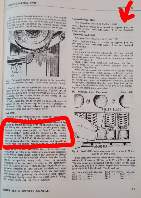

SENC Posted November 19, 2023 Posted November 19, 2023 I'll have tonight back through my notes and files, but my memory is that the two "pointers" on the cover are 8 and 10 degrees. In the downloads "Lotus 7" section are copies of the Lotus 7 manual, a Ford 105E manual, and an article on the Cosworth evolutions. The Ford manual shows the markings, but it may have been somewhere else I saw the description. The Lotus manual and article describes various initial intended timings. It looks like you have a Cosworth cover, so perhaps you also have a Cosworth head. They did make them for both 105E and 116E engines. How are you identifying this as a 116E head? 116E blocks, in my experience with Lotus, are most frequently marked 120E. Think of 105E and 116E as "classes" that can include several subgroups. It could be that yours was a Cosworth 116E engine where the block was replaced - or a 105E where the head was replaced - or maybe someone just added the Cosworth cover and new manifolds to allow the dual Webers. I can't see the manifolds well enough to tell if they look like the Cosworth manifolds. The unique engine number should be engraved on the top of the motor mount on the distributor side. With that and your vehicle ID number (SBxxxx or LSBxxxx) John Watson (Lotus Seven Registry) could tell you if the block is original and maybe more about original configuration.
SENC Posted November 19, 2023 Posted November 19, 2023 This from the Seven manual suggests that the gap between the 2 ridges is 10 degrees btdc. I also found the following in my files. Assuming this marking us how you identified your head, it may explain things as it appears the same 116e casting for the head was used on 1300cc blocks. I think this was related to Cortinas, but would support such a head on a 1300 lotus engine.

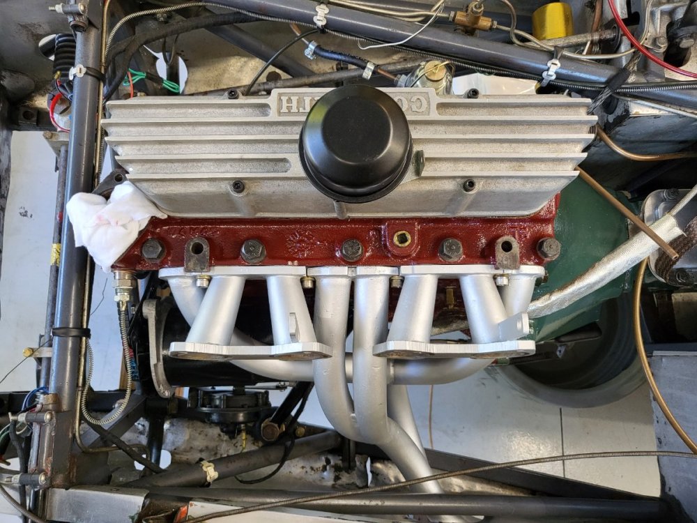

SENC Posted November 20, 2023 Posted November 20, 2023 (edited) Interesting, I have not seen one with the markings on top (not that I've seen a lot, so could be common). Attaching a picture of mine on rebuild, which also shows the intake manifolds - which I believe to be original/Cosworth manifolds. Yours look quite similar. On this one, like the diagram above, the 116e casting is on the bottom of the water inlet. Edited November 20, 2023 by SENC
Christopher smith Posted November 20, 2023 Posted November 20, 2023 Looks a lot like my 1500 5 main bearing type. Mine is early Cortina GT based ( rope seal type). 120E6015 now with a 2x40DCOE that looks similar except the intake is a welded fabrication instead of a casting.Looks like we all have similar fun with the correct special bolts and install sequence with those clamping the intake and header flanges. 1
SENC Posted November 20, 2023 Posted November 20, 2023 1 hour ago, Christopher smith said: Looks a lot like my 1500 5 main bearing type. Mine is early Cortina GT based ( rope seal type). 120E6015 now with a 2x40DCOE that looks similar except the intake is a welded fabrication instead of a casting.Looks like we all have similar fun with the correct special bolts and install sequence with those clamping the intake and header flanges. Indeed, they are a real bugger!
