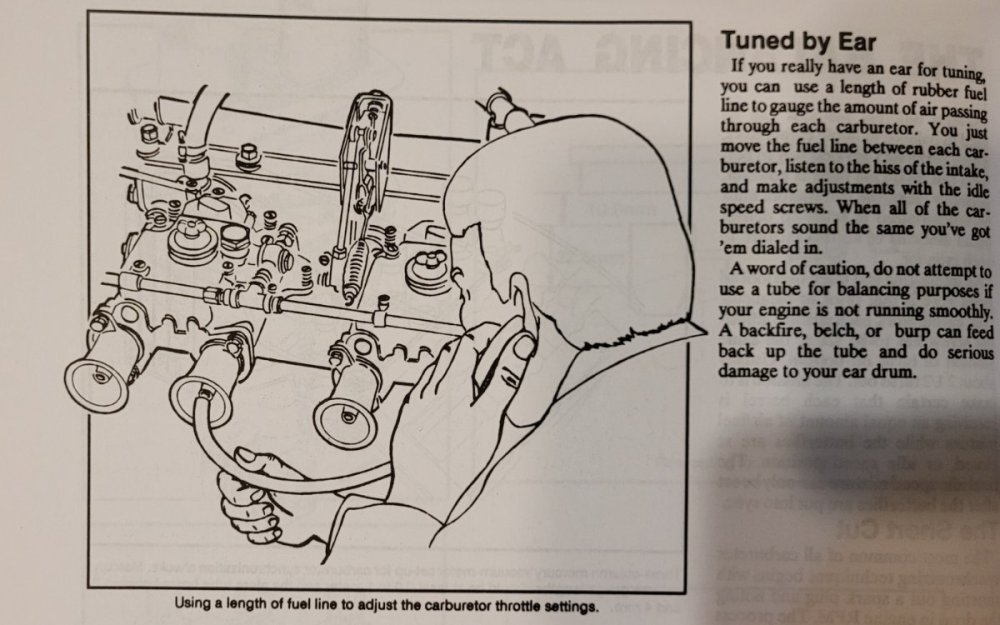

7Westfield Posted May 31, 2024 Posted May 31, 2024 19 minutes ago, TEM said: So I'm not sure a screwdriver will reach but will give it a try. try a chunk of tubing, like fuel hose
