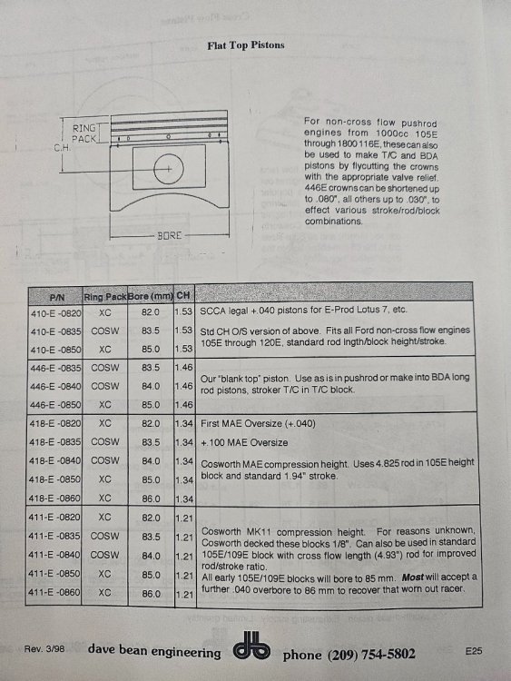

MV8 Posted July 24, 2024 Posted July 24, 2024 (edited) Those are aftermarket high compression pistons. They may not have been intended for this specific application. Not unusual. Edited July 24, 2024 by MV8
SENC Posted July 24, 2024 Posted July 24, 2024 (edited) 1 hour ago, TEM said: Thanks Senc, that would definitely explain my situation. I should have commented that I know my engine was rebuilt in the 70s/80s after a thrown rod, so the pistons that came out were not likely original (at least 1 one them). The following photos are pages from the DBE Elan/Plus2/Cortina catalog and DBE English Ford Racers catalog, respectively. I take them to suggest flat tops were standard for pre-crossflows. Edited July 24, 2024 by SENC
TEM Posted July 24, 2024 Author Posted July 24, 2024 Yes, that document specifically references the 1340cc Seven with flat top piston. The flat heads had a 10:1 compression ratio. I can't imagine what my engine is with the protrusion. possible cause of the head gasket failure?!
