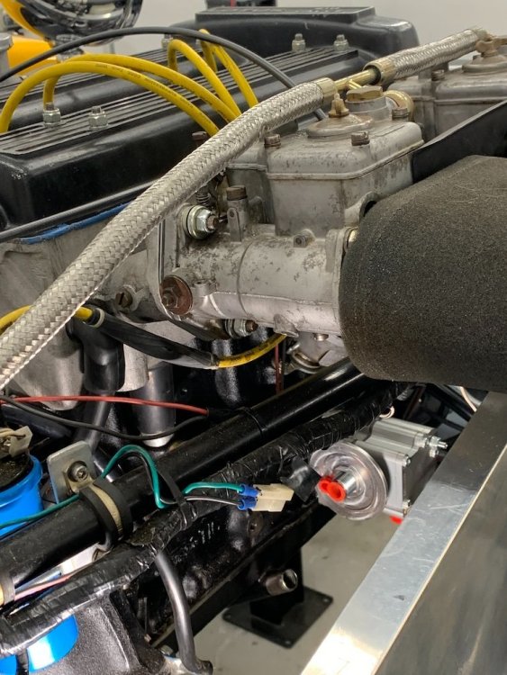

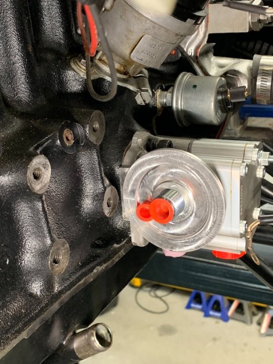

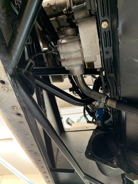

wdb Posted August 6, 2024 Posted August 6, 2024 (edited) (Starting a new thread so as not to junk up the other one) Does anyone know for certain if this is the motor mount bracket that will allow a dry sump oil pump with integrated filter to be used in a Caterham with a Ford Kent engine? https://caterhamparts.co.uk/engine-mounts/106-engine-mounting-bracket-ford-crossflow-dry-sump.html I've reached out to Caterham, here is their response: " Thank you for your e-mail. Yes, this was used on dry sump ford units and as you can see from the photo is angled to avoid hitting a few things. Regards" What I have not had any luck finding is an image or description of EXACTLY IN WHAT DIRECTION the integrated oil filter protrudes from the pump. The Burton pics for the Titan pump, and those on Pegasus for the FF pump, do not show the orientation of the unit on the side of the block. Pegasus says their pump won't fit a Caterham because of the engine mount bracket. Burton doesn't appear to like responding to requests for information; I've tried twice so far. The mount bracket I currently have is curved, in a manner very similar to the one pictured above. Here it is, with a dry sump oil pump in place. From below -- front of engine is to the right From the rear From the front Edited August 6, 2024 by wdb

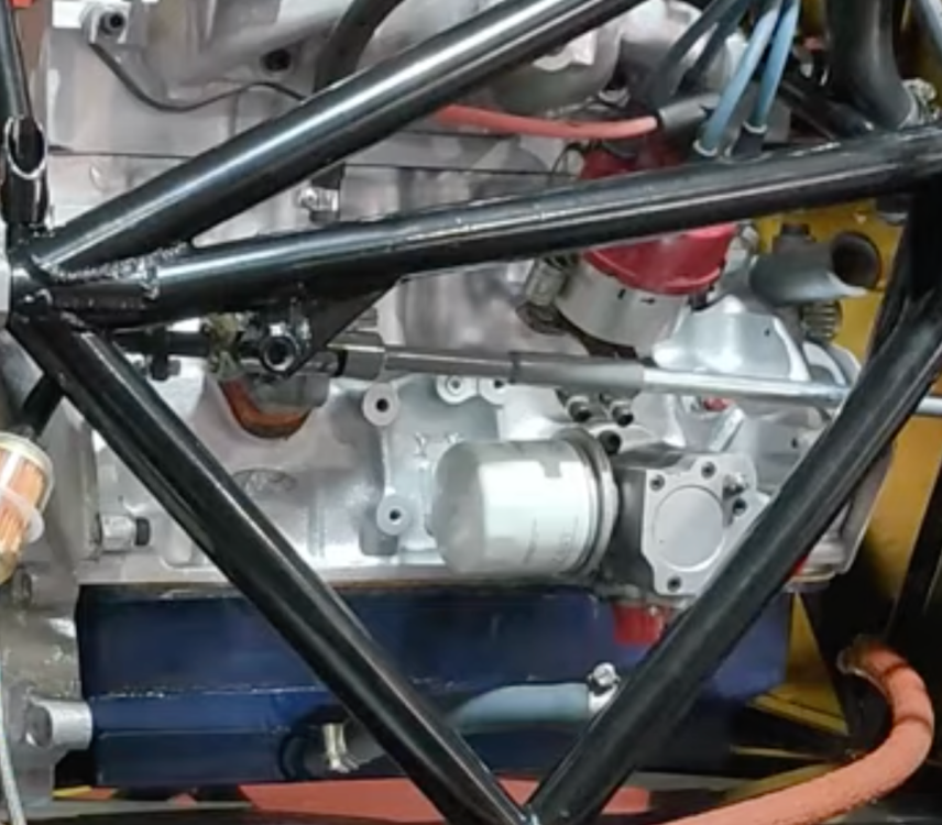

NSXguy Posted August 7, 2024 Posted August 7, 2024 By the way, attached is a picture of an integral filter on a FF type racer for reference. -Dez 1 1

wdb Posted August 7, 2024 Author Posted August 7, 2024 12 hours ago, NSXguy said: By the way, attached is a picture of an integral filter on a FF type racer for reference. -Dez This is exactly what I needed, thank you. Do you know whether that is the filter orientation for FF as well as Titan pumps?

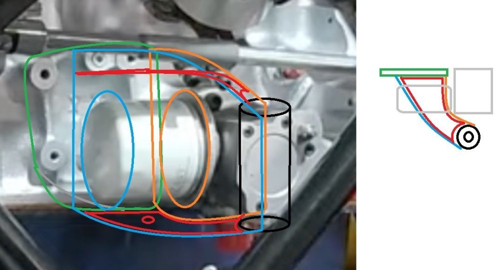

MV8 Posted August 7, 2024 Posted August 7, 2024 2 hours ago, wdb said: It might be possible, but I don't see it being very robust. There isn't much space between the two lower motor mount bolt holes and the oil filter. If it's been done I'm happy to be proven wrong! With pix pls thx. I can see how it can be done, and more robust than the typical mount, but I've not seen any examples. I can use mspaint to draw on the pics to show the general idea if you'd like. The base plate on the block is oversize, with the bottom edge near the pan rail and the upper higher as well, space permitting. The tube that attaches the mount to the chassis rubber is also longer by an inch or so with a longer bolt. Bent tubes would not be fitted, using 0.100-0.125" x 6" or so common steel strip/plate instead. The plates are parallel at the base plate as far apart as a socket on the mounting hardware will allow, are bent to fit without the filter in place, then boxed with strip along the top and bottom for a asymmetrical "dog leg" tube mount. The opening for the filter to fit through is then cut out with plasma (can't be cut when flat since it will be in the curve). A tube can be rolled to fit the opening for the filter but I don't think it would be needed.

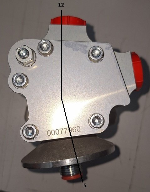

wdb Posted August 12, 2024 Author Posted August 12, 2024 Eureka! Burton Power finally got back to me. According to them the Titan dry sump oil pump orients the oil filter at approximately the same angle as the original oil pump, which means I only need to be concerned about clearance for the additional scavenging stage of the pump. I believe the mount bracket I have does just that. Woohoo! Per the response from Burton Power: "When viewed from the side of the block, the oil filter is approximately at the 5 o'clock position as picture attached."

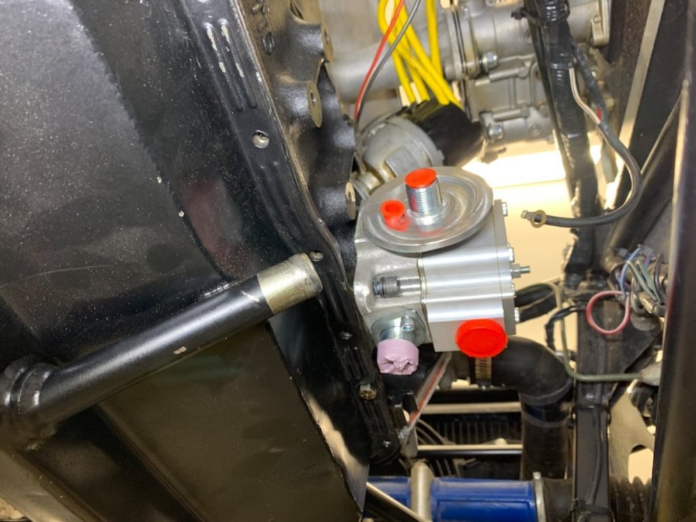

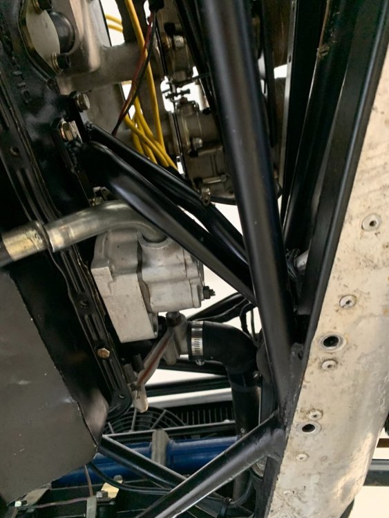

wdb Posted August 24, 2024 Author Posted August 24, 2024 Well sh*t. Sh*t, sh*t, sh*t. I just found this out yesterday, immediately reached out to Burton Power but of course they're closed and they take days to respond in the best of times.
IamScotticus Posted August 24, 2024 Posted August 24, 2024 (edited) Burton guys... Edited August 24, 2024 by IamScotticus
MV8 Posted August 25, 2024 Posted August 25, 2024 (edited) Install the flange fitting and hose fitting with the flat toward the block, then install the pump assy to the block. Looks like there is just enough space to do that. Better to have an elbow fitting machined or cut and tig weld to make the fitting longer to drop the threads below the pan rail. Edited August 25, 2024 by MV8
IamScotticus Posted August 25, 2024 Posted August 25, 2024 I think the issue is that Burton said the filter orientation was more or less vertical, even gave a diagram. This would be incorrect, as the filter location is obstructing the engine mount. I wonder how this went wrong.

NSXguy Posted August 26, 2024 Posted August 26, 2024 (edited) The orientation was already established earlier in this thread. You’d only have had to compare the photo of the pump they sent you with the image I shared to see that their response was incorrect. These pumps (and all related variants) are not getting reinvented so the orientation has been the same since the early days. Edited August 26, 2024 by NSXguy
