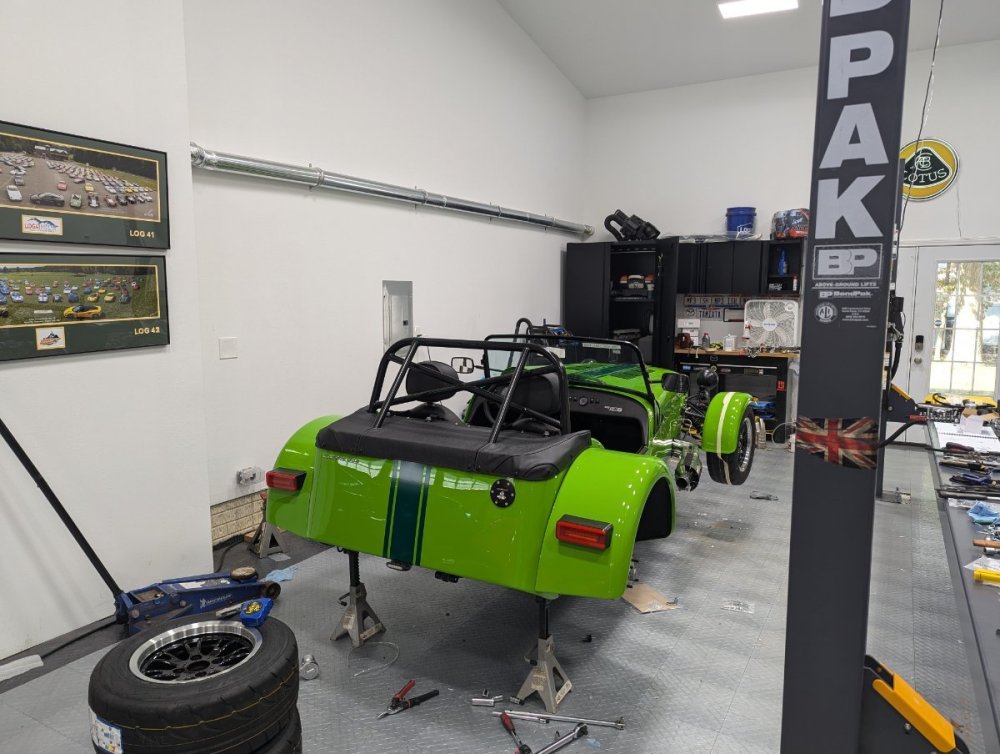

hyper7 Posted October 17, 2024 Author Posted October 17, 2024 Got the rear wing piping/fixings and the correct silencer yesterday, so I am just a few short steps away from starting this thing up.... my short "to do" list - secure handbrake cable - bleed brakes again - tighten rear hub nuts - washer fluid bottle and fuel filter cover - glue remaining carpet in boot area - aim/tighten headlights - replace mirror glass on drivers mirror - steering column bushing....shipped a month ago, still waiting on it. - license plate bracket (sent an email to rocky mountain about that) - put in gas - pray - start it up - drive it around the block without dying. 1

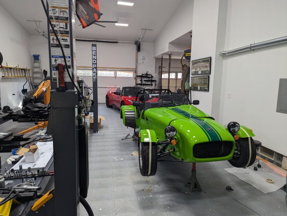

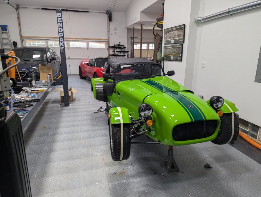

hyper7 Posted November 5, 2024 Author Posted November 5, 2024 I think I've got the handbrake set up well now. I found someone else's post with some steps that seems to have helpd: disconnect the handbrake (ie spin the adjustment nuts all the way loose) Take the calipers off both sides back the pistons in on the calipers with a retraction tool put it back together pump the brakes a few times to move the pistons back to the correct spot tighten the handbrake cable adjuster until it won't go any further pull up the handbrake, see if it rolls (it did not) drop the handbrake, make sure it DOES roll (it did) I also went ahead and bled again since i had everything off, only a couple small bubbles...but hopefully that was enough to cause the squish. gorgeous out right now, so will probably spin around the block before the sun goes down in an hour. I noticed my coolant level was low after my short drives, but i'm guessing its just air burping its way out. also topped off the oil, since it also seemed low. So the REAL question i have....anyone know what vehicle the wiper switch comes from? i'm pretty sure the switch was finally shipped, but since I'm STILL waiting on the bushing since september, i'm not confident it will show up before my inspection on the 14th...would be willing to spend a little to make sure i get it, but i'm having no luck tracking it down from sources other than caterham or another UK site (https://www.mksportscars.com/) - anyone know of somewhere else I can find it somewhat quickly?
hyper7 Posted November 5, 2024 Author Posted November 5, 2024 (edited) just drove it around the block again, brakes feel a little better, but still not as bitey as i expected, but maybe i'm just used to my "modern" cars. also getting a weird pulsing sound after letting off the brakes, so i guess i've gotta put it back in the air again. oh, and my temperature gauge never went above the "blue" section....so i'm wondering if something else is messed up. i had the nose cone off and was running it for a while, and saw the fan kick on, and my obd connector showed the temp up in the low 200s (F). Edited November 5, 2024 by hyper7
