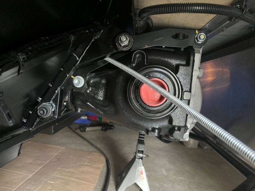

Timberline Posted October 15, 2024 Author Posted October 15, 2024 Update: I was able to re-tap the threads in the differential housing after breaking off bolt threads in it. Too much brute force. Got it installed and moving forward with the rear end part of the build.

Timberline Posted October 17, 2024 Author Posted October 17, 2024 Just a couple build updates today. I am moving forward with little jobs in the engine bay without the radiator mounted, but i do have the brackets being sent to me in the mail! I am stuck on the throttle cable installation. It all makes sense, but I am having a ton of difficulty inserting the plastic retainer into the footwell bulkhead. You can see it's still loose on the throttle cable in the picture. Any tips on inserting/smashing that in there? It feels like another case of internal powder coating like the anti roll bar cups. Finally completed the differential install. Ended up installing the differential frame to the chassis first, then the differential to the differential frame. I would suggest this method for any future builders because the differential frame to chassis holes were spaced really poorly on my build. Also, the differential frame by itself is easier to lift and manipulate into place. Messing with the internal spacer washers with less weight makes it easy. After measuring the total space needed to shim and halving it for each side, install the washer shims on the tighter side first. The natural tension on that side retains the washers without having to juggle anything. Then the whole assembly will be pushing against the other side and retain those washers easily as well. One thing to watch out for is calculating the spacer washers with just the differential frame and no differential. That could push the differential frame too tight. I just used the spacers from my first failed install and it worked great, but that was measured with the whole assembly in place. Additionally, do the forward shorter bolts first (in both cases) because they have internal threads and don't take to the beating as well as the aft long bolt. From an earlier post, I ruined a bolt and almost damaged the differential frame due to cross threading and being thick headed. The aft bolt can take the beating, can better take a chamfer (needed for my alignment), and there is no risk to damaging internal threads.

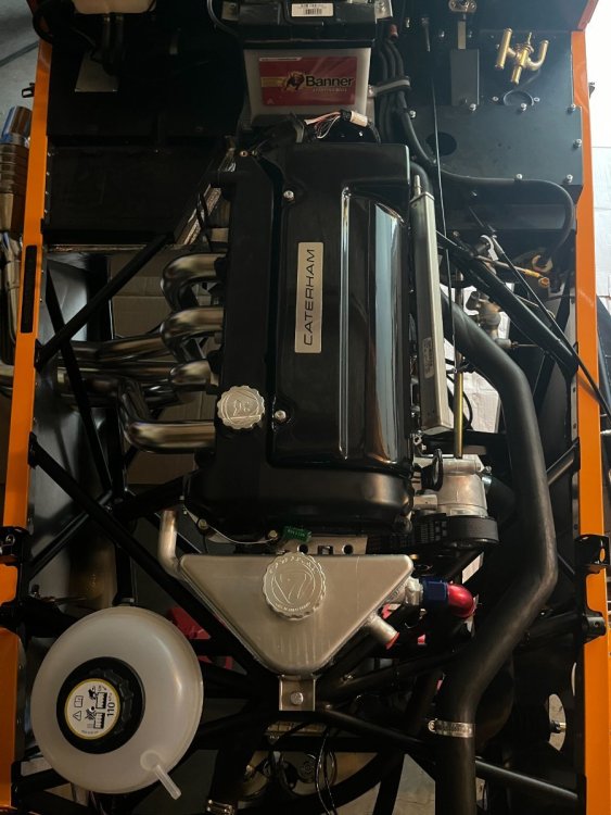

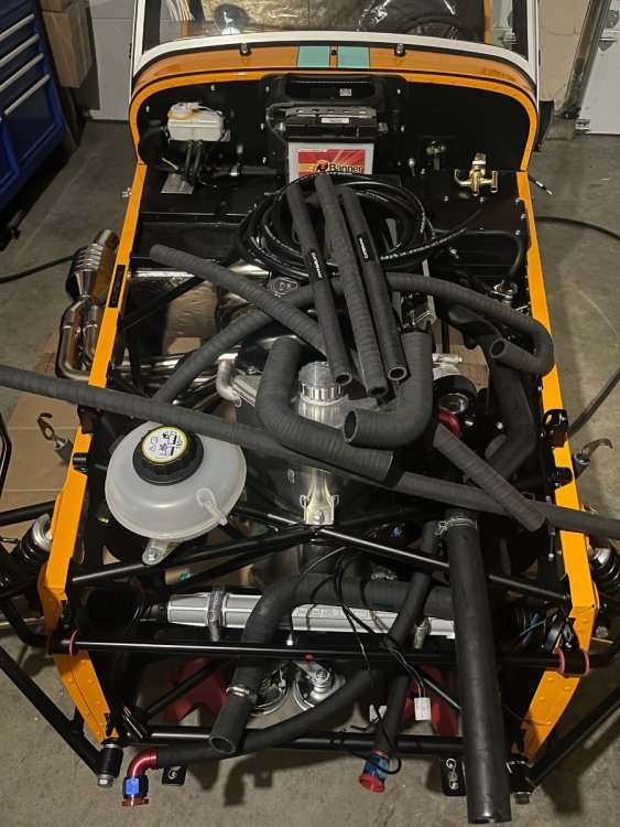

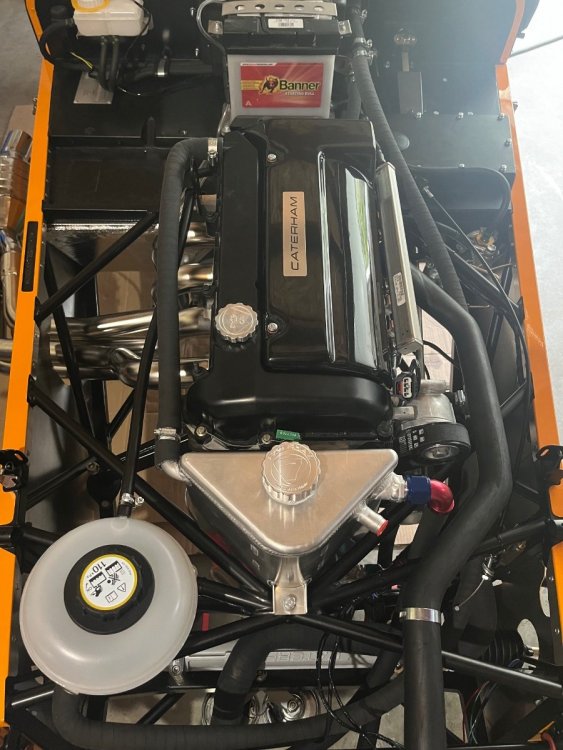

Timberline Posted October 19, 2024 Author Posted October 19, 2024 On 10/7/2024 at 8:37 AM, CBuff said: I’ll be with the car for a few hours. Let me know if there is something specific I can photograph. Mine is 420r sv with heater. Thanks for all the great pictures! Got me over the hump on installing all the hoses. I think I nailed it! 2 1
Timberline Posted October 19, 2024 Author Posted October 19, 2024 (edited) @CBuff But seriously. Thanks for the pictures! Edited October 19, 2024 by Timberline

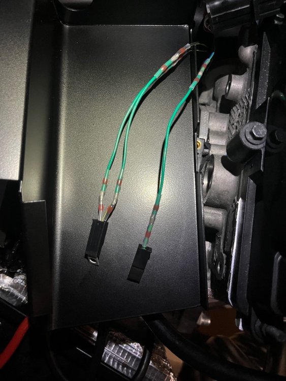

Timberline Posted October 22, 2024 Author Posted October 22, 2024 Okay. After subassembly and connecting the coolant heat sensor (submarine), the lead and ground cables are too short by a couple inches. Any clever ideas to fix this? I am thinking of creating short splices.
Austin David Posted October 22, 2024 Posted October 22, 2024 I created short splices, with one male/one female spade for the two lines. I've seen other layouts which inverted the submarine from the diagram, so it's over top the coolant hose. I think in that configuration it may reach directly... but the little extensions worked well for me for a few years. FYI the submarine sensor is *just* an external, independent coolant sensor for the gauge in the dash. It's not consulted by the ECU, and isn't even calibrated with it. For now definitely plug it in, but when you get the itch, I like CANchecked gauge. 1
Timberline Posted October 22, 2024 Author Posted October 22, 2024 11 hours ago, Austin David said: I created short splices, with one male/one female spade for the two lines. I've seen other layouts which inverted the submarine from the diagram, so it's over top the coolant hose. I think in that configuration it may reach directly... but the little extensions worked well for me for a few years. FYI the submarine sensor is *just* an external, independent coolant sensor for the gauge in the dash. It's not consulted by the ECU, and isn't even calibrated with it. For now definitely plug it in, but when you get the itch, I like CANchecked gauge. Do you know the gage of these signal wires? @Austin David
Austin David Posted October 22, 2024 Posted October 22, 2024 I used 18ga. They don't carry much current so it shouldn't matter. They get a little warm, so close to the cooling, but pretty much anything will be OK. I also had to zip tie them in place, they want to wiggle around 1
Timberline Posted October 24, 2024 Author Posted October 24, 2024 I used 18ga like you did. Upon stripping the harness wires, guessing they are 20ga. Happy with the results so far. I had to heat the shrink splices in place, only piece of metal I have left is the fuse box cover. It’s an excellent heat shield!
Austin David Posted October 24, 2024 Posted October 24, 2024 ha, you did a better job than I did. I just made little plug-in extensions. FYI, that double wire is a ground, and one leg goes further down the loom rather than running multiple grounds all the way back to that connector. 1
