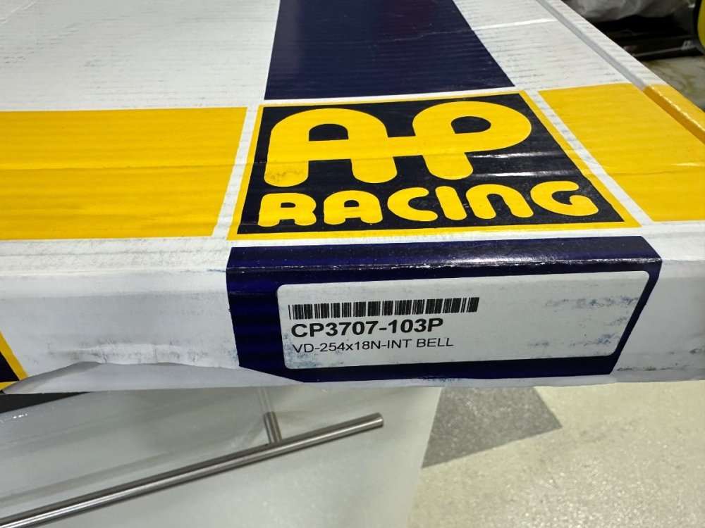

If they are vented fronts then they are AP Racing.  I have an unused set in their box which I can take photos of tomorrow.

Front vented discs
Rear standard non vented discs.
The parts numbers in those photos are the AP  Racing parts numbers.  Normally if you go to the AP Racing website you can search for tech specs by part number - these did not come up likely as Caterham have a proprietary agreement with AP Racing.
I bet you could ring AP Racing and talk to someone to get what you want.  The catalog may list these part numbers but I did not read through the 130 pages to prove it.
The thickness info is
AP vented Front disc
18 mm thick new
replaced at 16.4mm

The rotors on my 7 are not vented/slotted.  But... with the guidance you all provided, I found the model number by carefully cleaning the outside edge of the rotors.  Combined with knowing to look through AP Racing's catalog, I hopefully will be able to find the specs.
In case others have this issue, here are the photos I took of what information is stamped onto the edge.
I think I have the answer for the inspector. Unlike oem discs on mass produced vehicles which are intended to have a long service life, these discs are specially designed and heat treated for racing and are never to be machined/turned or have a similar length service life. There is a wear limit. It is the nominal specification in the catalogue. Any thinner and they must be replaced. Not repairable by machining thinner.
