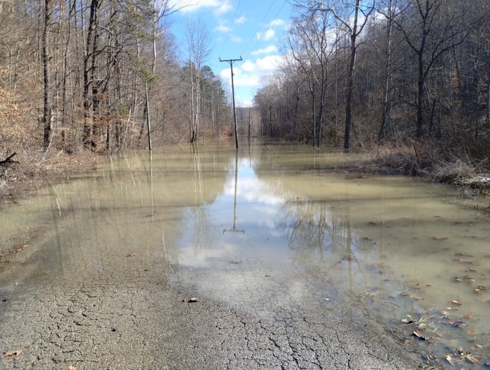

Gordy Posted February 18 Author Posted February 18 But I don't have anything but time right now. Historical flooding in the area makes it impossible to leave the house so as long as power stays on I can do all the research in the world... 1
Gordy Posted February 18 Author Posted February 18 2 minutes ago, Vovchandr said: Time to build this Ha, very tempting.
