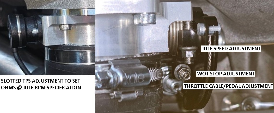

MV8 Posted November 10, 2025 Posted November 10, 2025 Looks to be Alpha-N ecu if there is no MAP sensor. No IAC shown so idle is set by screw and no compensation for hot or cold running but also cannot cause rpm oscillation you've described. You didn't say what you set the warm idle speed to, but I expect it is too high, putting it in a different position on the ECU tuning map where the timing is changing. Do not loosen and play with the TPS setting without having a spec and a DVM to check it. Assuming for now that the TPS is adjusted correctly for the TB butterfly idle position, try to reduce the warm idle setting to around 800 rpm. This means you will need to keep the throttle open slightly during cold start long enough to stay running.

MV8 Posted November 10, 2025 Posted November 10, 2025 Don't expect this to have the same good drive ability as a mass produced car with modern efi. This is a race car with a very basic efi where the clutch is not intended to be engaged until higher rpm. In some ways, AlphaN is more limited than a carburetor to address drive ability issues due to a lack of common efi sensors that all other systems incorporate. Waiting assumes flooding occurred but it may be lack of fuel. Initially, I would turn the key to RUN and wait three seconds for the fuel system to pressurize, followed by engaging the starter, foot off the throttle until it starts or five seconds. If it doesn't start, and if I don't smell (unburned/flooding) fuel, I'd immediately repeat the process. Holding the throttle open while cranking might help with excess fuel/flooding but not for a lack of fuel issue. 1

MV8 Posted November 11, 2025 Posted November 11, 2025 I still don't know what it should be, but I found that some MBE Jenvey efi kits are set up for an idle speed of 1200 to 1375 rpm while keeping the TPS voltage at between 0.30 and 0.37vdc and 44.1 psi fuel pressure. A CAT dealer should have access to the correct, basic servicing information. For now, you could raise the idle a bit but keep it under the lowest rpm at which the warm oscillation occurs. Higher idle speeds can make engagement of first or reverse more difficult.
