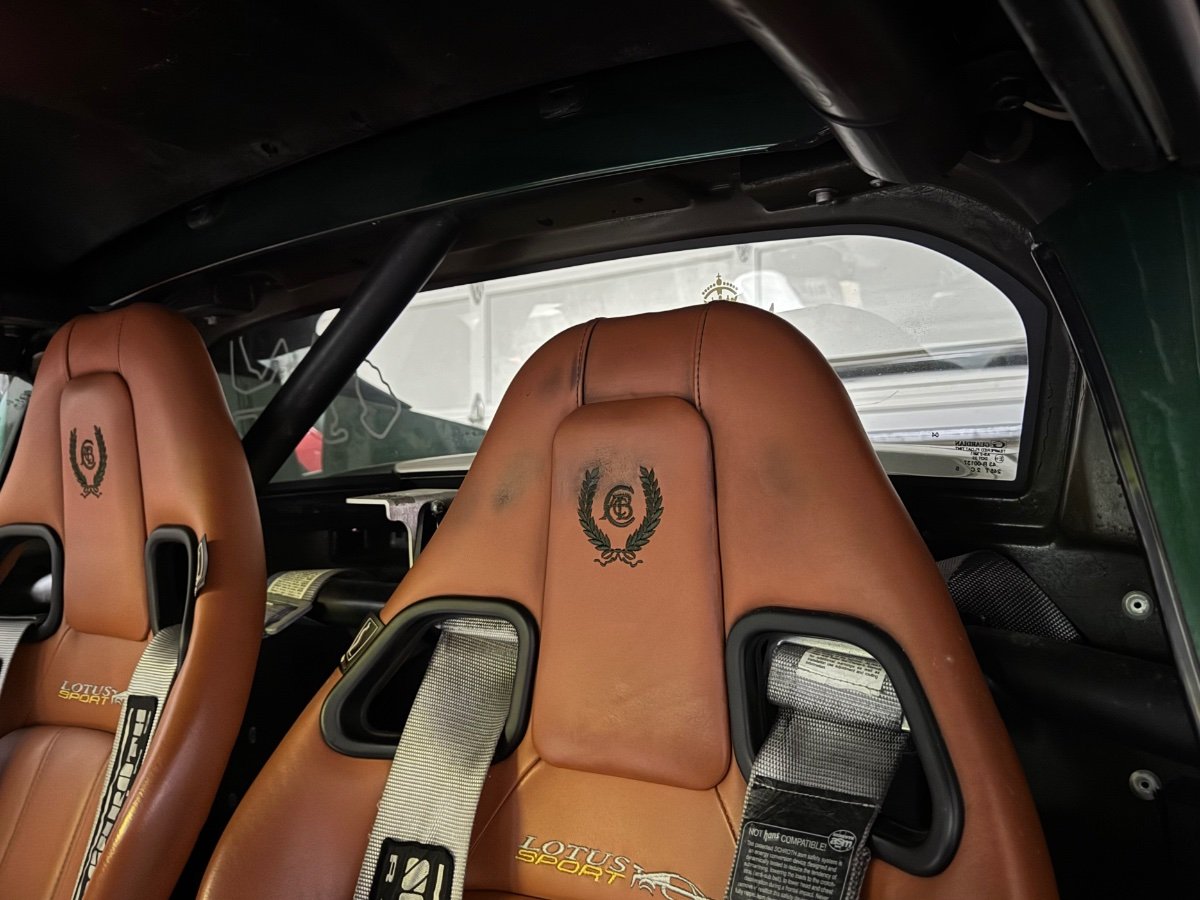

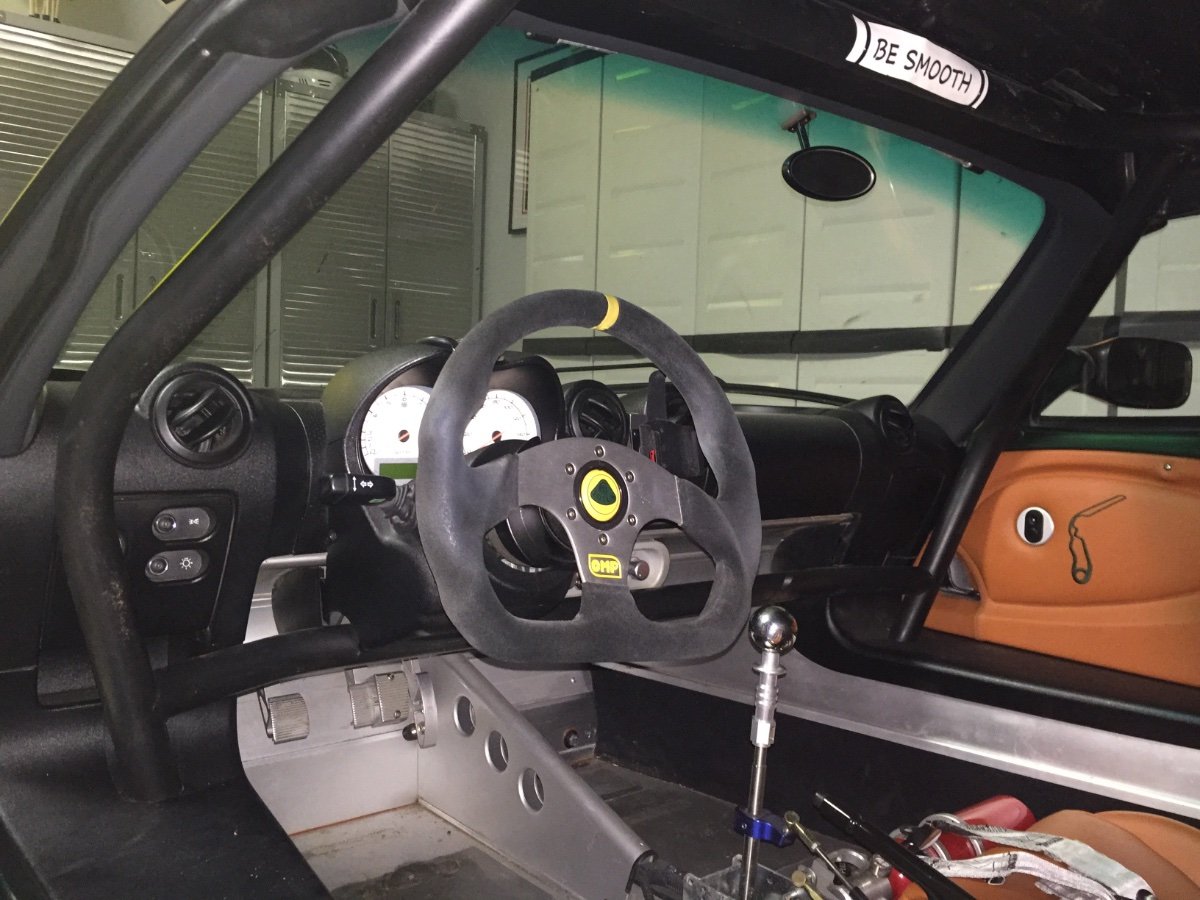

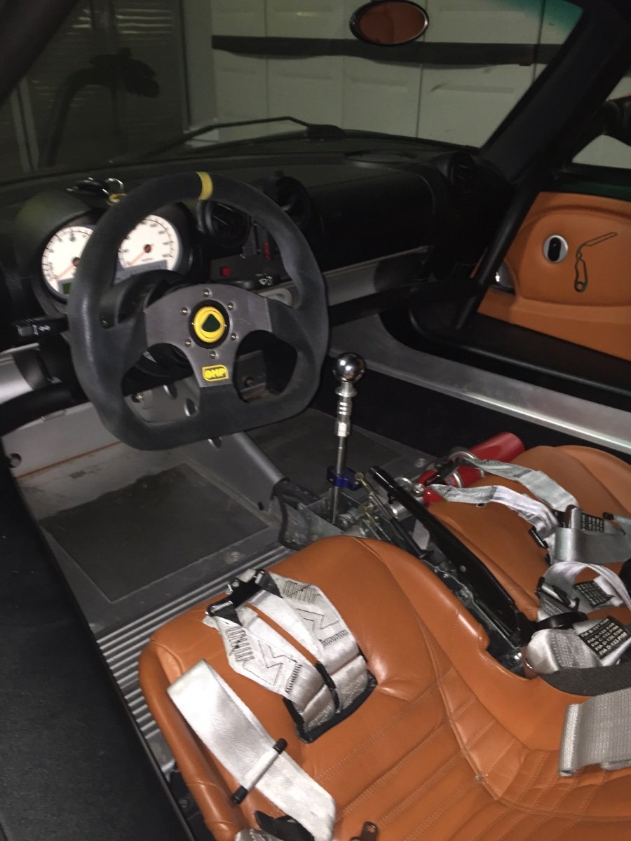

Thanks @Xhilr8n; agree with your concerns. You're correct about body moving around by an event. I'll evaluate the safety of 3-point after I get a chance to drive a bit. If I feel it is inadequate with respect to the proximity of the cage, will switch to 6-point. As I understand, it is easy to retrofit.
Would you happen to have a picture of your Elise, showing the Cage? I want to get a perspective with respect to Seven. Thanks.
Edited by rider
The Elise cage was installed by Dwight Wightman who did the cages for the Exige Cup cars.  He said it weighs 90 pounds.  It’s shaped to fit my knees and helmet and shoulder straps at good height, all that.  No bar across the doors, depending on the high treshholds of the chassis.  He also made custom sest mount to get me lower for the helmet.
There is hard dense foam in helmet areas to sides. Six point Schroth.  Seats reinforced to chassis.  Always had neck protector too.
Hard to compare to what Caterham offers, this car 750 pounds heavier even stripped for track.  But I am just learning of how protective the Caterham offerings are.  New here.
I have to wonder.  Have you been in many wrecks? Big offs? Spins?  Ever been hit hard by another vehicle?  In the words of my first driving instructor my Uncle Frank, “I’ve been in enough wrecks to know what to do when I get there”   I’ve done all those things and more that I’m too embarrassed to admit.  Stuff happens and even if it does not we prepare for it.  You’re making a great effort.
Edited by Xhilr8n
On 7/7/2025 at 11:37 PM, Xhilr8n said:
I have to wonder.  Have you been in many wrecks? Big offs? Spins?  Ever been hit hard by another vehicle?  .........
Thanks for the pictures, @Xhilr8n. Your setup is stout indeed and looks the part.
I've never tracked. However, been in a few crashes, over the decades, with four-wheels and two. A big one in a S2000. Hit by a teenager running a red light, totaling it. Escaped potential fatality or serious injuries by fraction a second! Then, a few crashes on motorcycles.... for different reasons....
Looking at your cage, it is very different from Seven's Trackday Roll Cage. Judging by scuff marks on the headrest, probably caused by helmet, I can visualize the top of the helmet is very close to bottom edge of the cross-bar. The side-bar by the door is reasonably close as well. I'll do an evaluation of the cage and 3-point combo after some time driving. Thanks again; gives me a perspective.

My Dad was a car dealer, Dodge and Plymouth.  He spoke of the “ring of steel” sound you experience in a collision, how it matures you.  I asked about your experience because I wanted to know how real you view the possibility of an event,
Yes my helmet is battered with black marks from contact with cage and the hard pads.  We lowered me as much as possible.  Notice heights of seats.  I may do it with the 360R, lower just driver.
