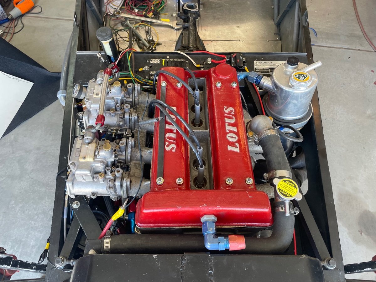

The breather vent in the head I was asking about is the one in the side of the head, behind the intake runner. On my Se7en it has a 90 degree rubber thingie, which used to go to a plastic catch bottle. It now connects to the oil tank. In the Elan there is a tube running straight into the airbox.  In your case I'd open that second point on the top of the oil tank and connect the two. Perhaps connect it to the cam cover breather and run them both to the same point? If I had added the cam cover breather I would have connected it to the unused spot on the catch can. Depending on how you vent the oil tank you might have other options as well.

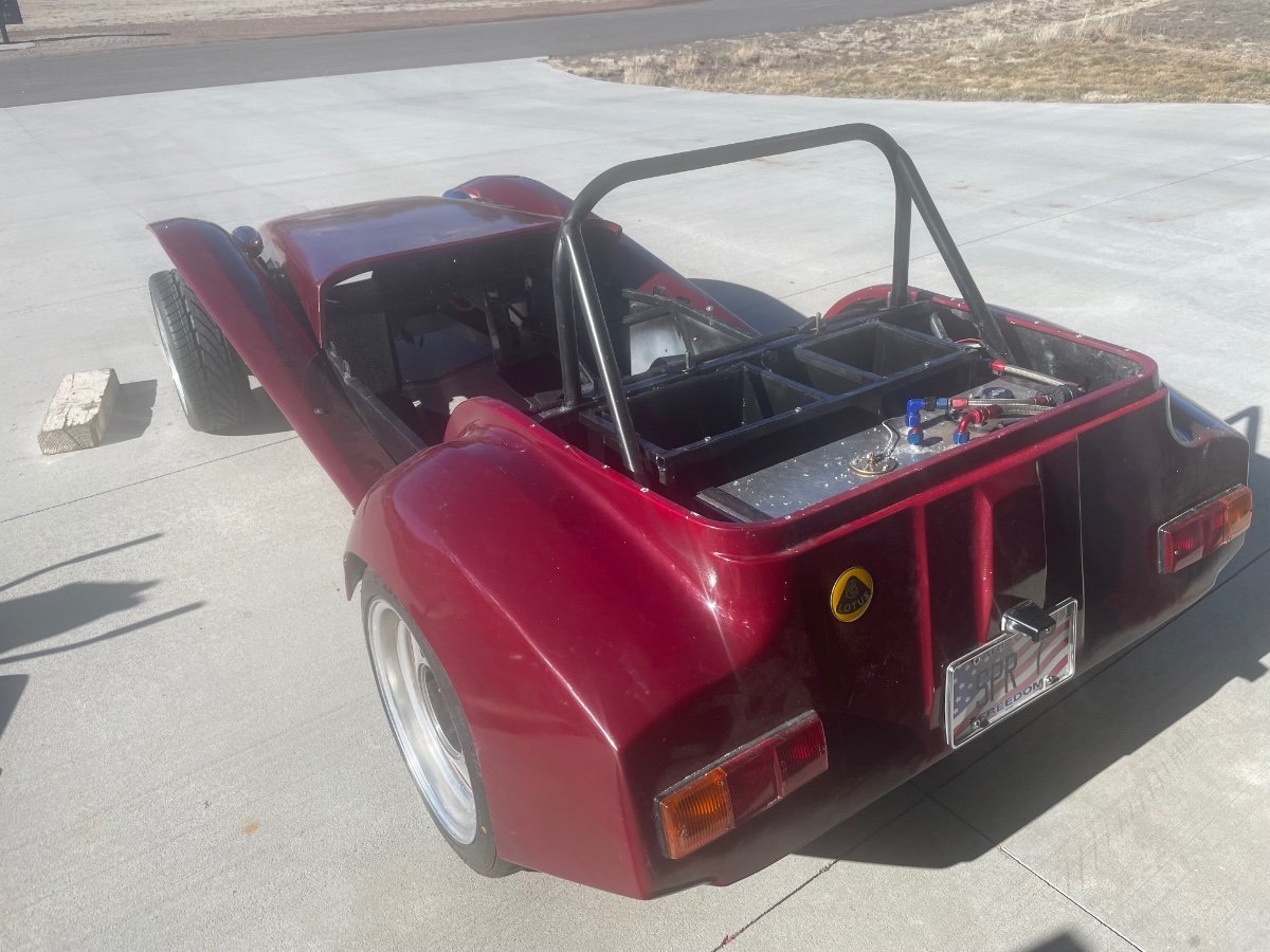

It's been a long time..... I put a .120 restrictor from Dave Bean on recommendation of the man who built the short block, Bill Schlossnagel. He also recommended
Valvoline 20w-50 Classic oil. I have PLENTY of oil up to the top. When I ran it there was so much spatter out the left/rear breather, which I forgot to plumb into the dry sump tank, I thought I had an oil leak at the rear seal. I have 75psi when cold at about 2000 rpm and about 35 when hot. The car has not run on the street yet in spite of being registered since June; too many small problems that add up to not turning a wheel yet.
