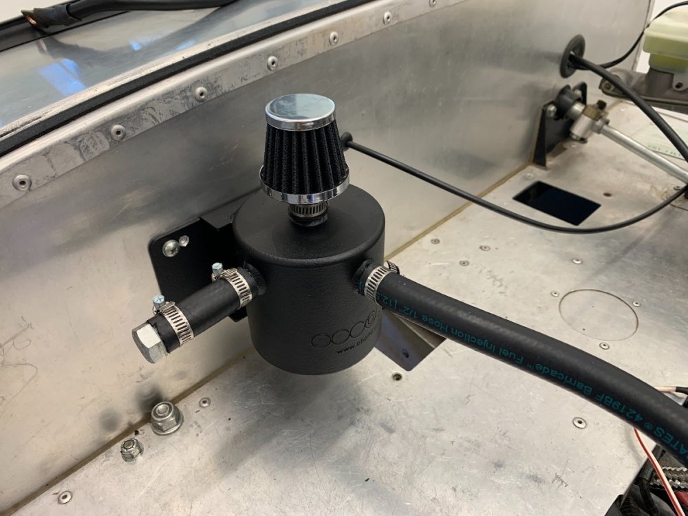

Here are pictures of the top of my oil tank, showing how I vented the engine and tank. As you can see the cylinder head vent goes to the outer tank port, and the center port goes to a catch can which is then vented to atmosphere. (I checked the catch can yesterday and it is dry!) I had considered adding a cam cover vent but so far I don't seem to need it.
First of all where did you get that tiny filter? I think it will work well on my tank. My leak problem is where the block, head and timing case all come together. Even 20 seconds of running (no cooling system) left enough oil that it was hard figuring out where it came from. My first thought on pulling the cam cover was WOW there's a lot of oil up top. Hence my decision to put in a restrictor. On teardown, the timing case gasket looks suspect.
