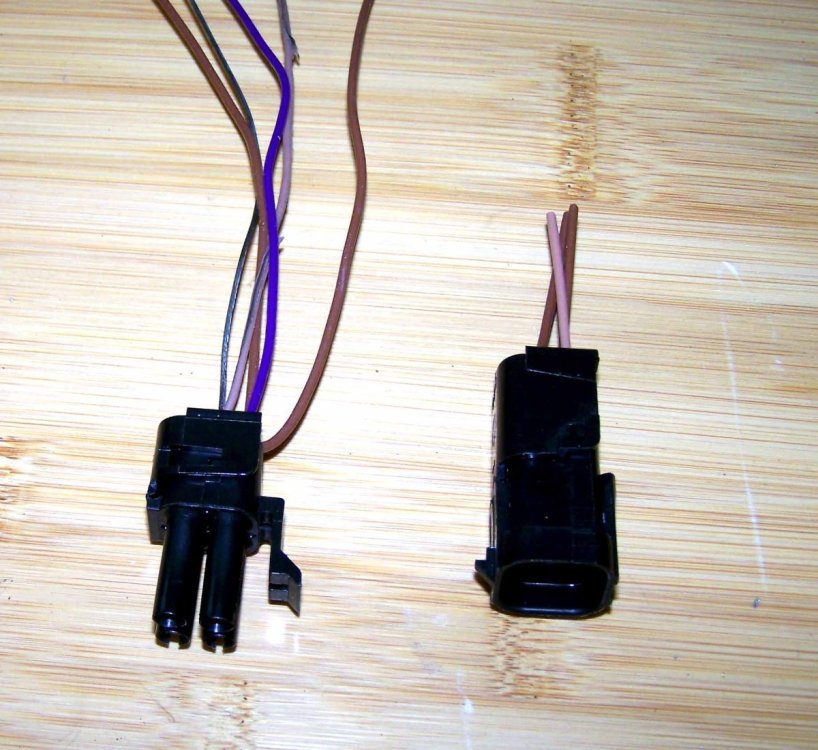

savagete2860 Posted September 19, 2025 Posted September 19, 2025 (edited) 45 minutes ago, hyper7 said: Went ahead and ordered a fresh jug of Motul 8100 5w50 and a wix 57035 filter - if anyone has a different favorite let me know, the Internet was surprisingly unhelpful for this oil filter. Josh from RMC recommended Mobil 1 5w-50 (the normal stuff, not the expensive "supercar" stuff made for the c8) for the oil and a Wix 51348 for the filter from O'Reillys. Also kind of cross posting from my issue thread to here - anyone know what replacement to use for O2 sensor stateside that has the correct connector as well as spark plugs and coils? Edited September 19, 2025 by savagete2860
mrmustang Posted September 19, 2025 Posted September 19, 2025 4 hours ago, savagete2860 said: Josh from RMC recommended Mobil 1 5w-50 (the normal stuff, not the expensive "supercar" stuff made for the c8) for the oil and a Wix 51348 for the filter from O'Reillys. Also kind of cross posting from my issue thread to here - anyone know what replacement to use for O2 sensor stateside that has the correct connector as well as spark plugs and coils? Do you have a male or female end on your O2 sensor? (left or right side of attached picture)

savagete2860 Posted September 20, 2025 Posted September 20, 2025 21 hours ago, mrmustang said: Do you have a male or female end on your O2 sensor? (left or right side of attached picture) The sensor I bought came with a plug like the female one you show. The ones on the car looks totally different. Guessing they just switched the part at some point? This is what mine is and looks like: https://caterhamparts.co.uk/other/3969-lambda-sensor-long-lead-csr.html
mrmustang Posted September 21, 2025 Posted September 21, 2025 7 hours ago, savagete2860 said: The sensor I bought came with a plug like the female one you show. The ones on the car looks totally different. Guessing they just switched the part at some point? This is what mine is and looks like: https://caterhamparts.co.uk/other/3969-lambda-sensor-long-lead-csr.html I ended up buying the AC Delco AFS-73 (GM # 25312178) which has the female version (picture on right) and I swapped out for the male plug from an old oxygen sensor I found in the boot (no part number). Eventually, I'll find the correct adapter from GM and switch the ends around on the main harness so I can use the AFS-73 as it comes out of the package from GM. I've yet to stop at the local GM dealer parts counter to see if they have a harness repair kit or not for the other side of the stock oxygen sensor. Bill
