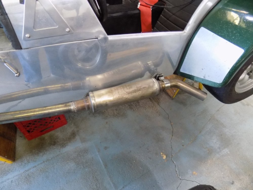

MV8 Posted January 7 Posted January 7 How about some close pics of the ends? Do you have the heat shield that hides the muffler? Is it riveted together or welded? Pipe diameters and muffler length? It can be repacked or replaced. Covered/hidden allows a standard, quieter muffler to be fitted.
Reiver Posted January 7 Author Posted January 7 I'll post some pics today...welded but I'll add the dimensions. It is the original from the build.
MV8 Posted January 7 Posted January 7 Pipe od in and out, case od and length, and if inlet or outlet is offset from center.
Reiver Posted January 7 Author Posted January 7 Inlet pipe from header 2.1 in exterior. Entry and exit pipe centered. Overall length 27.5 in. Diameter 5"....circumference 16 approx.

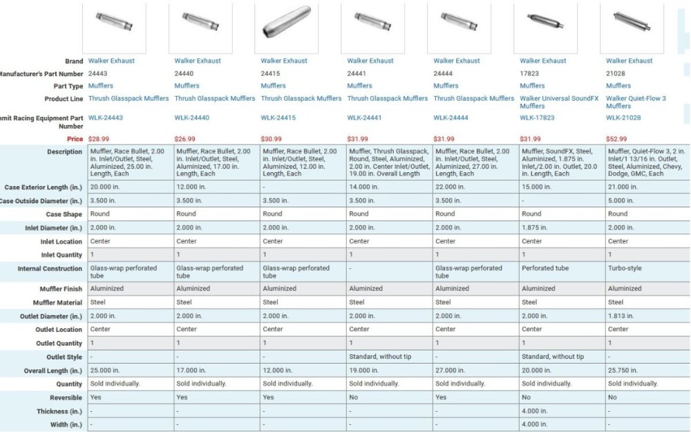

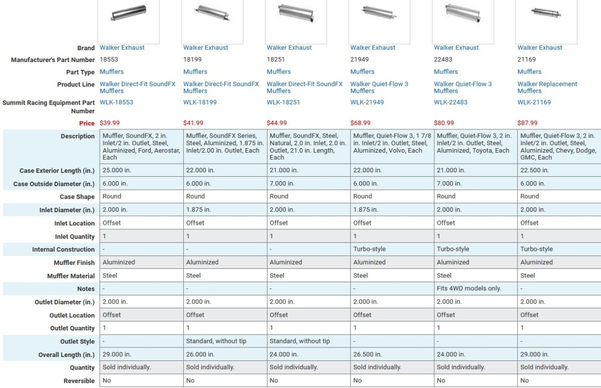

MV8 Posted January 7 Posted January 7 (edited) It depends on how much work you can do. The inlet appears to not be parallel to the case. Here are some mufflers that could be adapted (should have a cover as they are not made to be pretty/smooth) or you can import one that is a direct fit. If you'd like to repack and don't mind a little fab, the case could be cut about an inch from the end, a strip of .050" or so sheet about 1.5 inches wide can be rolled to fit half way in to the forward case, the case drilled for a few spot welds to hold it in place, then the cap added, outlet correctly clocked, then a few #10x3/8 or so pan head sheet metal screws added to hold it on. Touch up with flat exhaust or barbecue paint to hide the serviceability. Packing material is common. Â Metal supermarkets is one place you can buy sheet metal in these thickness cut to the size you need. I bought some at my local shop yesterday for a continuous cement mixer I am building because I didn't have time to get a truck to pickup a full sheet at my normal supplier. You can almost bend the metal by hand but it is easier to use the pipe and body to get the right shape. I don't think any of the direct fit replacements will be as quiet as your repacking or using an ugly oem type. Edited January 7 by MV8

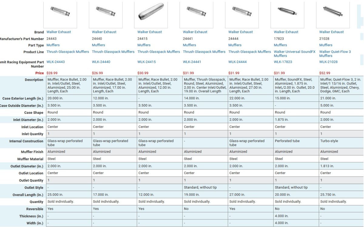

Reiver Posted January 7 Author Posted January 7 (edited) Thanks we've been looking at the same stuff.... the inlet is centered but offset...the outlet isn't really an issue. Ugly OEM in flat black isn't bad and I'm looking at the Walkers. An offset inlet on a 6 in wide would work to as it could be clocked and might eliminate that angled intake issue altogether. I use 'stovebright' paint for exhaust headers...works great. Edited January 7 by Reiver
IamScotticus Posted Saturday at 03:40 AM Posted Saturday at 03:40 AM Is there a website for these Walkers?
Reiver Posted Saturday at 04:01 AM Author Posted Saturday at 04:01 AM (edited) Â Â Yes, but just pick a model number and do a search it will come up... Edited Saturday at 04:02 AM by Reiver 1
MV8 Posted Saturday at 09:46 AM Posted Saturday at 09:46 AM summit racing has a very good filter for narrowing the mufflers to what you need. Their prices for walkers are usually the best but shipping is the kicker. 1

Reiver Posted Saturday at 10:40 PM Author Posted Saturday at 10:40 PM Ouch...many of the Walkers inlets are offset so that would allow you to clock the muffler higher than normal...that could alleviate that issue.

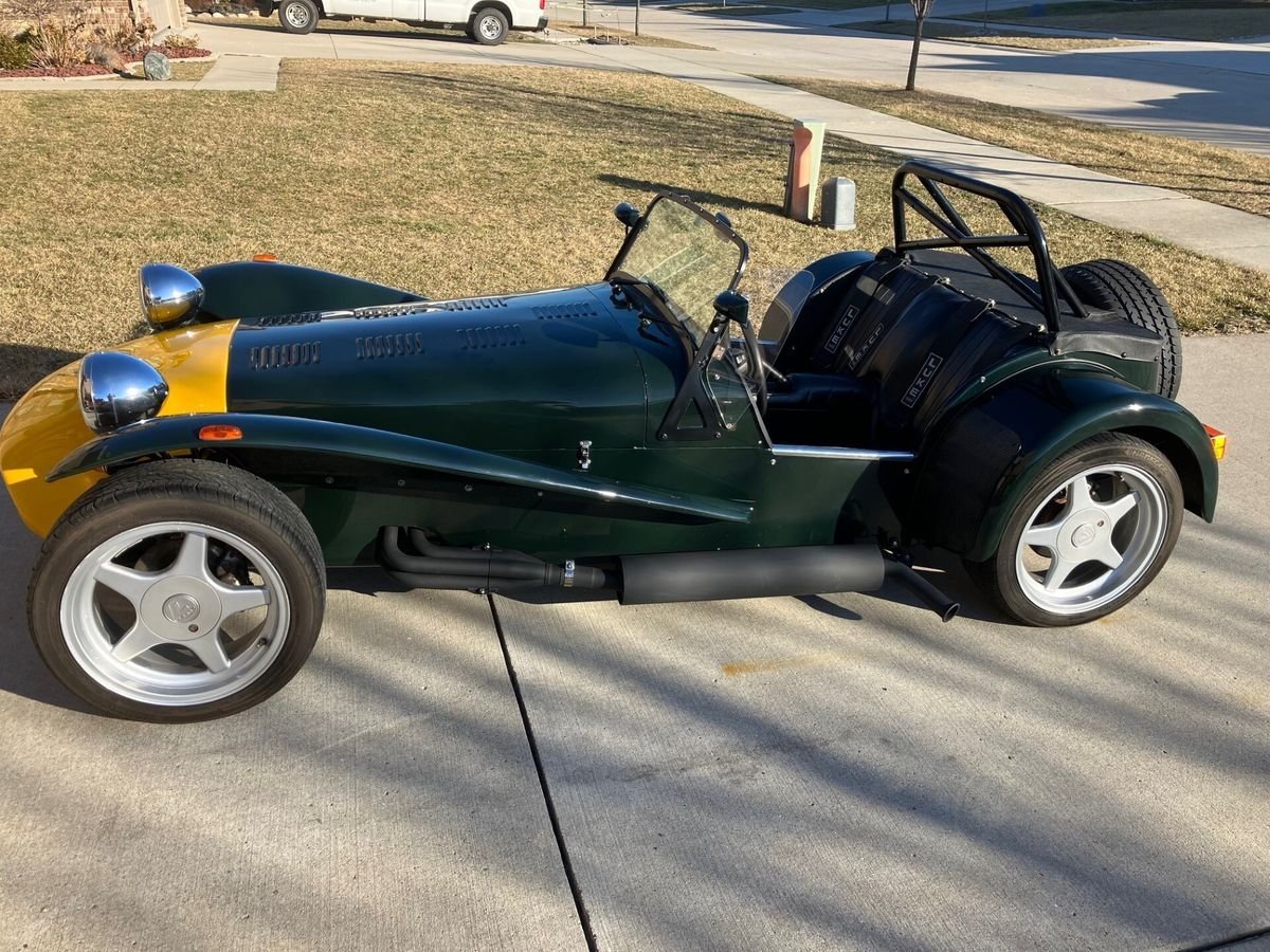

7Westfield Posted Monday at 03:16 PM Posted Monday at 03:16 PM (edited) 19 hours ago, IamScotticus said: Xflow full length Cats traditionally used a left wing that was made higher on the bottom edge to allow the exhaust to pass under. The only reason I'm going with a side tip now is because the replacement wing I have doesn't have the clearance. I would rather not cut a hole. We shall see how it goes. I may find ear muffs sufficient. This is what I use with my xflow   https://www.summitracing.com/parts/mpe-10444#overview   it's not TOO obnoxious  I use the cheap foam earplugs from HF  I tried a set of muffs, but not as good. My muffs seem to be biased toward higher freqs, not so good down low I don't use them around town, but more than 10 miles on the highway I have them in  Edited Monday at 03:31 PM by 7Westfield 1
Reiver Posted Monday at 03:37 PM Author Posted Monday at 03:37 PM Looks fine but I'd go longer...I want to do away with the ear plugs altogether. Presently hang a set on the rear view mirror. 20/25 inches.... I may repack the original and give that a shot.
7Westfield Posted Monday at 04:24 PM Posted Monday at 04:24 PM That one is 14" long also comes in 18 + 22"
