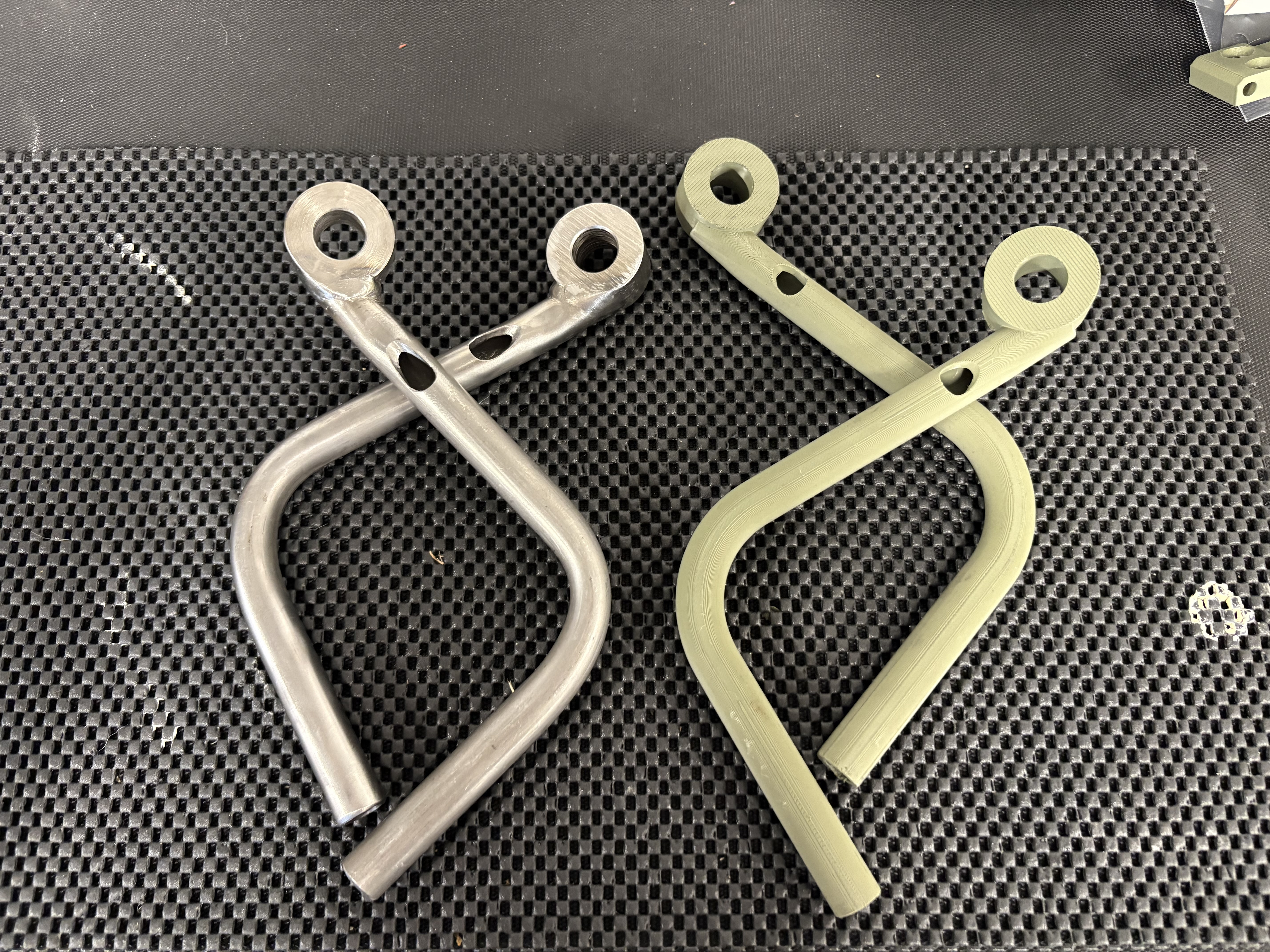

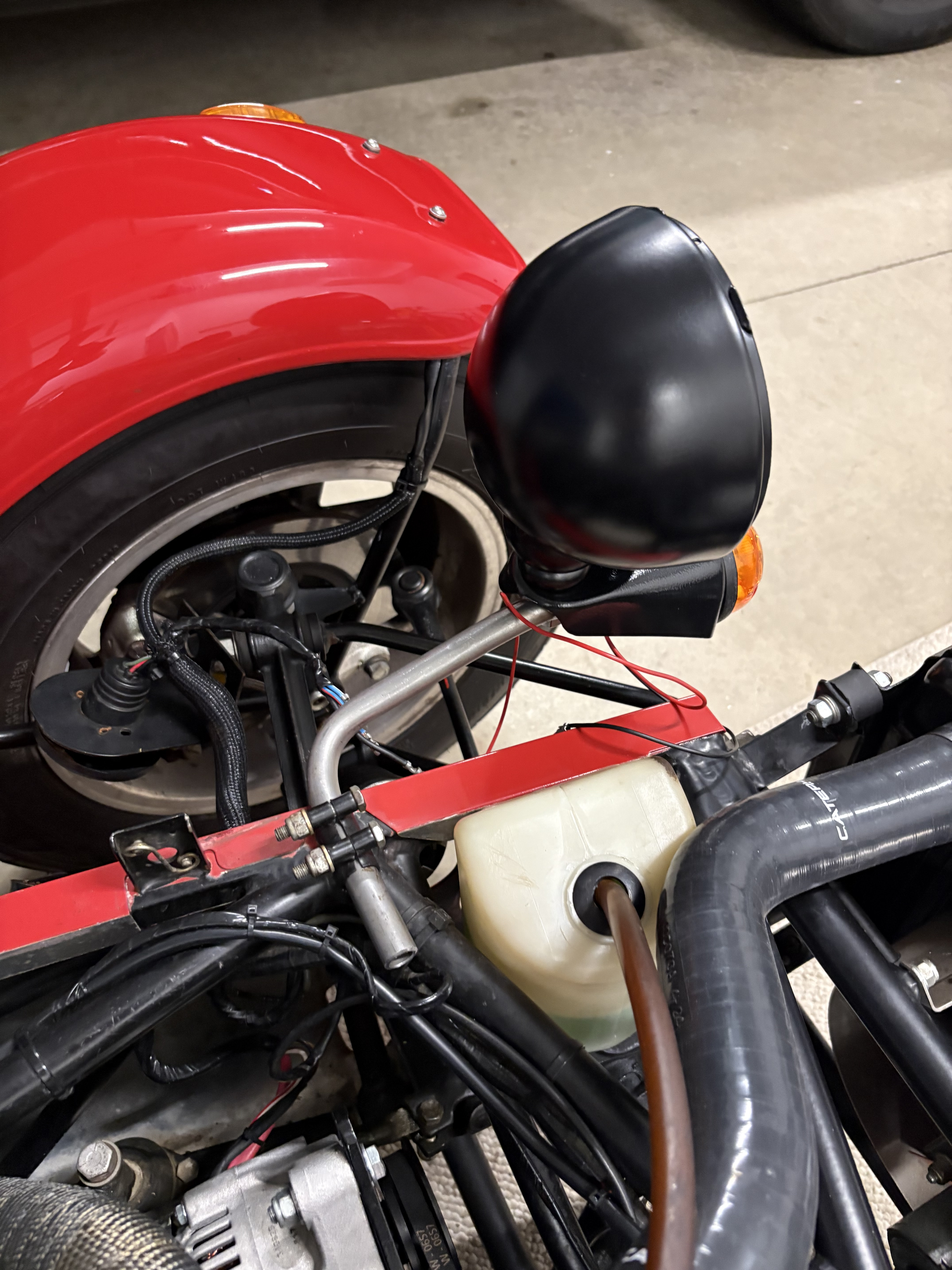

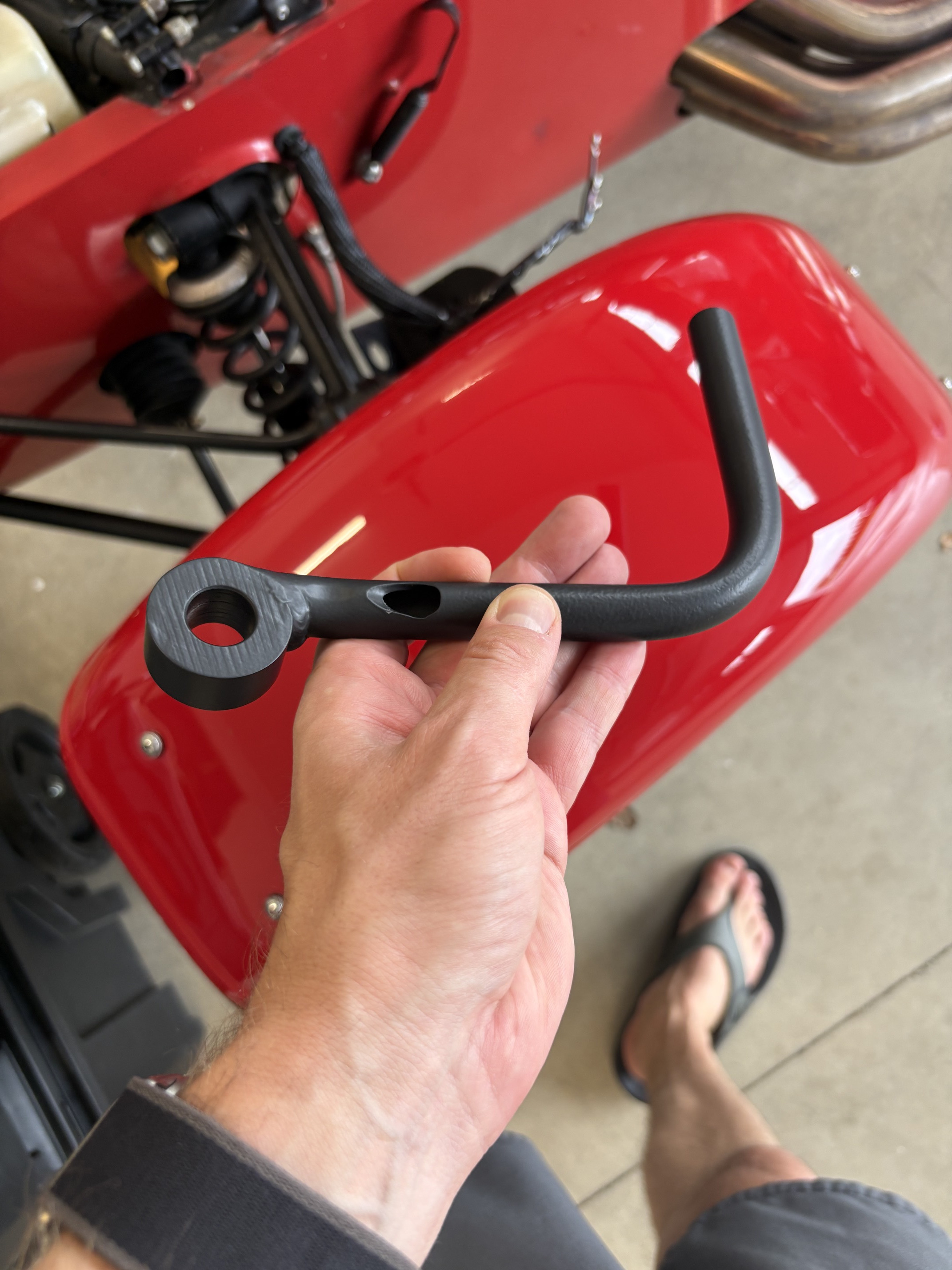

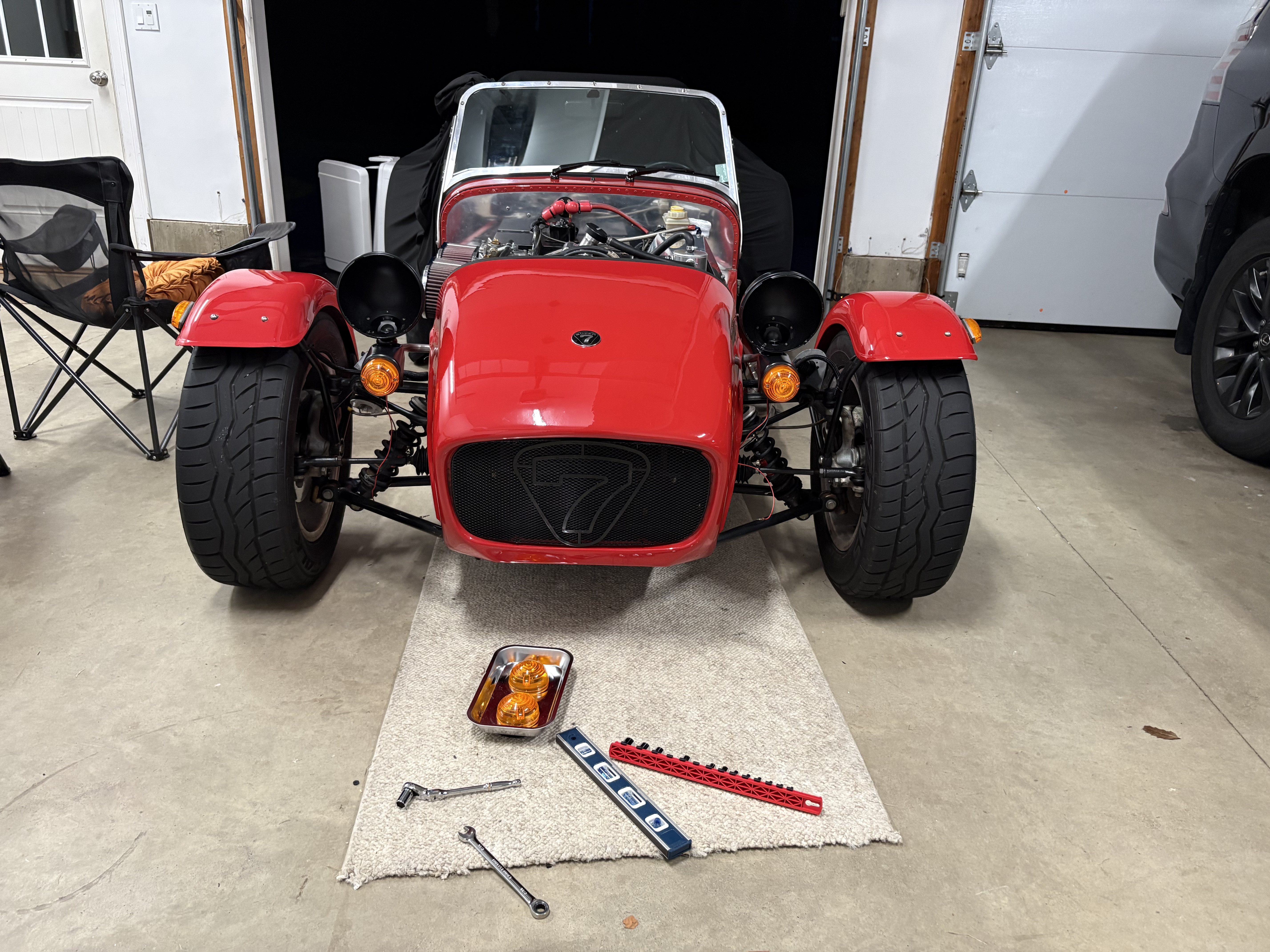

I swapped out my 7-inch headlights for 5-3/4-inch units. I liked the look, but I wanted to position them lower and farther forward. I also wanted to keep the brackets tight against the nose to clean everything up.
I figured that using the newer-style indicator pods would allow me to offset the brackets inboard by 1/2" and achieve more of the look I wanted.

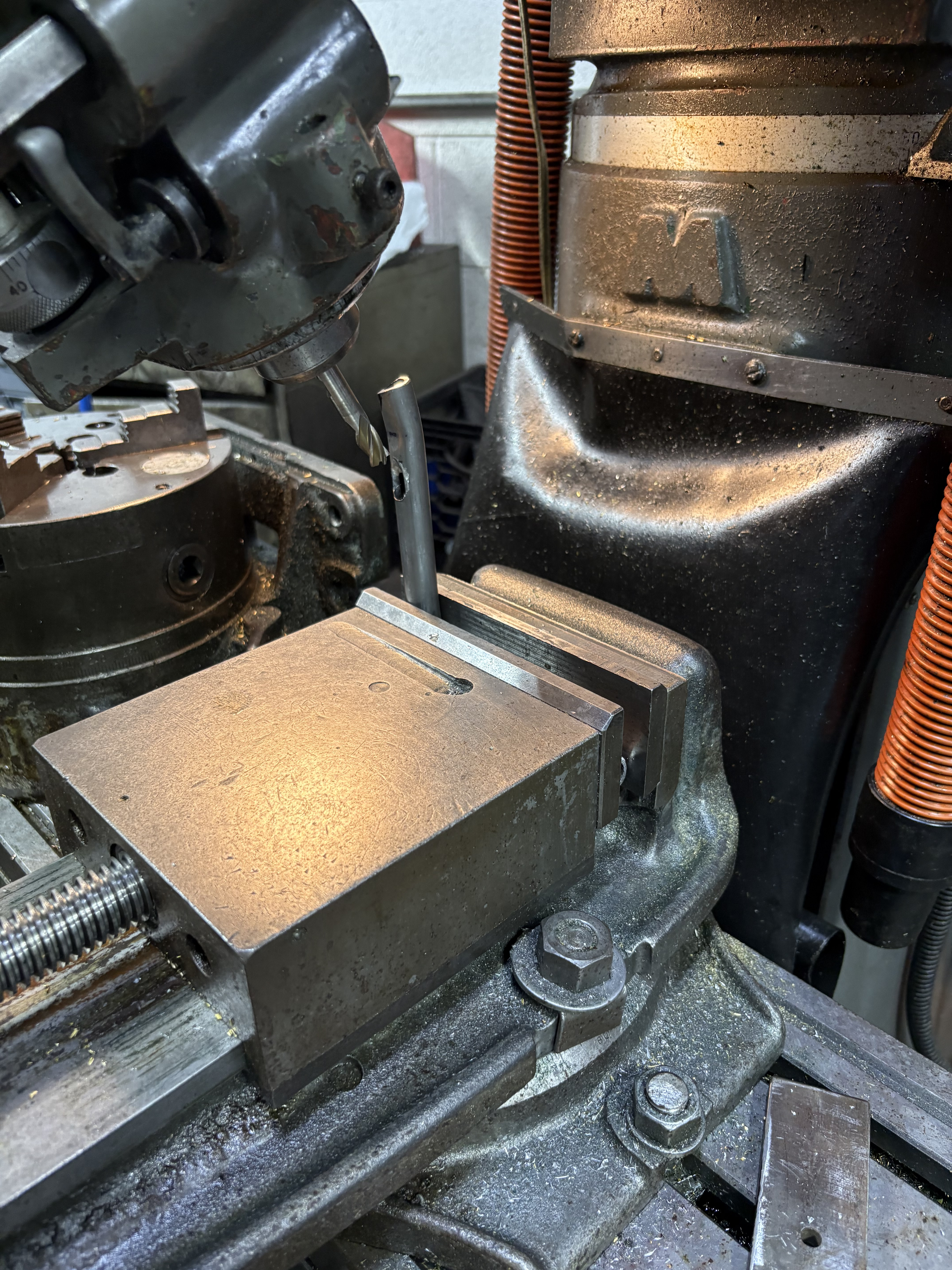

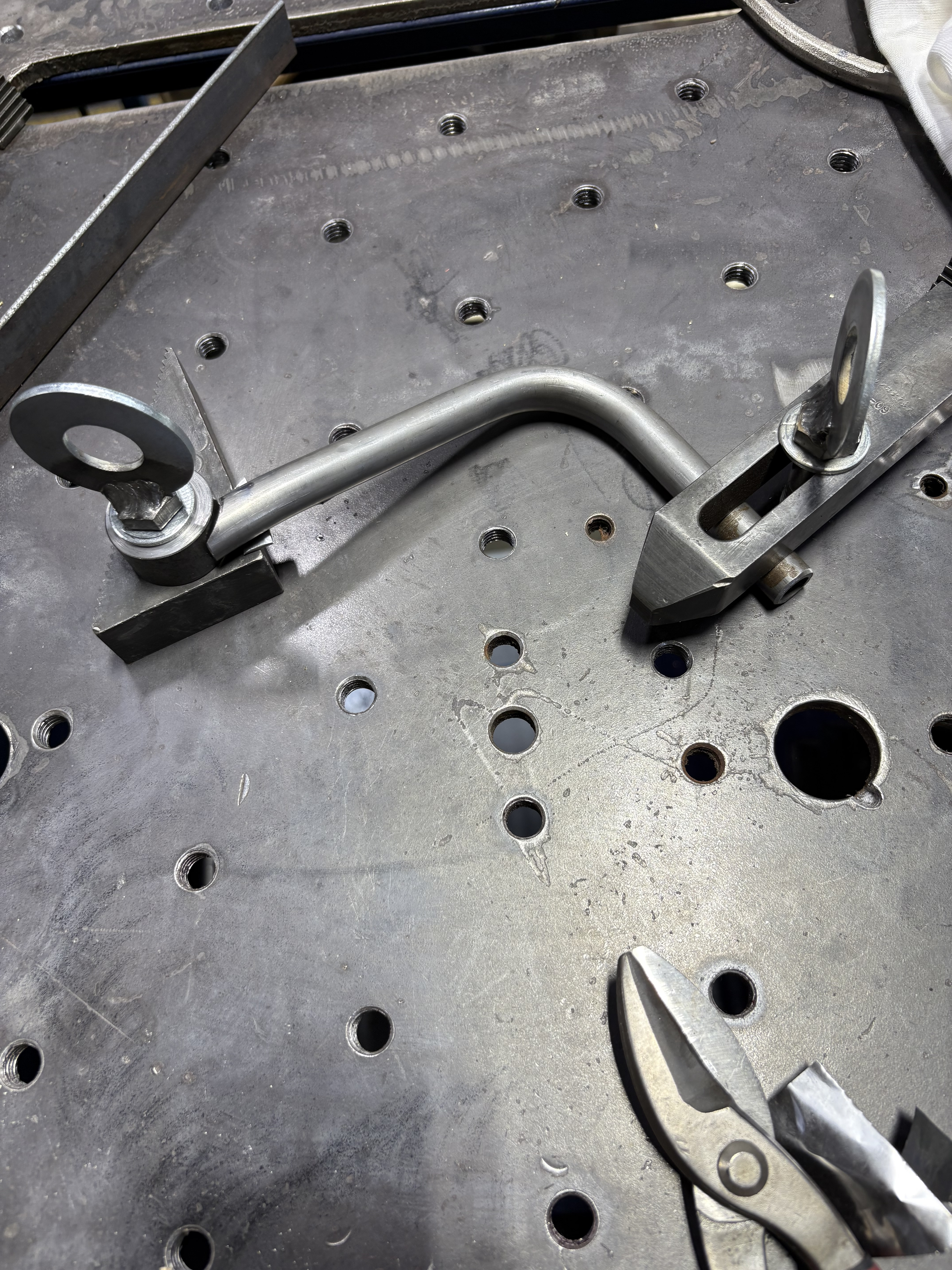

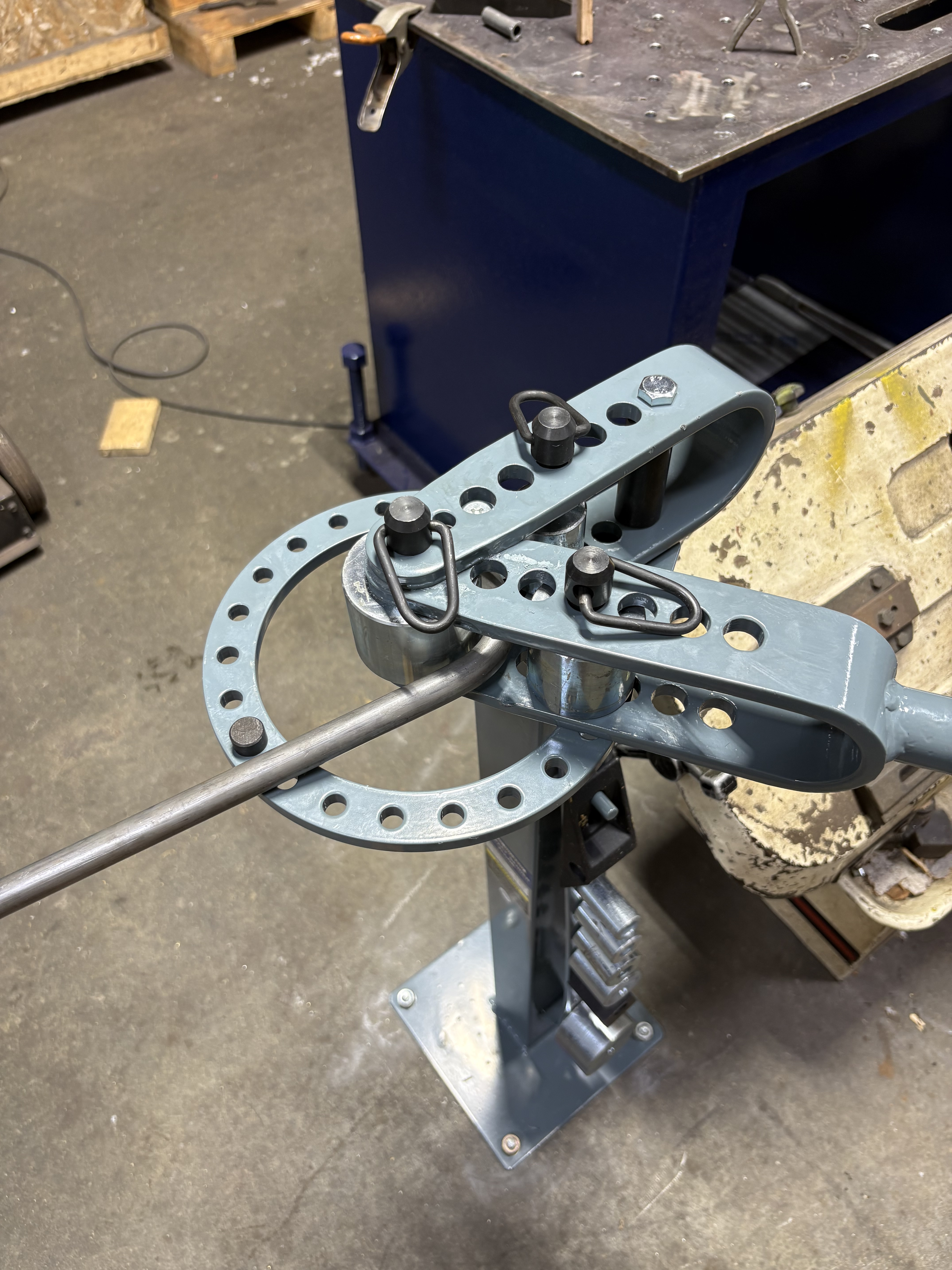

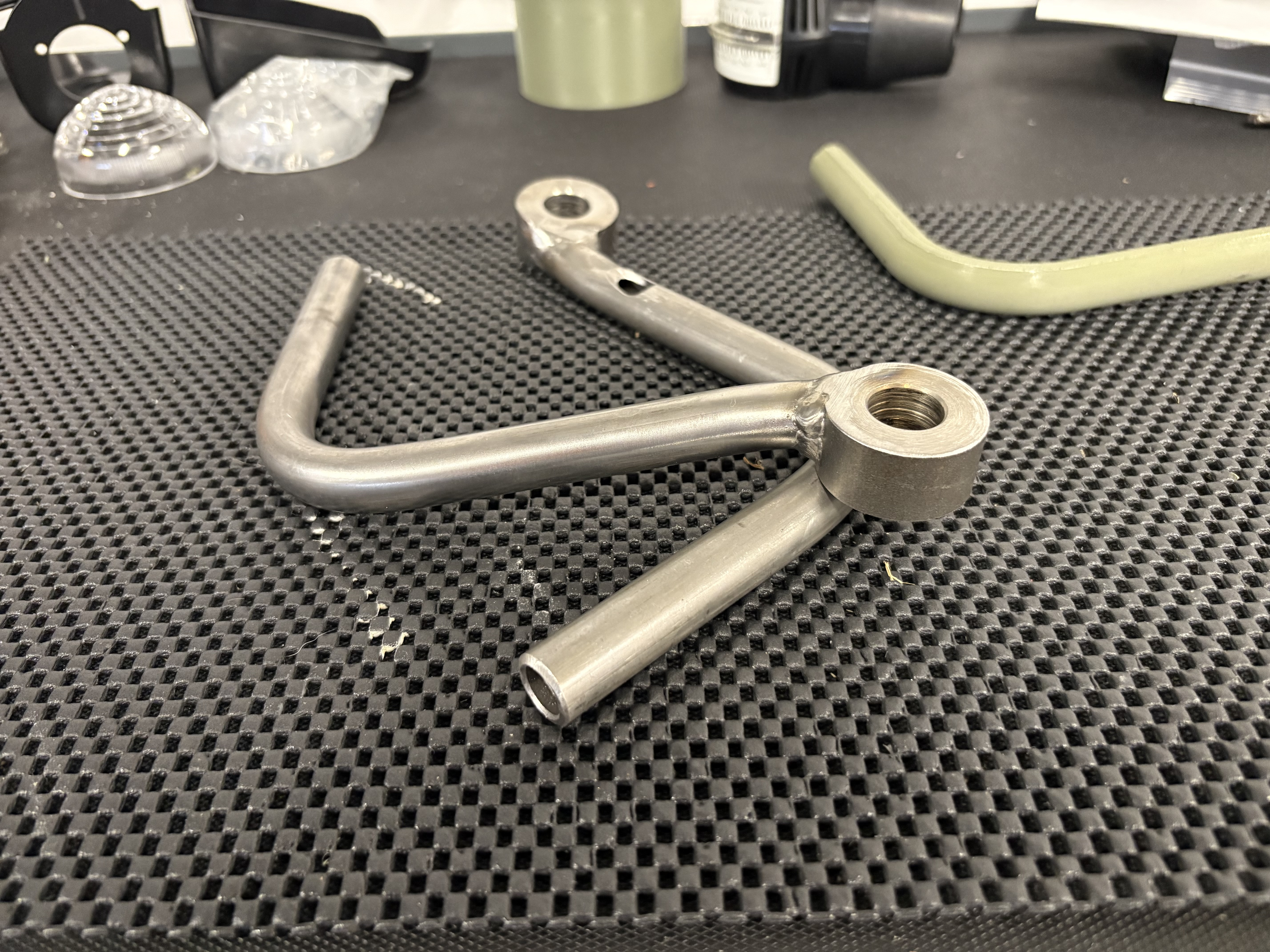

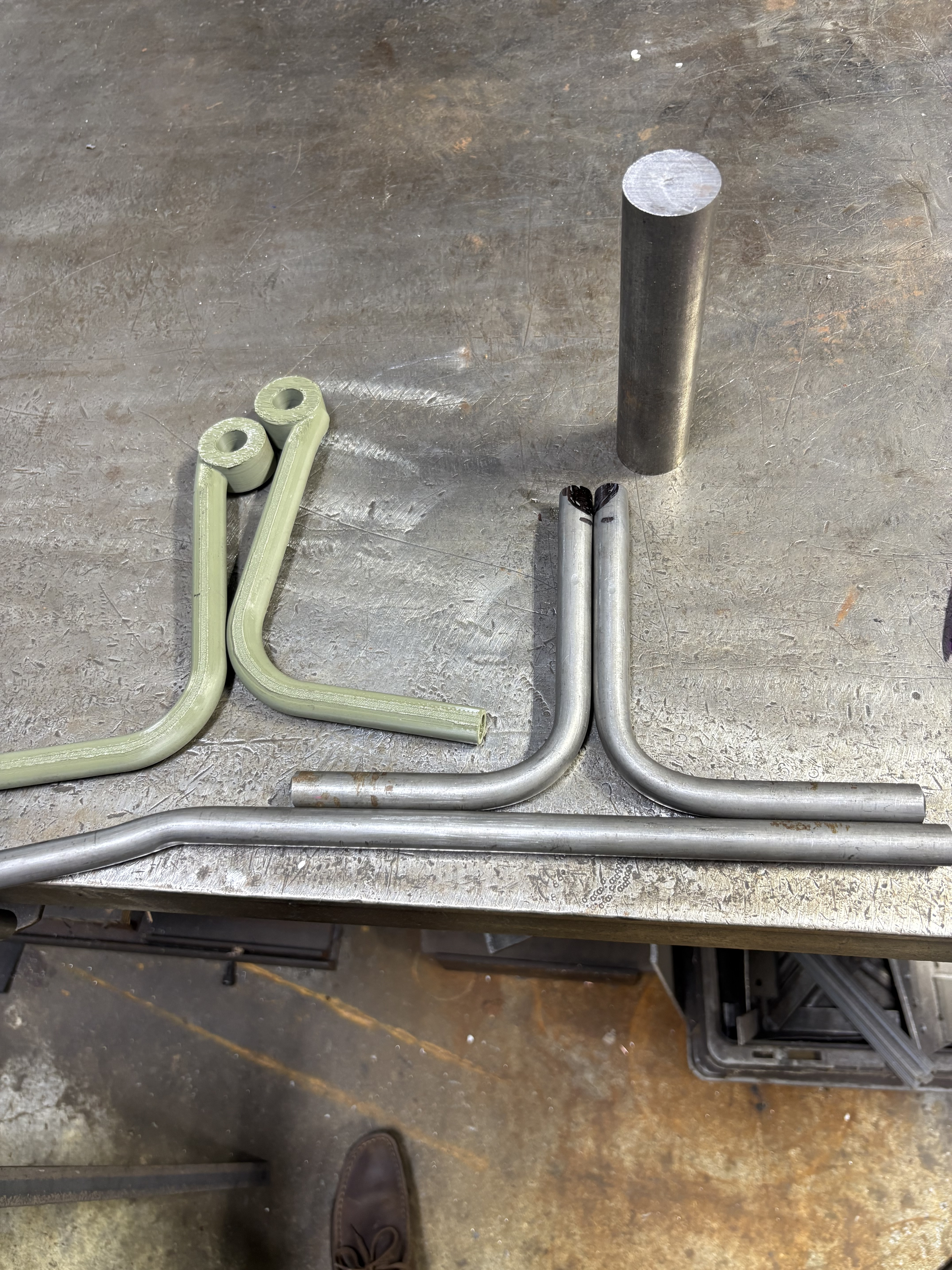

I came up with a design, 3D-printed several prototypes, and tested them for interference. Having a one-off set manufactured was too expensive, so I fabricated them myself. I’m quite happy with how everything turned out. The heavy-wall tubing was also fairly easy to bend using a Harbor Freight bender.
I'll leave a print after the pictures if anyone is interested in making a set.
  PhotoSep012026122335PM.thumb.jpg.79f3b7c08201ce84bb29fadabad02c1d.jpgPhotoSep01202610319PM.thumb.jpg.56c6d35775e320546344fe69e97e5ac7.jpgPhotoSep01202625303PM.thumb.jpg.941872c9ad1094e7a6dcfd2f3093bcad.jpg

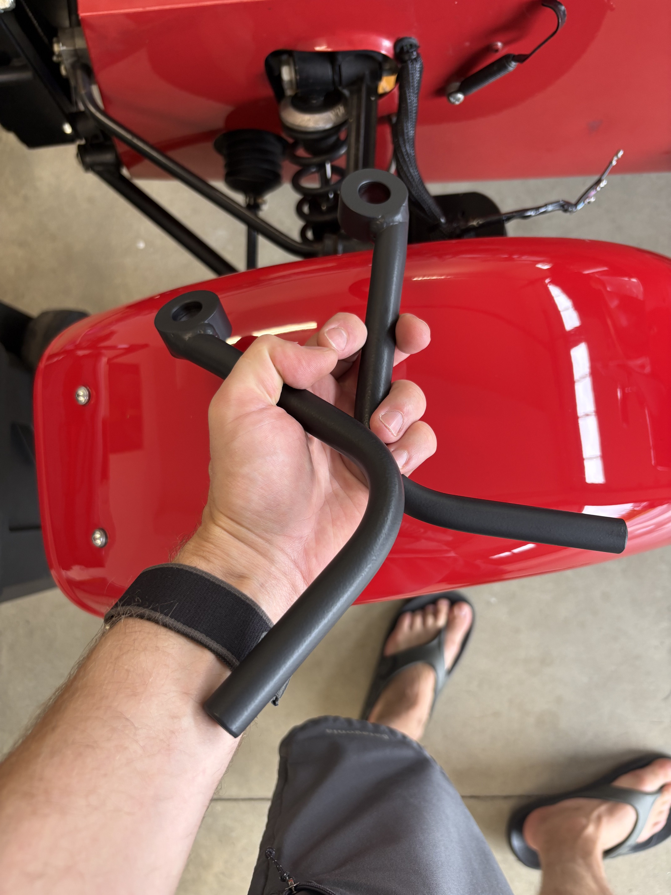

Just got them back from powder coat.
