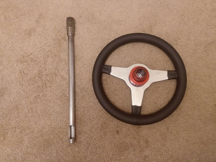

11Budlite Posted September 6 Posted September 6 When I had my S2 chassis, I ended up swapping out the stock fixed steering column for a complete later Caterham steering column assy. That included the upper and lower steering columns and the clamp assy. This added some adjustability to the steering wheel position and a bit of a safety factor as well. You could get the Caterham quick release upper steering column instead of the stock upper column so you could remove the steering wheel. Not cheap though. I bought some 3/4" cromoly tubing and welded the spline section of my quick release to the upper end and machined the lower end to accept the clamp assy. I forget what the wall thickness was but it fit well with the lower column. It could be an option for you.
Timothy Keith-Lucas Posted September 6 Posted September 6 Hmmmm. I cut my "spear aimed at chest" steering shaft in half and then inserted a collapsible section in the middle so that it would at least telescope six inches before it hit me in a head on collision. That allowed adjustment of the overall length, so my steering shaft may be longer than stock.
