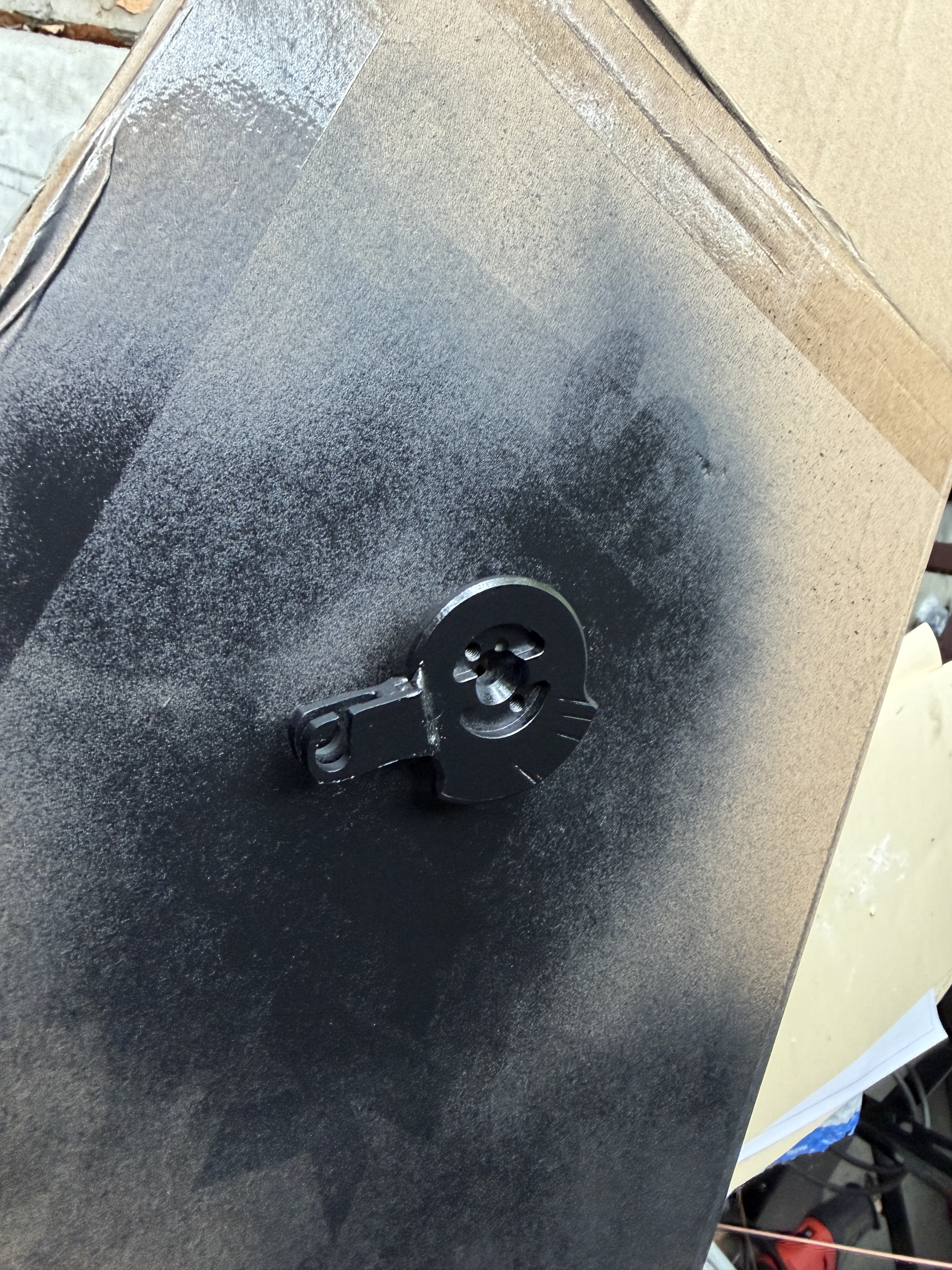

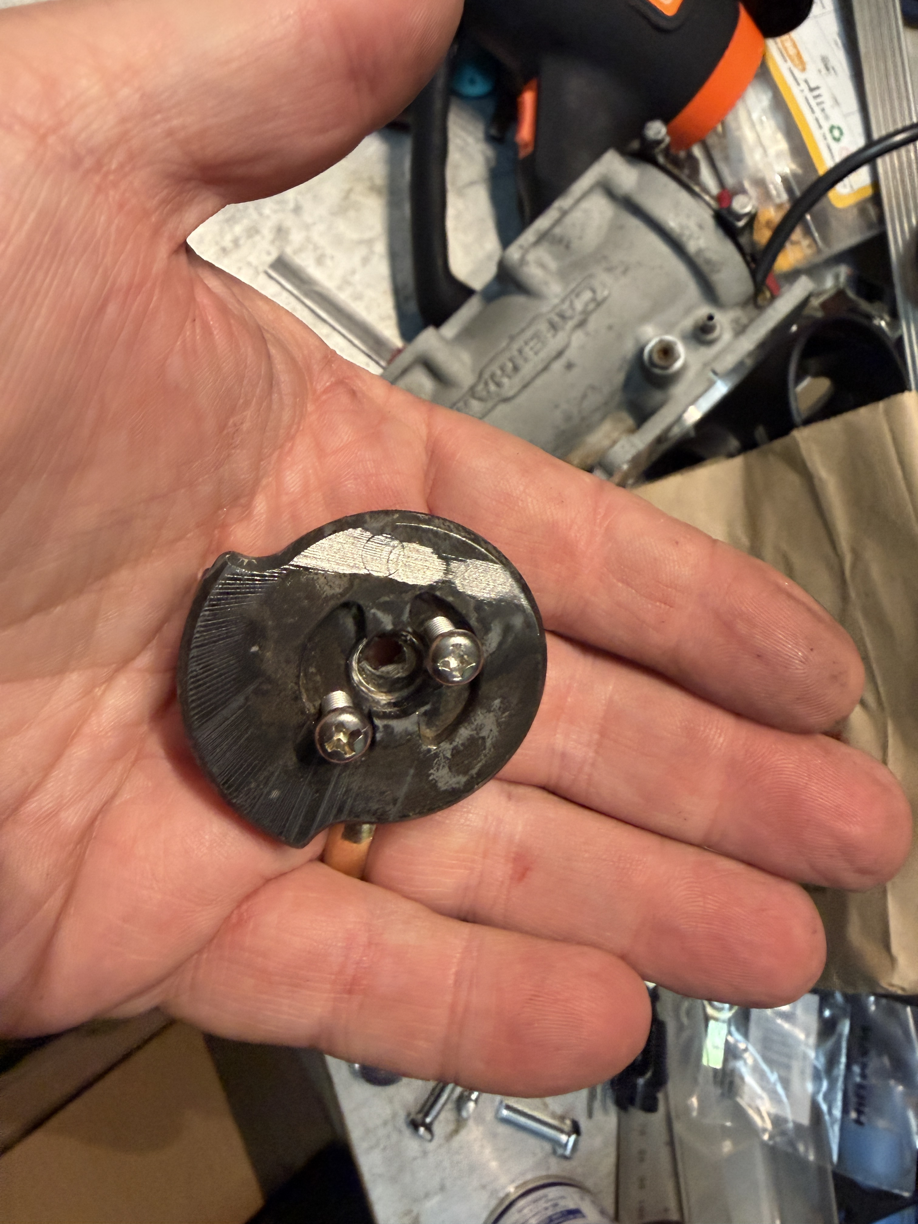

I purchased a set of RBTB's originally made for a 485 with the idea of using them when I installed the Haltech R3 which supports drive by wire.   Now that I have the R400, I decided to see if I could convert them to cable actuation since I have a MBE 9M4 on order.   It helped that I have a spare head, throttle cable and some other bits to work with off the car.
The 485 uses a remote DBW actuator mounted on the side of the engine that uses a short throw to achieve the 90 degree rotation of the barrels.  I had originally considered a bell crank arrangement to get the cable pull ratio right but the extra complexity of adding that below the manifold did not seem worth it after studying the throttle bodies and taking measurements.
I have a tig welder and came up with a solution so I could use the stock throttle cable without alteration and avoid the need for a separate bell crank arrangement.   Initial testing is fine but I need to make sure the return spring is strong enough.
