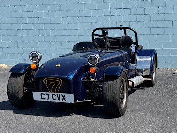

  11. On September 5, 2026, I went to Cars & Coffee in Morrisville with no intention of buying another Caterham. I was a approached by a fellow after he saw me next to my '99 Caterham. He and I started talking about Sevens, and he mentioned that he had a Caterham R400 that he was selling. He had my attention. I had plans for my '99 but I came to learn that the car he had for sale checked all the boxes for me. He showed me photographs of the car and told me the history. It was a genuine Superlight R400 SV with the 210-horsepower 2.0-liter Duratec, Caterham six-speed gearbox, limited-slip differential, wide-track suspension, uprated brakes, carbon dashboard and front wings, cage, race seats, etc. He was the first owner and had built it at the end of 2012. He said he had all the maintenance and purchase records from new. The cage was built off the original track day roll bar by a race shop. After talking more and talking numbers we worked out a deal on the spot. Later that day I sent him a deposit subject to inspection on pickup. After that I listed my '99 for sale. Over the next few weeks I was able to sell my '99 while the seller of the 2012 sent me copies of some of the paperwork and answered my questions as we worked to arrange a pick up date at VIR. The car had led an unusual life. Although completed in December 2012, it had seen very little ordinary road use and was road legal for only about a year. Most of its life was spent in garages/storage at Virginia International Raceway. It came out for track days and an autocross or two. My father shares my interest in cars so he and I left early for VIR from Raleigh on 9/25 to inspect the car and (hopefully) complete the purchase. It was special to have him with me because when I was young he and I went on long trips to collect hot rods and other cars. The car was what I expected and wanted so we closed on the deal and my father and I were back in Raleigh by noon. With the car unloaded I was then off to the DMV for title work and temporary tag followed by an afternoon drive.

  14. Thanks. I'll start a new owner's thread but it's a completely different animal. The 1.8VVC in the 99 is a great engine in a very light car, Ford Type 9 five speed, was RHD, and was running on 13" wheels. The R400 has a Titan LSD, wide track, 6 speed, and probably 50-60 more HP with the 2.0l Duratec and Kent cams. The SV has 15" wheels I have to say right now I prefer the 13" staggered setup on the '99. The clutch on the '99 was progressive and had long throw, the R400 clutch in my car is more like an on/off switch and took some getting used to. The SV is noticeably bigger than the S3. The '99 had a lowered driver's floor. I had never sat in a SV. This one has lowered floors. I don't have the seat all the way back in this car. Seems like much more room for legs and feet and I can probably get away with not wearing driving shoes in the SV. The '99 had a four point harnesses and the R400 has five point harnesses. I bought a regular rollbar from a member here but will likely keep the cage on for now. (I may be doing a track day in October up at VIR.) The cage is not factory Caterham and was built off a track day rollbar by a race shop. I loved the look of my '99. I also really love the look of the livery on the Superlight R400. This has what they called the Lotus anniversary paint scheme on it and it matches the Caterham F1 livery from the 2012-2014 period. It also matches the R600 promotional photos. Scott
  15. Car pickup day for the Superlight R400 SV. Left from Raleigh for Virginia at 6:30am, back in Raleigh by noon. Dropped off trailer and then to DMV to stand in line for thirty minutes for title work and a 10 day tag. Back to the house with the tag and then drove an hour in the countryside. Scott
