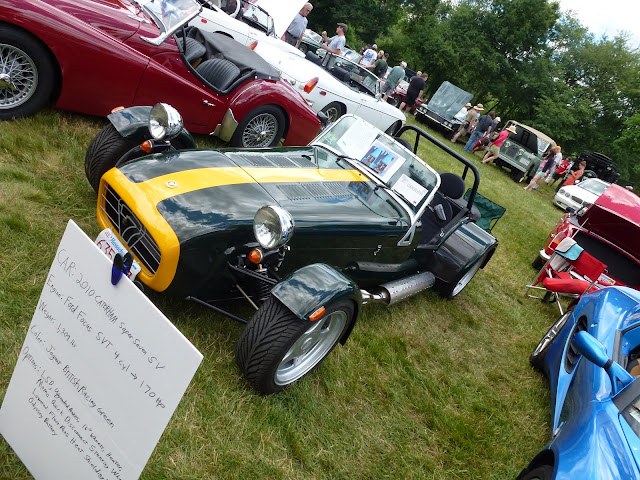

Blokko Posted June 24, 2014 Author Share Posted June 24, 2014 Went to a Brit car day this weekend whilst on a visit to Boston - http://larzanderson.org/events/lawn-events/2014-lawn-event-list/british-car-day/ Good mix of cars - from lowly Mini's up to brand new Rollers. Quite a few Loti at the event - Elise's, Esprit's and also several of the new Evora. Some Series I and II Land Rovers that were in fresh-off-the-Brown's-Lane-production-line condition Very surprised to see 3 TVR Vixen's and a TVR Tasmin (didn't realise that they ever made LHD cars for the US market). Did get to see an MA registered Caterham SV at the event - which just goes to show that it can be done :-) Car belongs to a guy called Warren (who I believe posts on here from time to time). He has a write-up on his car screen that details a 'challenging' registration process! Link to comment Share on other sites More sharing options...
