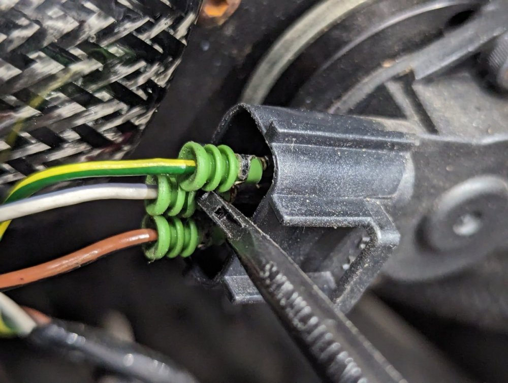

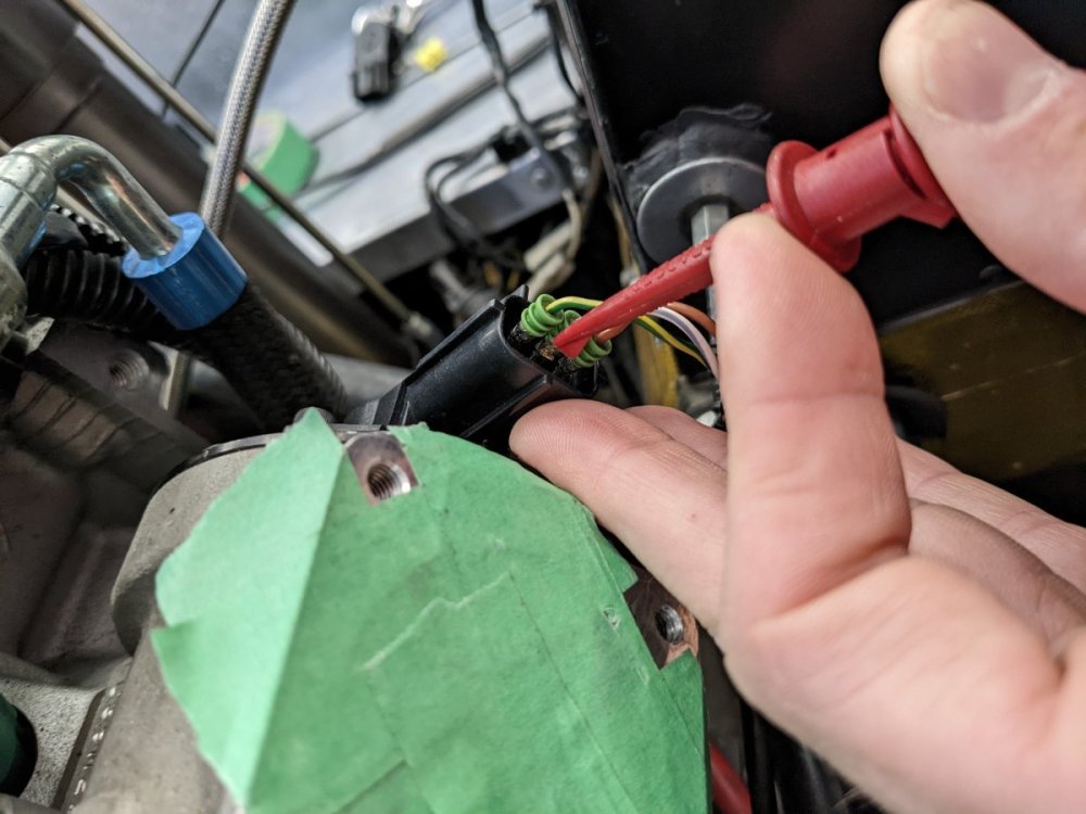

I found the easiest thing to do was to depin the TPS connector and measure between the center signal cable and any chassis ground. Eventually you're going to end up needing an Easimap cable in my opinion. I've attached the setup instructions that Josh at Rocky Mountain Caterham sent me. WRNOT 608 - Roller Barrel Setup Ford Duratec Engine.pdf
