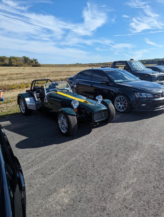

It’s been a few years, but I am on the road for about a month now.  The O2 sensor issue is fixed,  the downstream of cat O2 sensor was wired to the wideband signal.  Had no wideband.  I bought the correct sensor and wired it in.  Seemingly had a fuel pressure issue as well.  The car was built with a carb regulator I found.  Changed that out and jacked up pressure.  That made all the difference in the world.  Added datalink port so we can read on computer and we are down to 3 codes about the evap system I don’t have.  Picture was first ride with my son where we drove about 20 miles, never more than about a mile from the house as the crow flies.  We blasted up around Saratoga lake the other day with no issues, so confidence is growing.

Double check your picture embedding, shows up as a black picture for me?
Maybe we can meet up for a coffee somewhere or one of the car and coffee events. The Scotia airport one should be right by you?
