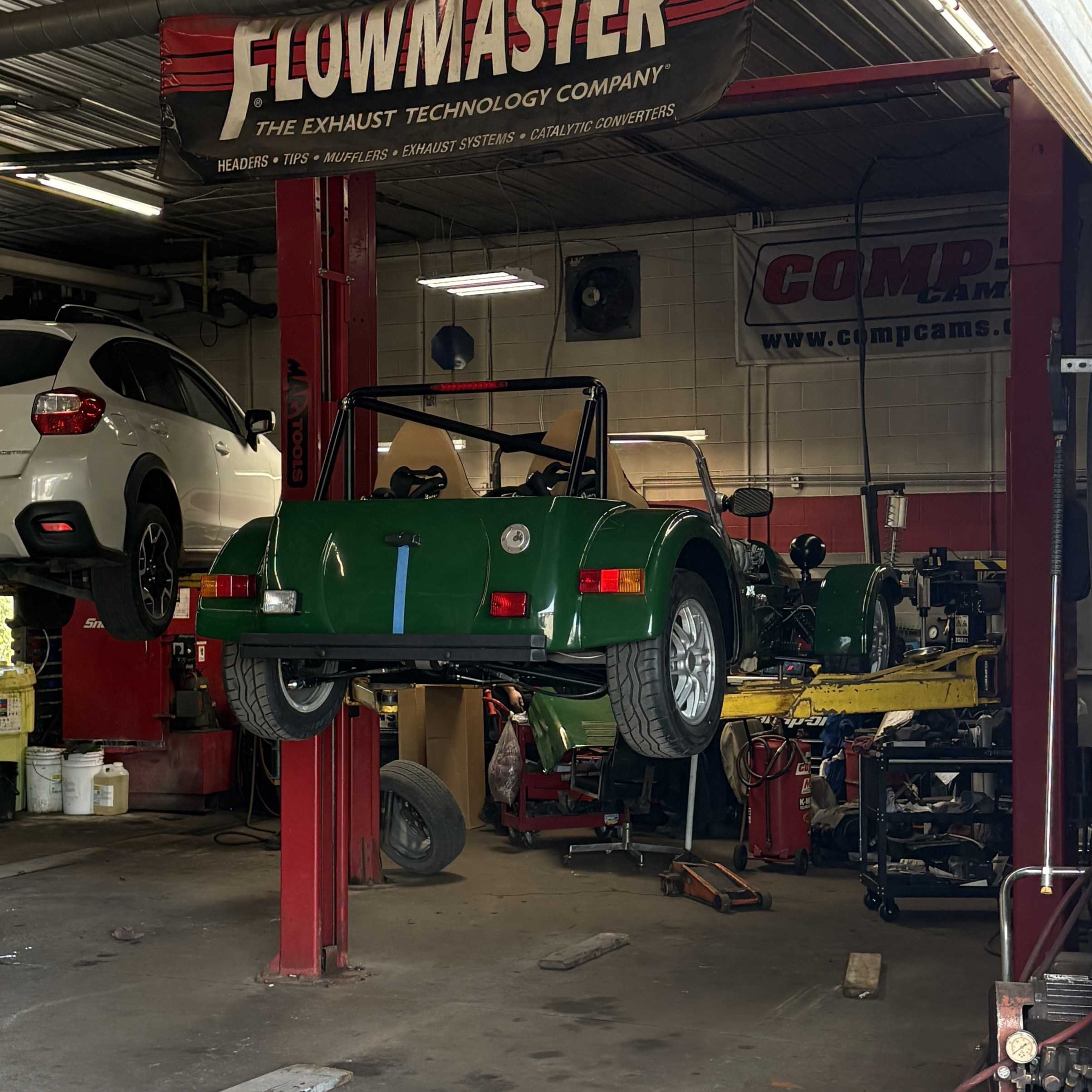

It was a weird feeling that the first person ever to get the car into third gear on the road was the tester, but I was happy to get the ball rolling!  BTW the sun visor didn't move an inch!! 😁

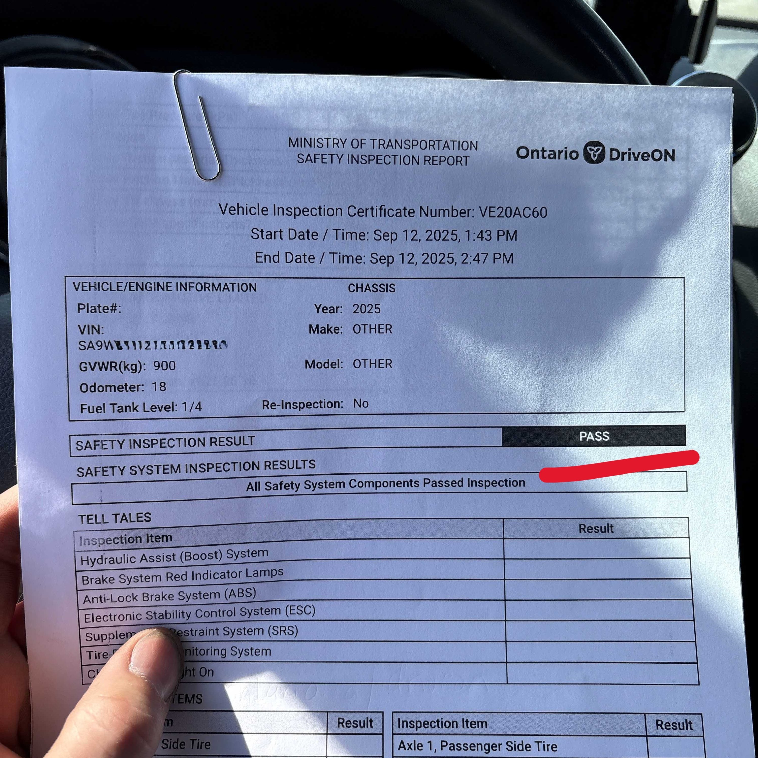

I sat outside on a camping chair for about 1.5 hours while they went through the online session.  It was a gorgeous Friday afternoon, no work, just the sound of tinkering in the garage and dozing off in the sun.  Eventually the technician told me everything was complete and he was just awaiting the final results from the the ministry.....PASSED!!!
For those of you that have been through this, can understand the relief after so much time, blood, sweat and cursing was insane! Awesome!!

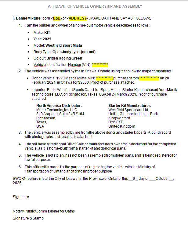

1. Affidavit of Vehicle Ownership and Assembly (Notarized)
2. Starter Kit Order details
3. Import approval and customs clearance paperwork
4. Bill of Sale for the Starter kit, donor car and any other major components purchased.
5. Ownership paperwork for the donor vehicle
6. Safety Inspection Certificate
7. Selection of build photos (Including VIN Plate)
Here's what my Affidavit looked like.
Once my pack was together I booked an appointment to go and register at Service Ontario, to my surprise the earliest appointment I could find 30th October!!! Still, I figured I wouldn't be driving it this fall and knew that the Safety was valid for a while so I didn't think anymore about it.  That is until my parents in the UK started asking questions that started to put doubt in my mind. To put my mind at ease, I went back on the Ministry site....
